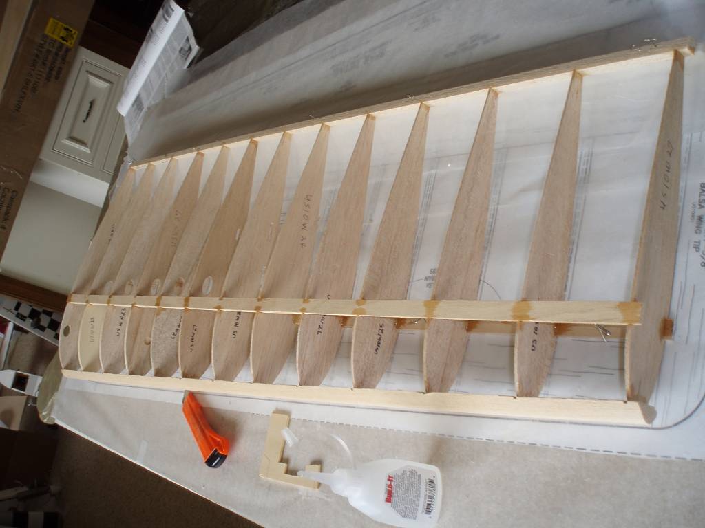

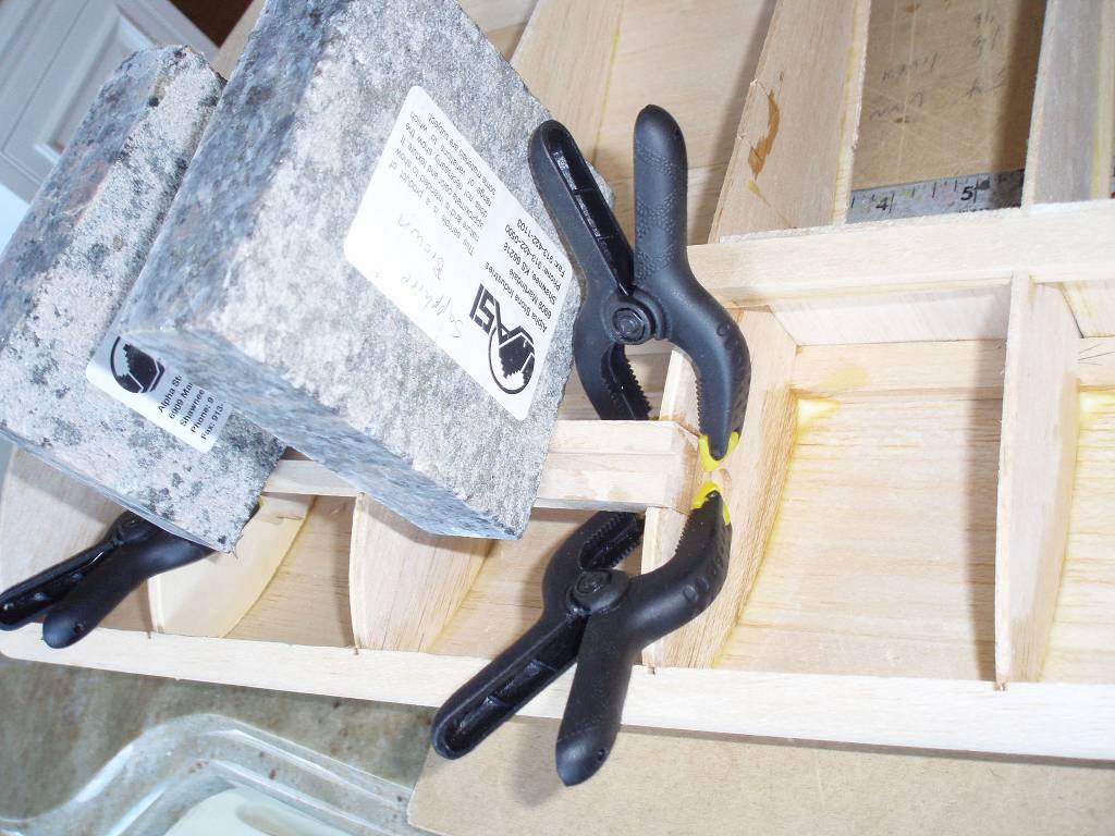

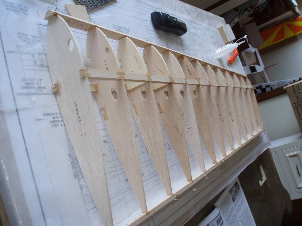

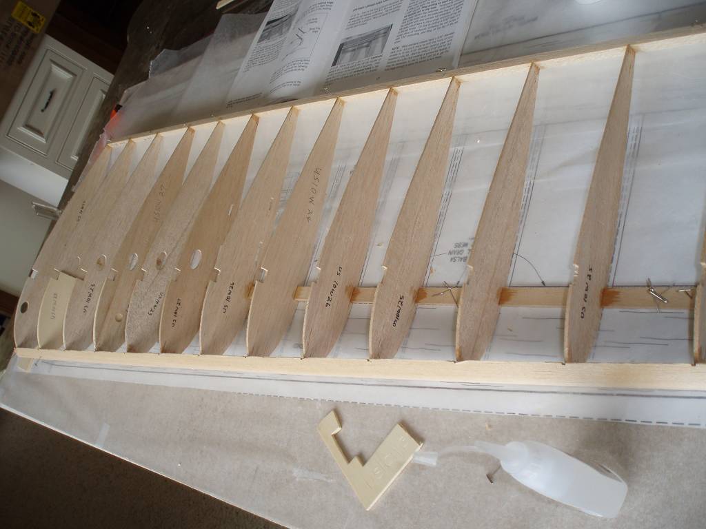

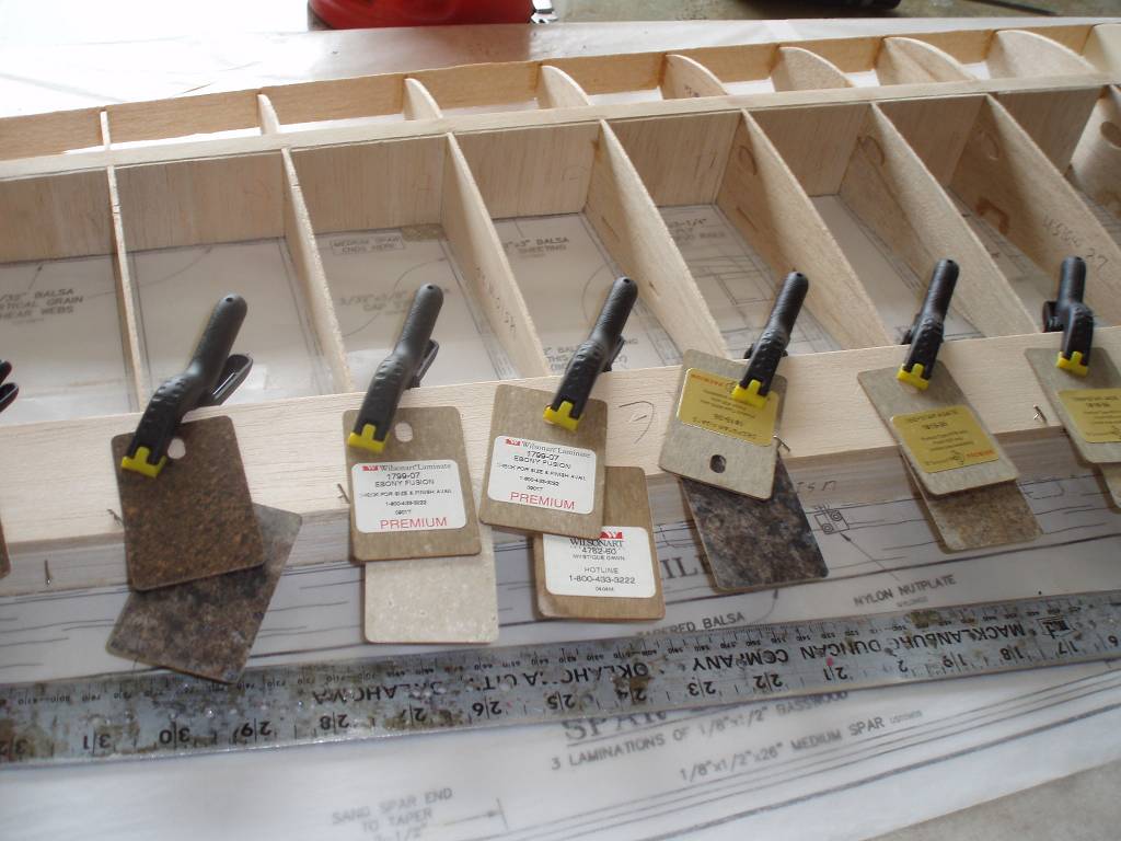

Hello everyone.I must say I love rcu. Am 57 years old and just last april flew my first rc plane. It has been a passion of mine since childhood but when you own your own business it was not in the stars until now. My first flight was with a alpha trainer and then i bought some OLD planes that i had to install engines and electronics and have flown most of them. Having a blast.
Recently I bought a US 1000 kit on ebay for $123, and will try my first build.
Thought I would post some pics as I go.
OOps Last pic I got ahead of myself
Wayne

If it's not too late, make some new ply doublers for the rib fronts and move the retracts out by one rib bay. (Between ribs 4 & 5 instead of 3 & 4)
This is a great airplane. I've never built the 1000, but I have built 5 or 6 of the 40 and 60-size
You might want to consider Flaps too!
Do a search for Ultra Sport and you'll find lots of great tip about this plane!

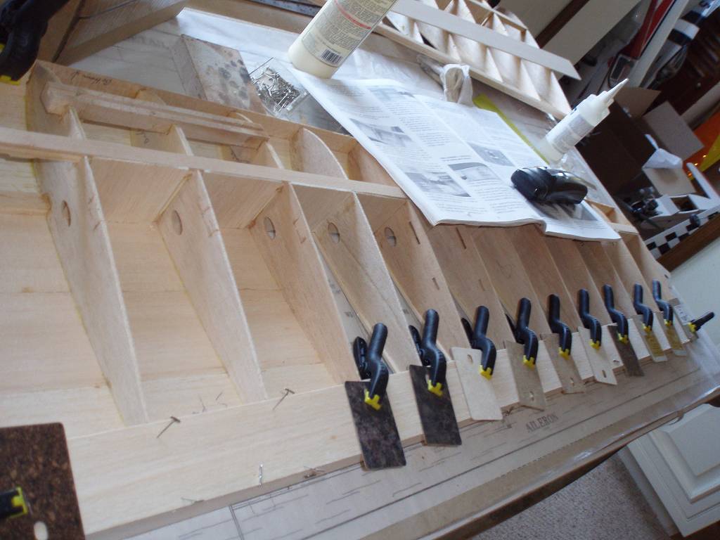

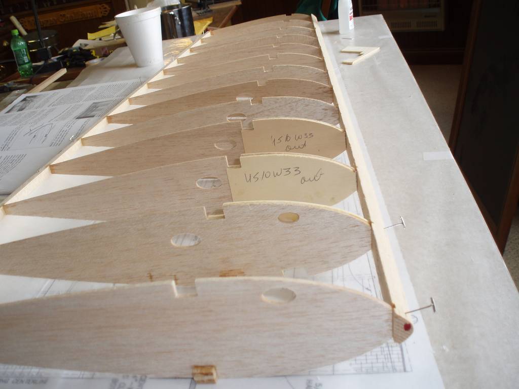

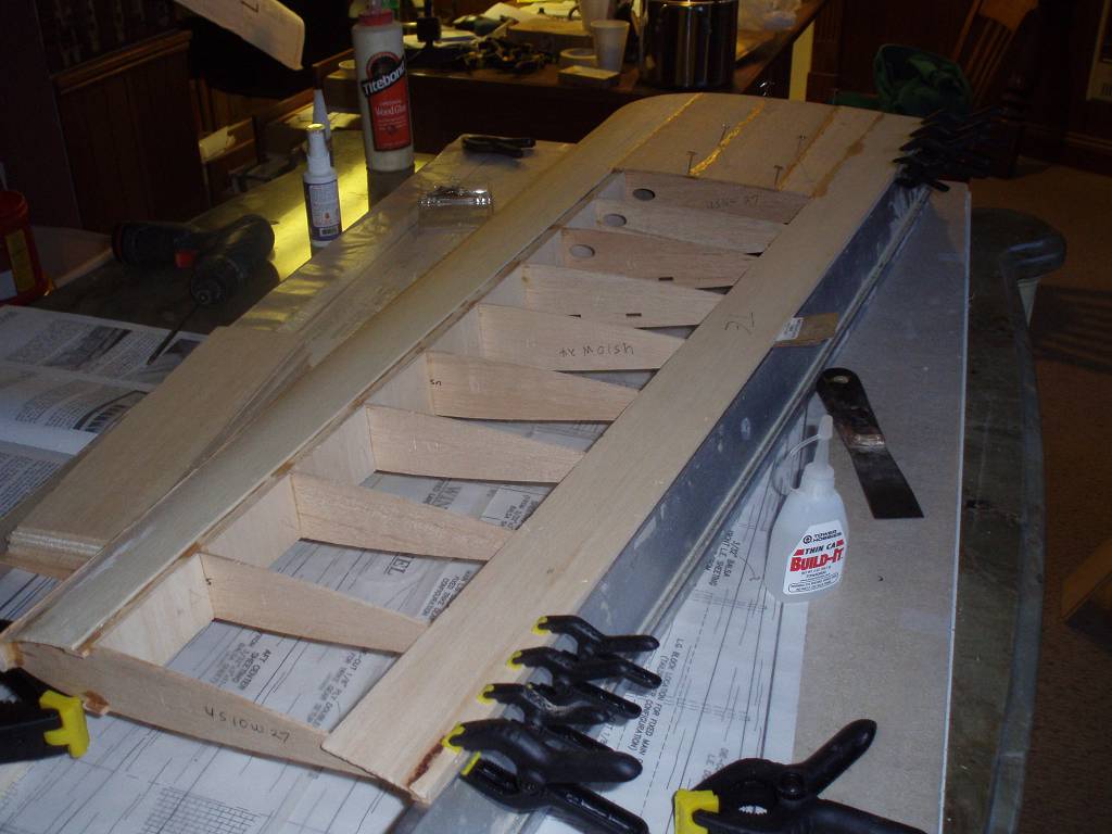

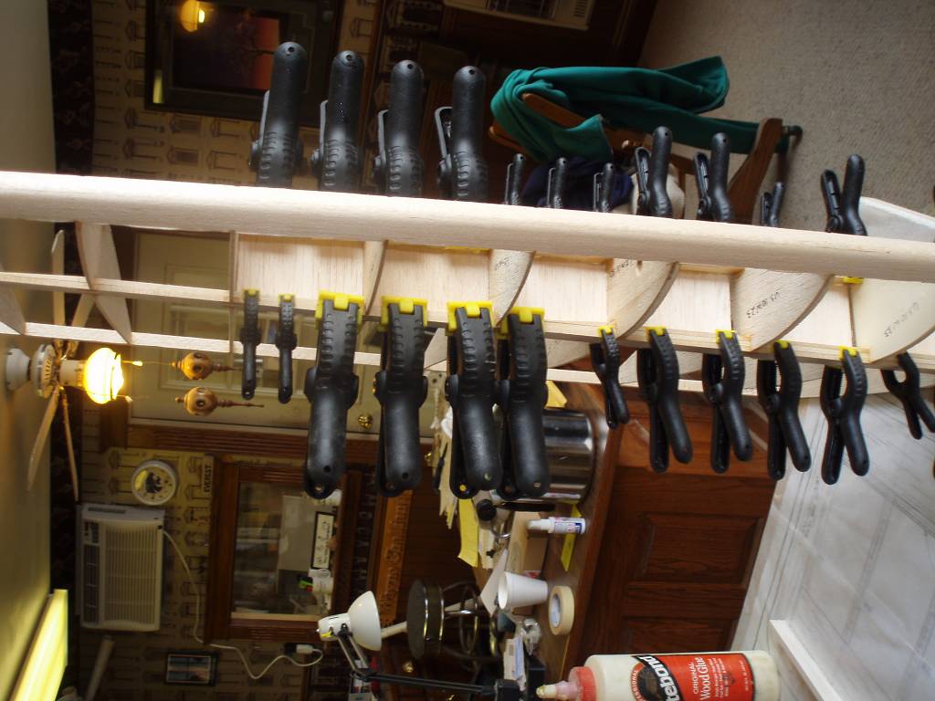

This is gluing the web in and the sheeting on the TE and LE . More Pics to come .
By the way, I won"t be using retract. I wish I could but too pricy for my wife. It will be a tail dragger though.
Wayne

So far pics are of left wing. I screwed up and didn't get the bottom spar pinned dow tight and it came loose (ANd I didn't know) and rack the wing by about 1/8 inch. So I repinned it all down before the sheeting and it came out fine. Wing is straight now. Right wing pic to come.
Wayne

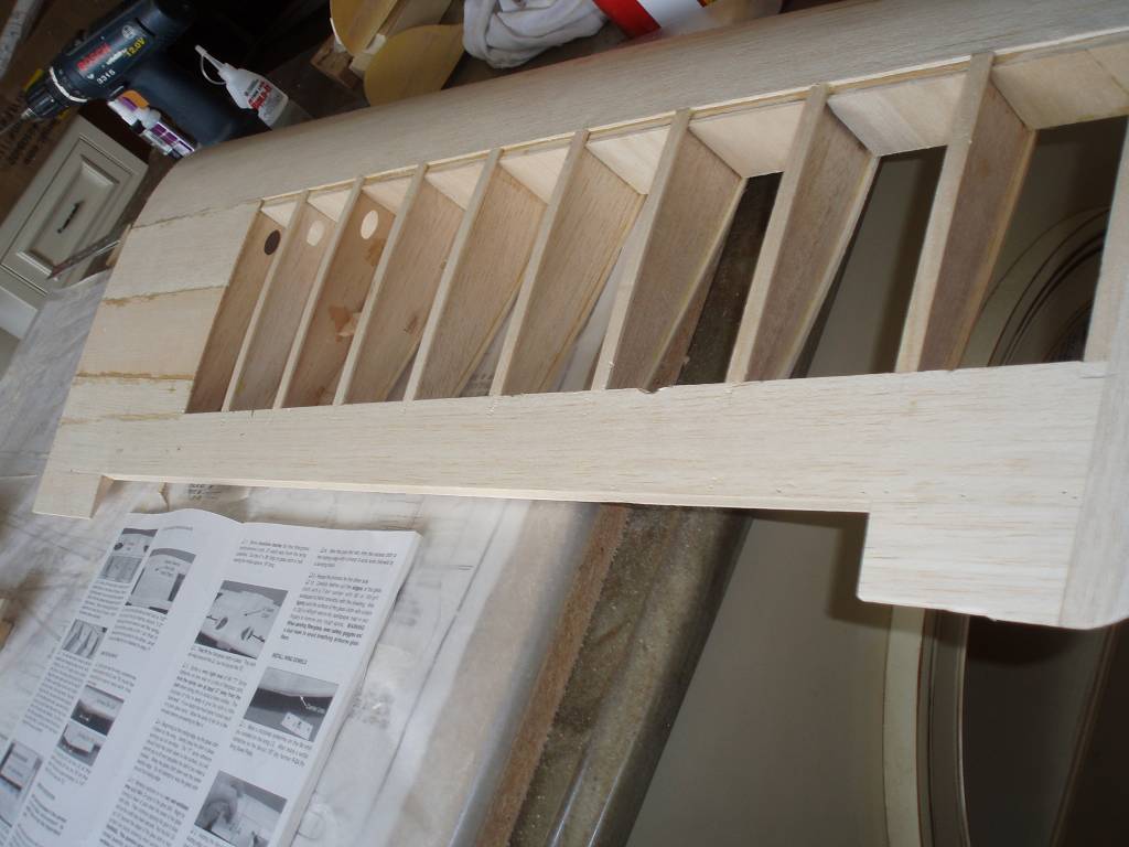

Right Wing went better. I am still learning but it is fun.
Wayne

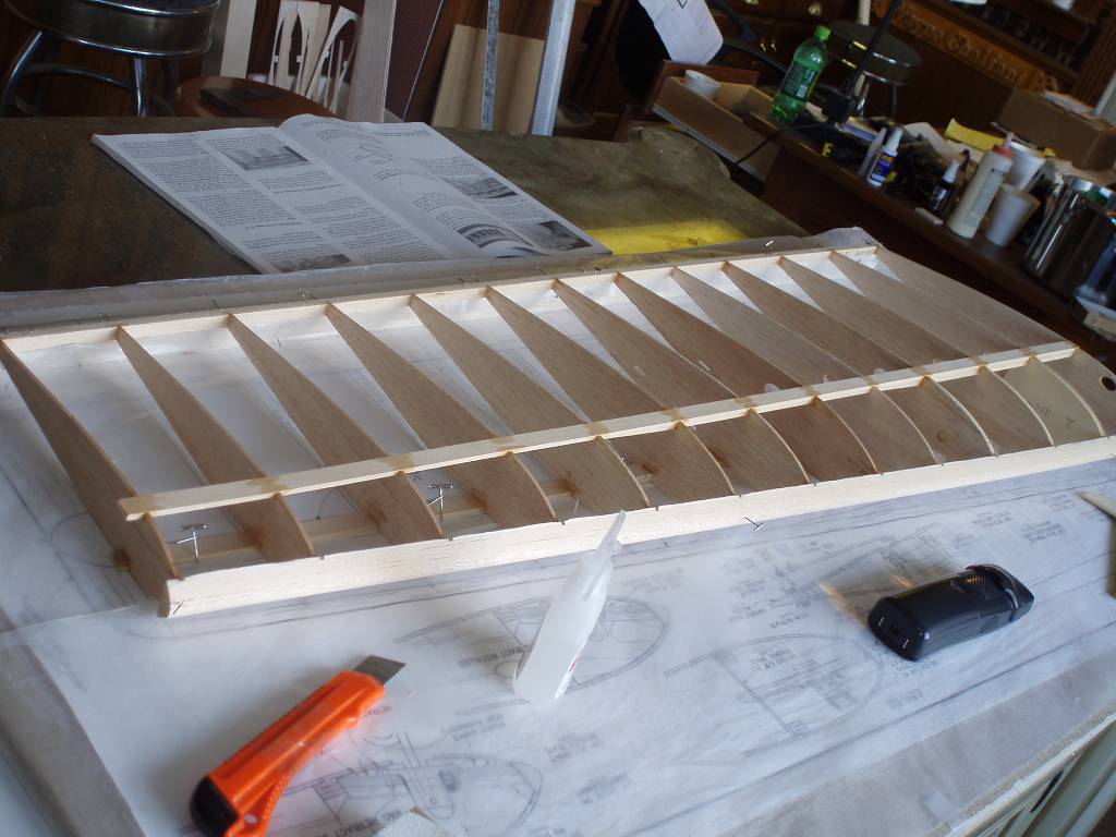

I have already cut the aileron and glued the end pieces to the wing TE. Is it too late to add flaps?
Wayne

Not too late. cut them about 1/3 of the remaining strip

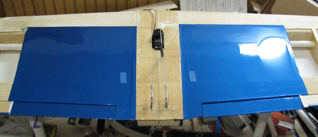

ORIGINAL: everwood
Sounds like good advise. Will I need to use two servos on regular flaps, or can I use just one? If one, what is best way to link flaps together on this plane?

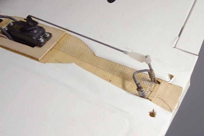

One servo will run both flaps..
Then two additional servos, 1 per wing, will run the ailerons.
This is my flap setup on my US60..

That's one way, here is another
