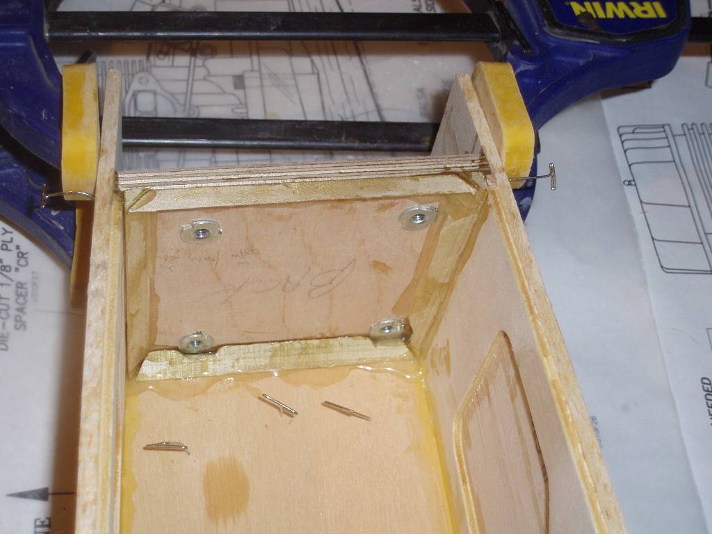

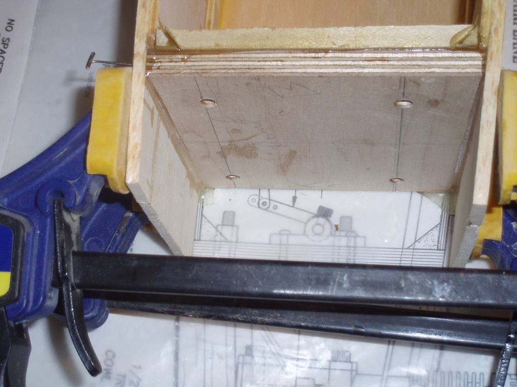

I picked up some 30 minute to glue in the wing hold down plate anf the firewall. After sanding on the wing hold down plate it seemed to fit good. I didn't like the very soft balsa triangles that was in the kit, so I made some with poplar for under the wing hold down and behind the firewall.
I also like the idea in the instruction book to put a antenna guide tube in the bottom of the fuse, so I drilled 3/16 holes and slid in a tube for that. Hope it is not in the way of anything important.
I think I am ready to sheet the bottom of fuse now.
Wayne
