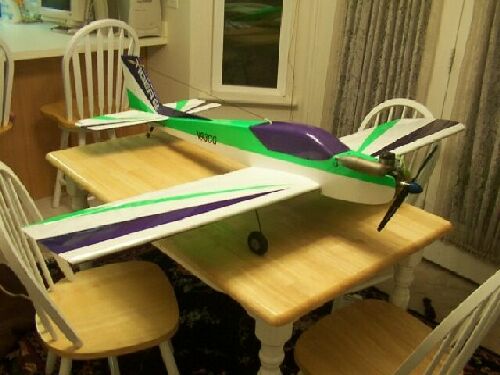

The first plane I ever built was the tiger 2 as a tail dragger and it is no problem at all. I did not install the rails in the wing for the tricycle gear. I just added 1/4 ply landing gear block on the inside of the 1/8 ply in front of the wing. I used the klett composit gear but the dubro is the same thing and it is easier to find and cost alot less. I also used a sulivan tail wheel which made installing the tailwheel a breeze. Some people warned me that if I put the gear in front of the wing like I did that the plane would have a tendency to ground loop. Well they were wrong it was a dream on the ground. Here are some picks.
By the way what a geat flying plane.

If you haven't built the wing yet, then making it a taildragger is really simple. I just built the wing as per the plans, but put the landing gear blocks in front of the spars instead of behind, and reversed them so that the gear is now angled forward instead of backwards. I used a very cheap Du-Bro tailwheel assembly, and created a "wedge" to mount it on so that it rotates at the same angle as the rudder. It worked out flawlessly, and ground handling is superb! Shoot me an e-mail if you have any questions or need better pics of the mods. You can also check out my web page for a more detailed review of the plane.

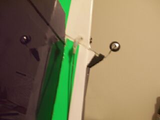

Here is a pic of the tailwheel. I built the "wedge" it is mounted on out of light ply and balsa. Its purpose is to angle the tailwheel so that it pivots on a 90 degree angle to the hinge line of the rudder. I did this to avoid any binding issues it may have caused otherwise.

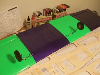

This picture isnt much help, but it shows how I did the main gear. I mounted the blocks and rails in front of the spar, rather than behind, and angled them forward instead of backwards. Without too much work, it placed the gear right at the leading edge of the wing. I recessed the gear rails 1/16" and then sheeted over the whole assembly, as the gear mount area now falls under the forward sheeting. It was really quite easy, and the result is the easiest graund handling taildragger I have. If this doesn't help, or you need more detailed explanations, dont hesitate to ask.
One more note: If you are building the kit, DO NOT use the torque rods and one servo to drive the ailerons. This is the one weak point of this plane. The resulting flutter was nearly the early demise of my Tiger 2.
