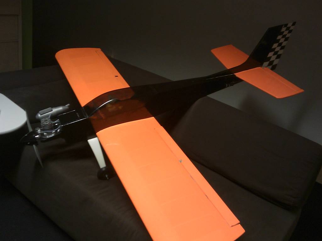

I just finished a Tiger 60 build, and included a taildragger modification.
I used a Du-Bro fibreglass undercarridge, and and axles - it looks good and is strong! I used a plywood plate just ahead of the wing, with 4
blind nuts to hold it all together.
I fly off of grass, so no tailwheel was used, and I have never had trouble steering on the ground.

Hey Stevenmax50 - I posted some pictures of the finished plane on the recent "Tiger 60 Build" thread, under kit building - It is covered, with a black fuselage and orange wings, but I can't think up a nice trim scheme. []
Suggestions welcome!

I think my camera washed out the orange...

Ya I remember now.  I think the orange looks cool.  Kinda creamy.
