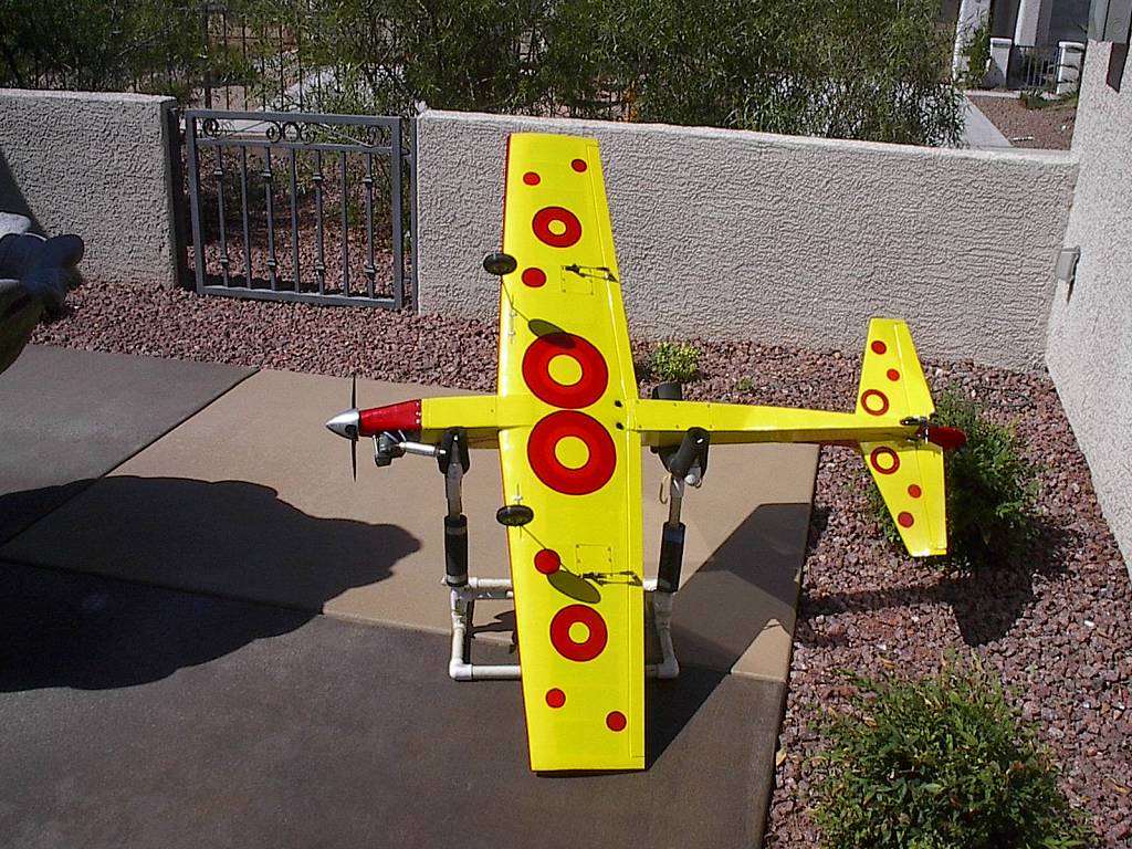

I put the frame on before I cover usually. This is how I did my Kaos.

Thank you, I'm color blind but see yellow and anything contrasting pretty well. Most of the guys decided the bottom pattern worked out even better then the top. I just broke away from my normal stripes and came up with this, you can see it a lot better then stripes. I lost this plane a few months ago and I'm just starting the build for it's replacement. Another Bridi design.
