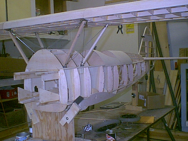

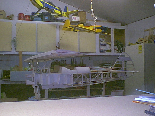

I have a 1/3 scale Stearman 116" ws. built off Balsa USA plans.
I have the wings, fusalage and empennage ( tail sections ) all built
and I'm about to make the final mount on the wings and flying wires.
I have other bipe's but none this large and hope some who have this or
other large biplanes could share some information.
The plans call for du-bro 1/4 scale forks on the ends of solid
music wire for the flying wires. These have a bolt that slips through
one side and the wire bracket and thread into the other side, to trust
this setup I would extend the bolt and add a ny-lock nut, to much tedious
set up and take down at the field. I've searched but have not found
much for a substitute.
I sure would appreciate any information from those that have built
this aircraft or other large bipe's on how you did your wires and
I have built spring loaded functional landing gear that I can adjust
the initial load on the springs. The plane will come in 45-50 pounds
and I was thinking of setting them around 30 pounds on each side good
or bad?
Last question. In my searching I found many had a 150cc for power and
I have a 3w150. I also have a 3w106 but wish I had a 120cc
I found most had to add 4 to 8 pounds to the nose to balance soooo...
of the the 150 and 106 what would be the choice?
I'm not trying to have a 3D aircraft (of course it's not) but don't want to be under powered
either. The 150 is 2 pounds heavier(help on nose weight) but a little marginal on
prop clearence, will the 106 have a little power to spare?
Thanks ahead of time for any help. Hope I post this right I don't post very
often.
Best Ron

Ron,
I've had two of these over the years. Great airplanes. First one was initially powered by a Quadra 100. Wondered if it would have enough power, it was fine for scale-like flight. I say scale-like because even a Q100 is waaay overpower in HP/# compared to full scale .. but it would just barely loop from level flight. As far as I know you can't even come close to a loop from level flight with the full-scale .. unless it's got the 450 HP motor on it! Other than that, it flew well. I eventually replaced the Q-100 with a 3W-150, and it was a lot more fun.
Second one started with a 3W-120 which was more than enough power, eventually replaced with a RCS-250 radial, in my opinion the best motor for this plane.
If you want to use the 106, I would not worry about it. I have one on a 1/3 scale Pitts and it is a really powerful motor, much more so than the Q-100. Depends on how you want to fly.
Both were done with flying wires employing the standard Dubro ends, with 4-40 socket head screws and no locknuts. Remember unless you have a semi-trailer for transport you will be removing a lot of flying wires every time you fly. It takes a long time! The locknuts really are not needed.
What is required for this airplane is some innovation in how to assemble the flying wires to allow faster assembly at the field. Some of the Waco brotherhood guys are doing interesting things with keyhole slots and bike spokes (see RCU ID Stickbuilder), others have been using sister clips, if you have ideas here, it would be excellent.
On one of my two Stearmans, I left the top and bottom wings attached all the time and built a plywood spacer to hold the wing roots in correct orientation while off the plane, and then only had a few flying wires to attach .. but it did eat a lot of space in the trailer for the wing assemblies.
I am a little surprised about the nose weight .. neither of the ones I had took any nose weight. Did you put all the servos in the tail?
The stock gear can be a little fragile for the higher weights, mine were both over 50# and you have to land it really gently to avoid gear damage. A lot of guys use the replacement gear built by Darrell at Sierra Precision, so I am sure you will be happy with your custom gear.
Good luck with your Stearman, let us know what you come up with on flying wires.
Dave
Dave

Hello Dave
Thanks for the reply. I purchased the 150 when I was just getting started on the build.
I wish I had purchased a 120, I've been watching the engine ads for a possible trade we'll
see but not to far from mounting time though. Wish I had the funds for the radial but I don't.
I'm just a sport flyer but do like to get with it a little so I will probably go with the
150 unless a trade comes up.
So you had no problem with the Du-bro ends and the bolts backing out good to hear. I was thinking
of going cable instead of solid wire and leave them attached and rolled up at the fuselage end.
I read in the scalebuiders forum where a 1/3 Pup and one other lost a wing to they say wire stretch
and talked to Dave at BUSA who also mentioned wire stretch so going the solid wire for sure and
looks like the Du-bro ends being you had no problem. Dave at BUSA suggested maybe using the the Du-bro Kwik
clip clevis with the pin, ordered some got them today. I'm not sure on these the pin diameter looks a
little small.
I really like your idea of building a crutch at the root ribs and leaving the "N" struts and wires attached.
I think I already have a good idea how to do that. Thanks for the idea. I'll check out stickbuilder for
other info.
As far as the nose weight I found that in searches I did, one had 8 pounds don't remember what engine.
BUSA had 4 pounds but with a smaller engine. I'm just now starting to mount the wings and wires so don't know
on mine nice to hear you did not have this problem.
Mine is a scratch build off BUSA plans, I don't have the tail wh.,fin etc fairings so those will be framed
up plus I always seem to find a place to add an extra brace or something you know how that goes.
I also fabric cover all my planes and probably add some more there.
I looked at the Sierra gear but it was $320.00 so I opted to build my own, they turned out pretty good. What tires
did you use Dave? I found some good looking 8" ones at AMR $85.00 each do you know of another source for tubed tires?
I want to thank you for taking the time to share all this info Dave hope to hear back from you.
Best Ron
little small.
other info.
