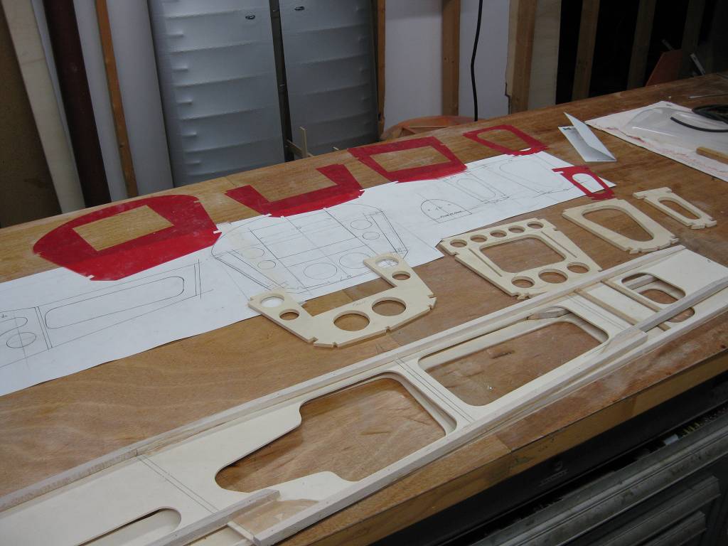

Here's the start, today I cut out both fuselage sides and added balsa sticks. The original had 1/4 spruce, I'm using 3/8" balsa. I selected hard sticks for front and light sticks for the back. The sides are 1/8" lite ply.

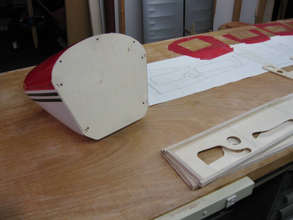

Today I reduced the fuselage into descrete pieces and began to make templates. The original design was 1/4" lite ply, I plan to substitue 1/8" aircraft ply for the engine box and 1/8" lite ply and other areas. I do plan to use 1/4" lite ply on several formers however for gluing purposes. From my measurements 1/8" aircraft Ply and 1/4" lite ply weight the same. Likewise 1/16" ply and 1/8 lite ply are the same weight.
ID:	1399009   Click image for larger version

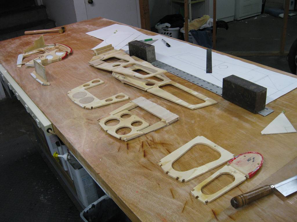

The drawings I made were crude, I then transfered the shapes to See Template then to the stock. I will save the templates just in case I need to do this again.
I learned some things by disecting the plane. I was truely amazed at weight gain due to a previous repairs resulting from another dead stick landing in the high grass. I used 1/2"x5/8" maple blocks on each side engine box when I originaly assembled the plane, again these guys were heavy. I need to come up with a different approach.

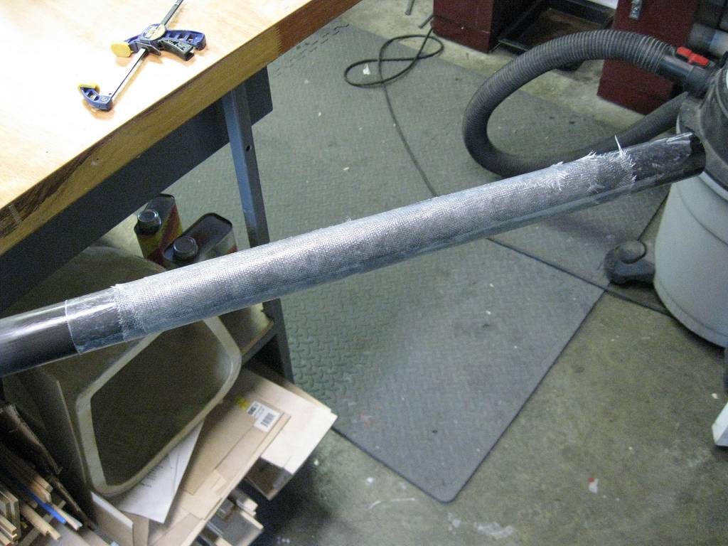

Miller Lite washes down the balsa dust. On to the wing tube.
The materials, one tube for the form, Vasoline (poor man's release agent), wax paper cut to about 1 and 1/2 wraps (Provides about 3 mils clearance), sufficient glass cloth for two wraps( it's 6 oz., I buy it at the auto parts store), one shot of West System epoxy.
Old 03-17-2010 | 04:17 PM
Posts: 1,912
Received 57 Likes on 55 Posts
From: Springdale, PA
Default RE: One Design Build
I grease the tube with a Lite coat of Vasoline then wrap the wax paper around the tube. Be sure to prevent bubbles and wrinkles.
The glass cloth is pre-wetted on a piece of waxpaper.

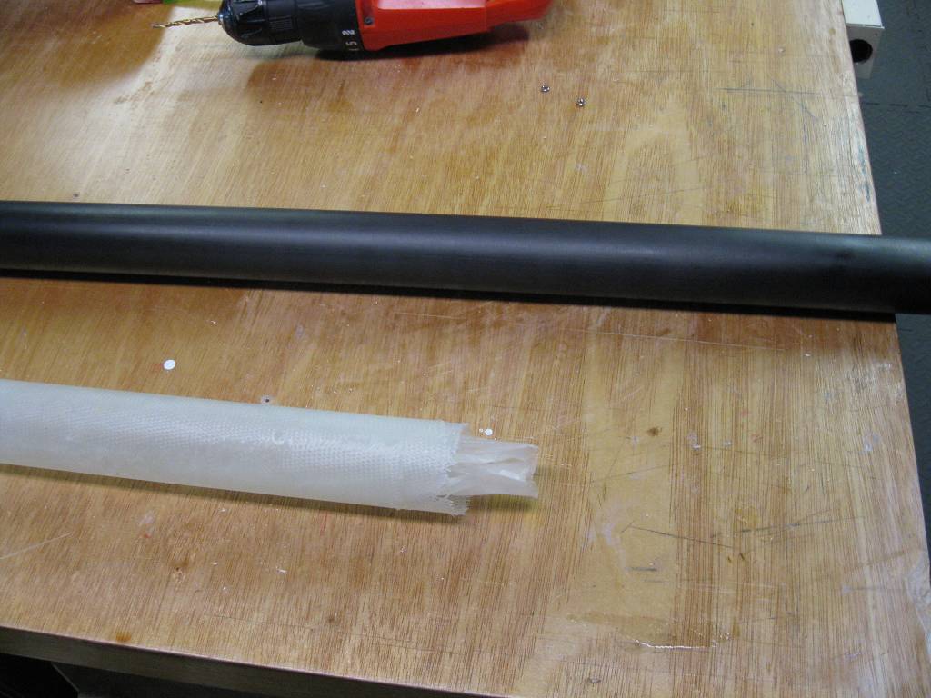

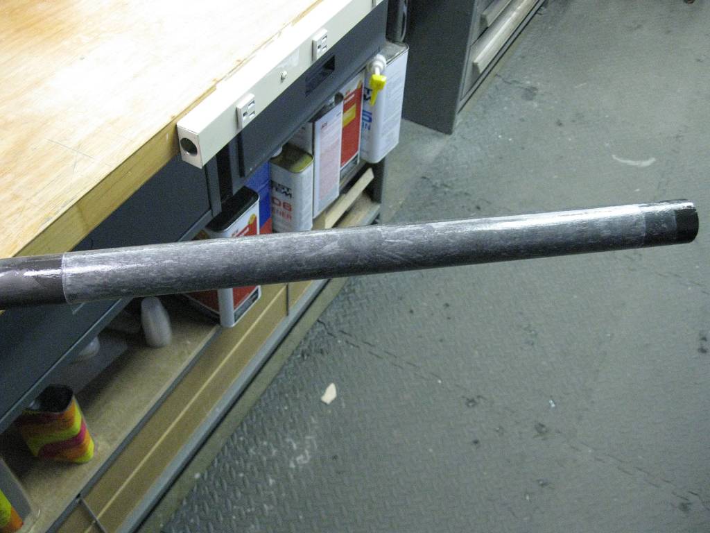

Then wrapped around the tube.
The next day I remove the tube and clean up the Vasoline mess, the Vasoline smell reminds me of when the kids were in diapers. Then clean all the wax paper out of tube. I measured the carbon fiber tube afterwards, the tube measured out at 1.488", a piece of aluminum tube was 1.502", expands why the carbon fiber tubes are rather loose in pheonlic sockets?

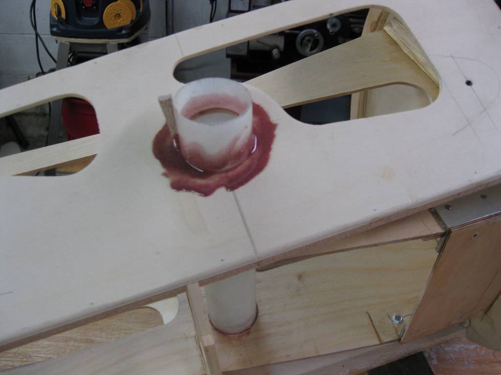

I dry fit the engine box and front former together and screwed the former on with #2 screws. I'm using the old cowl that was fit to original plane, therefore I must fit the front former to the original cowl. I mounted the cowl to the former with 6-32 nut spacers under each screw, the gave the new former the same shape. I glued all the engine box parts with epoxy

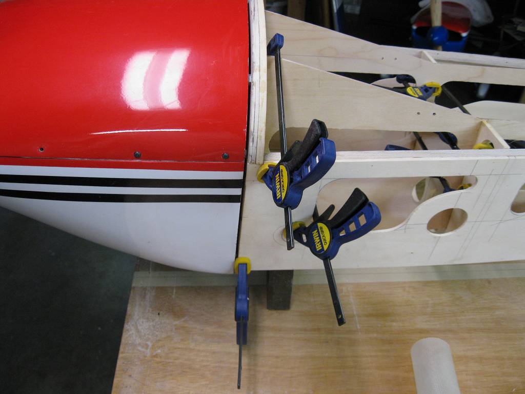

I used every mini clamp I own on the engine box. I guess I need more? I haven't found a really cheap place to buy the Irwin clamps, they work the best. The Harbor Frieght clamps just make me mad.

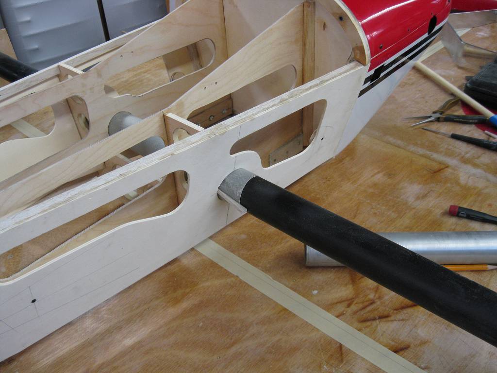

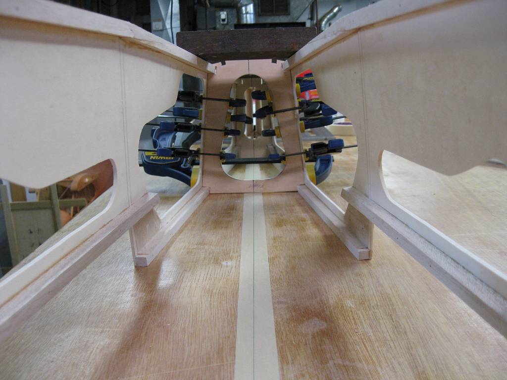

The centerline of the hole is marked on the stands. These are clamped to the bench on the line. Level is verified. I got lucky in this case, .01 degrees is less than .004" per foot.
ID:	1402831   Click image for larger version
Old 03-22-2010 | 04:46 PM
Posts: 1,912
The goal is get both the rudder post and the thrust line of the engine on the centerline with the horizontal stablizer saddle at zero to match the wing tube.
This is the first time I used this method, on previous builds I just squared the wing tube to the rudder post. This worked well and will use the same method in the future. With this method you aligning both engine and the rudder post while the previous methods I employeed only aligned the rudder port to the wing post.
