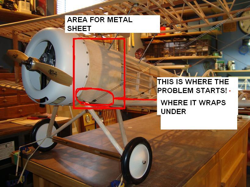

Ok, so i seem to be running into some problems finishing this Sopwith pup.
I am trying to make templates out of cardstock sheets, so that i can cut the correct patterns for the metal sheeting that covers the nose area.
However, I am getting a small "pucker" when i lay the template down. No matter which way you smooth it, there will be a small pucker up in 1 area or another. I am only bringing it down to the edge of the bottom meets the side, so i am not trying to wrap underneath.
Does anyone have any suggestions as to how i can solve this. ??
I will attach a photo which i think is causing the problem, but still i am at a loss for a solution.
Thanks all!

what metal are you using, or is it silver colored covering? If you have any hint of a compound cuve, the card stock will not lie flat. Film covering should stretch/shrink into place OK. If it s aluminum sheet that you are putting down, it's going to be a lot like the card stock. You may be able to burnish it down though if the metal is soft and thin enough. It may be a tedious job, but you should be able to get it down. The ideal solution for an aluminum piece is a roll mill You may be able to tap a piece down on a big steel ball to get the curve you need. I have no experience doing that though so I can offer any tips on how to go about it.
One last option is to paint on the metal color. One of our guys did an awsome job on one of his planes. He used some aluminum powder and rubbed it into the still sticky paint. It looks like a real slightly weathered natural aluminum fuselage.
You may get some better recomendations over on the scale forum.
Last, great looking job so far. Really clean looking work.

I had not entertained the idea of the aircraft being built in the early 1900's i suppose it wouldnt be totally out of place to have some flaws in the metal.
I have 2 products i could use to cover, first is a very think aluminum flashing, OR i have a thin White plastic sheet, which i would then paint to simulate the aluminum.
Do you think it would be easier to use the plastic? perhaps i could then slightly heat it to form it to the contour i need, possible that would work..?

Absolutley right, the plastic sheet didnt work. Even holding the shape firmly while applying small amounts of heat caused it to deform.
Is it possible to fiberglass the nose and get nice clean edges and then apply paint to that? Not exactly sure how i can get a sharp clean edge when glassing a single section
Im trying to avoid just simple painting of the nose because i need the raised effect to match the front hatch.
If i do have to settle for just paint. What is the process of building up the area with dope and Talc powder?
How much can you build it up and still be sturdy hard finish?
Do you have to use unscented talc, or will baby powder also work?
I appreciate any info

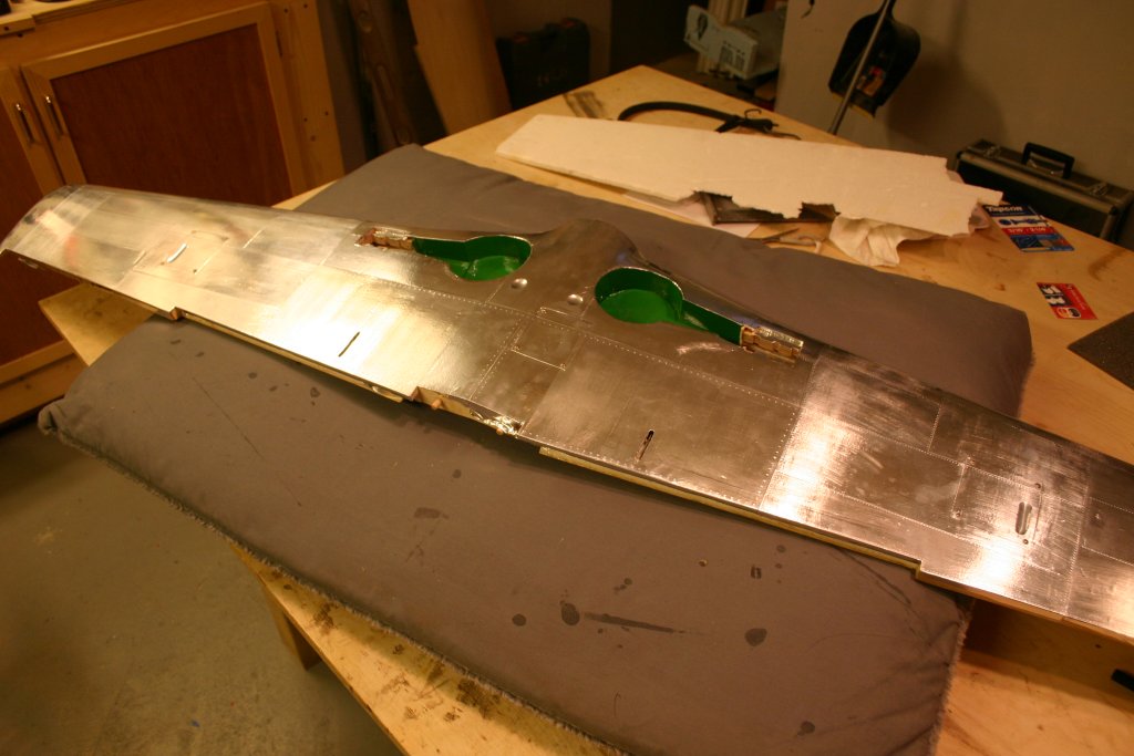

i did something very similar on my Fairey Flycatcher except i didn't mask the edges as i didn't need the clean edge prior to covering with Solartex. here's the link to my RCU thead showing what i did: http://www.rcuniverse.com/forum/m_14..._2/key_/tm.htm
hope this helps some.

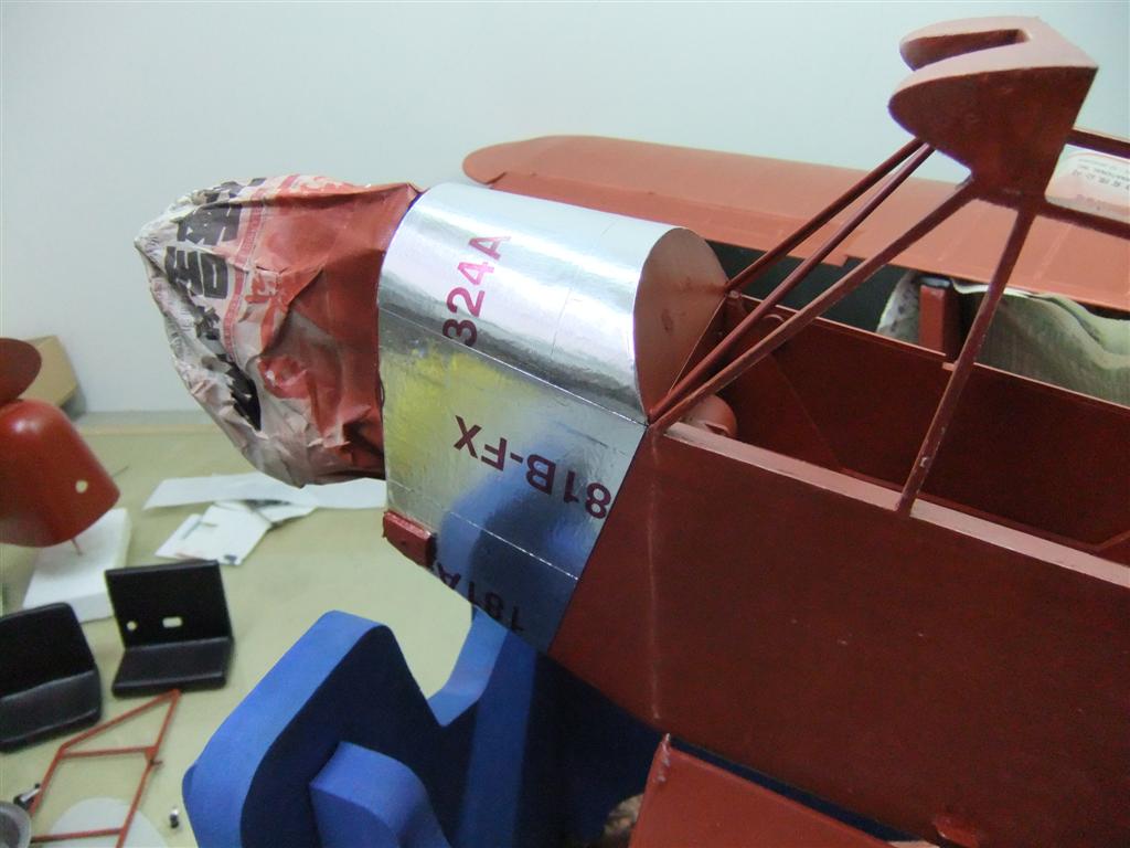

i throw this out as another alternative to 'glassing your model. here's what i did with my Sig Cub on which i'm currrently working. the entire fuselage is covered in Koverall. i initially applied a couple of coats of nitrate dope to seal the fabric and later i applied a coat of lacquer primer and sanded to get rid of the nubs. last night i applied the aluminum tape. i still have to fill in the seams as this should look like one continuous metal panel. the dope and primer helped fill in enough of the fabric so that the weave did not show up through the tape. the one drawback is that the fabric won't prevent dents the way a 'glassed panel would.
