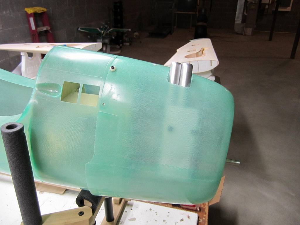

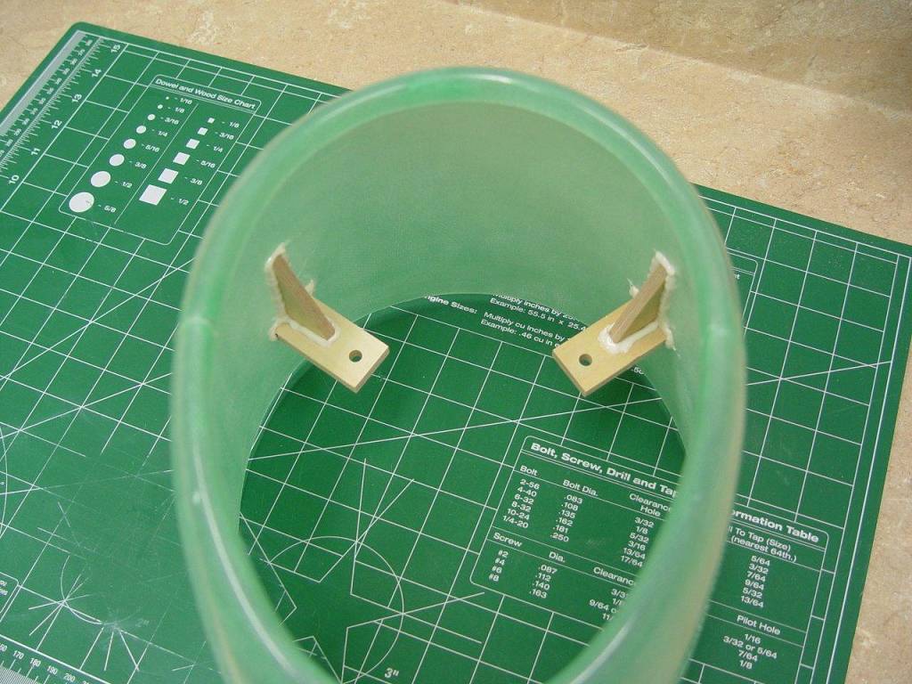

Hi all,
I haven't seen any recent or popular Yellow P-47 builds on this forum yet, so I figured I'd start my own! My only other warbird experience is a rather short trist with a 1/7th Top Flite P-51, and I had such a good time putting that together that I thought I'd go back for more. I plan to use a DA-50 in this plane, and this will be my first giant-scale/gas build. I'm really excited about it!
The quality of this kit is amazing. The fiberglass work is just about perfect, with plenty of scale detail molded in. I love the way you can see through the polyester to the fixtures inside, this really helps when aligning and gluing items inside the fuse. The wing sheeting appears flawless. I think it would be hard to wind up with a poor flying model with just a bit of attention to the build process. Glass builds like this one sure reduce the variables vs a stick built plane, thats for certain.
Here's some shots of the early steps of this build. The cowl mounting and servo tray are attached with Hysol (Aeropoxy), as it sticks like crazy on the polyester fiberglass. Also, here's a quick video of the retract test.

Hi George, I just put a DL 50 in one of these and everything but the exaust tip fit insde the cowl. These are great flyers, you'll love it.

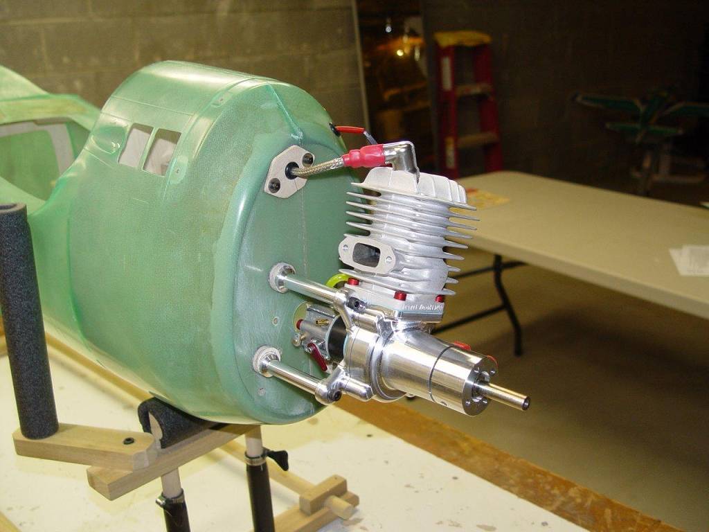

Got the DA mounted today, and the various fixtures and firewall passthroughs completed and mounted. I had to switch from an inverted wrap-around style pitts muffler to a bisson inverted muffler, which is essentially a side box with downdraft tubes. There's just not enough room behind the motor for the pitts without removing a very large area of firewall. Anyways, it should completely fit inside the cowl without anything showing but the two exit tubes at the very bottom.. a nice scale look.
Also have the stab joined and ready for glassing. This bird is going together nice!

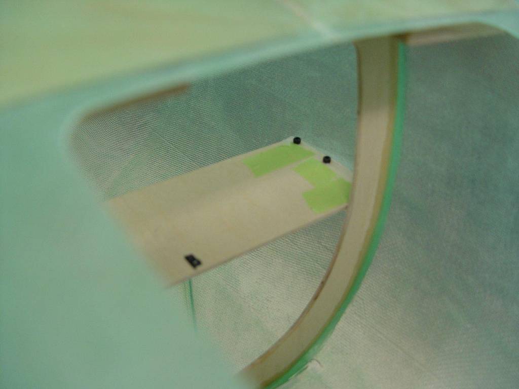

Progress is good. I've got the servo trays installed for the tail and the throttle. I've relocated the fuel tank to the throttle servo platform so it is close to the CG, and I'll utilize the stock fuel tank location for the ignition components. I plan to use an A123 2300 pack for ignition, along with an opti-kill switch. That plus the DA ignition module will take up most of that space.
I've also got the stab joiner provided for and the dowls glued in. And lastly one side of the stab center section glass.

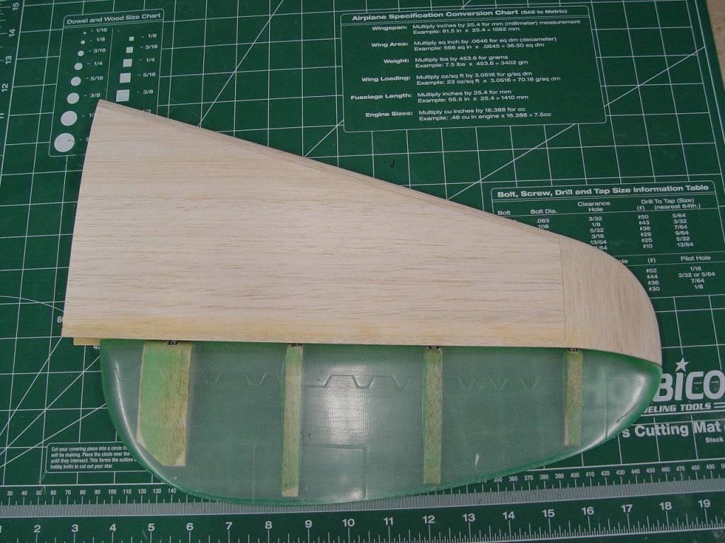

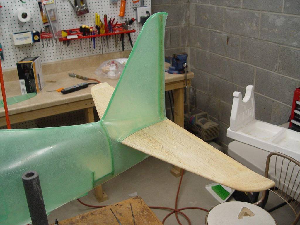

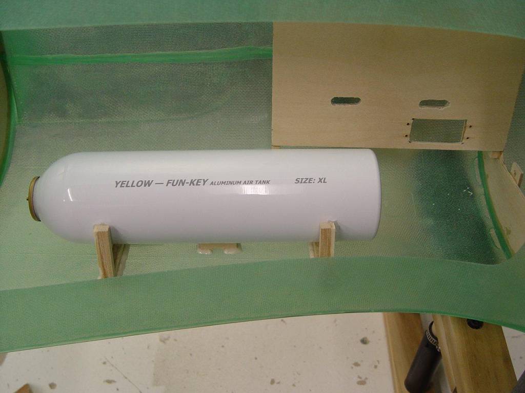

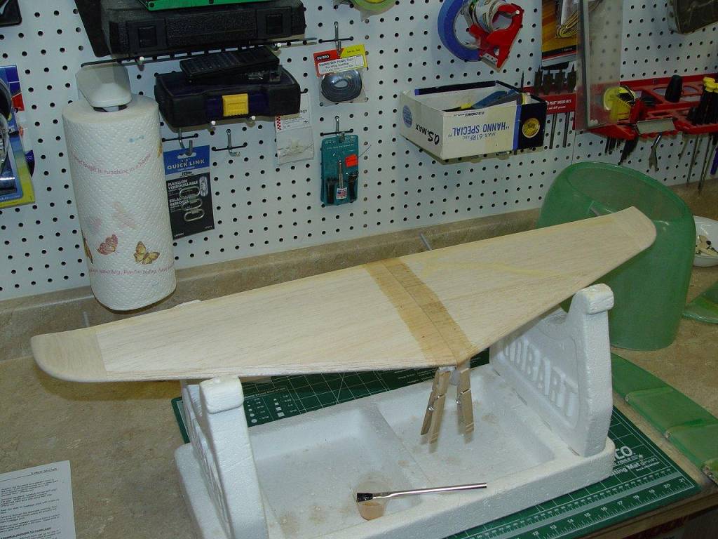

Lots of progress in tonight's update. I finished glassing the stab using .75 oz cloth and Z Poxy. This was my first experience glassing an airframe and it came out surprisingly good. I attribute this to a couple *excellent* tips I got off other threads on this topic. The first of which is the clothespins. These have just the right amount of mass to pull gently down on the cloth and help it to smooth out around the edges (along with some strategic slicing of the overhanging cloth). Second is the use of a roll of toilet paper (!!) to use as a combination roller and sponge. Just keep rolling it over the surface once your glass and resin are down and smooth. The TP soaks up the excess resin and helps make a bubble free contact between cloth and wood. It's genius, and I never would have been smart enough to come up with that on my own.
Next, I mounted the retract air can on the side of the fuse by creating a couple of cradles made of 1/8 light ply and 1/4" balsa square stock. Hysol'd to the fuse and lined with clear silicone for the tank.
After that, I got the stab inserted in the fuselage, aligned and glued down. I used hysol on this, injected under the fillets using a very small tip, and worked into the back of the fillets from the tail gear door well, using a really long tip. It should be strong as heck. Two tips for those working on this step:
1) The stab is really hard to insert into the cutout, as it tapers from tip to root. Hard that is, until you realize that the cutout can be "flexed" quite a bit by grabbing the vstab and bottom of the fuse, and gently spreading them. You can generate just enough extra clearance to get the thing to slide in without effort. This technique should be in the manual!
2) The stab is too deep (chord wise), such that the back of the rudder post doesn't quite line up flush with the trailing edge of the stab. I had to hollow out a small radius in the back of the stab to allow the rudder to have one straight hinge line from the top of the rudder post, through the stab, and on to the bottom part of the rudder post. See the last pic for a sample.
Enjoy!

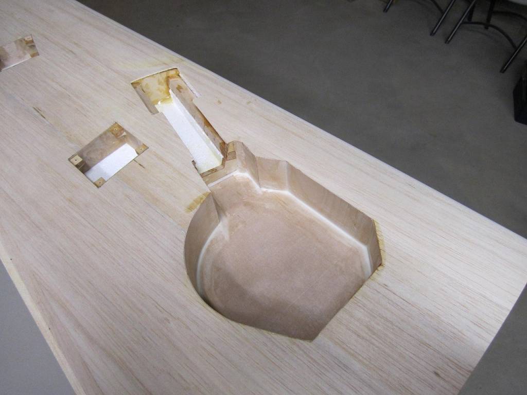

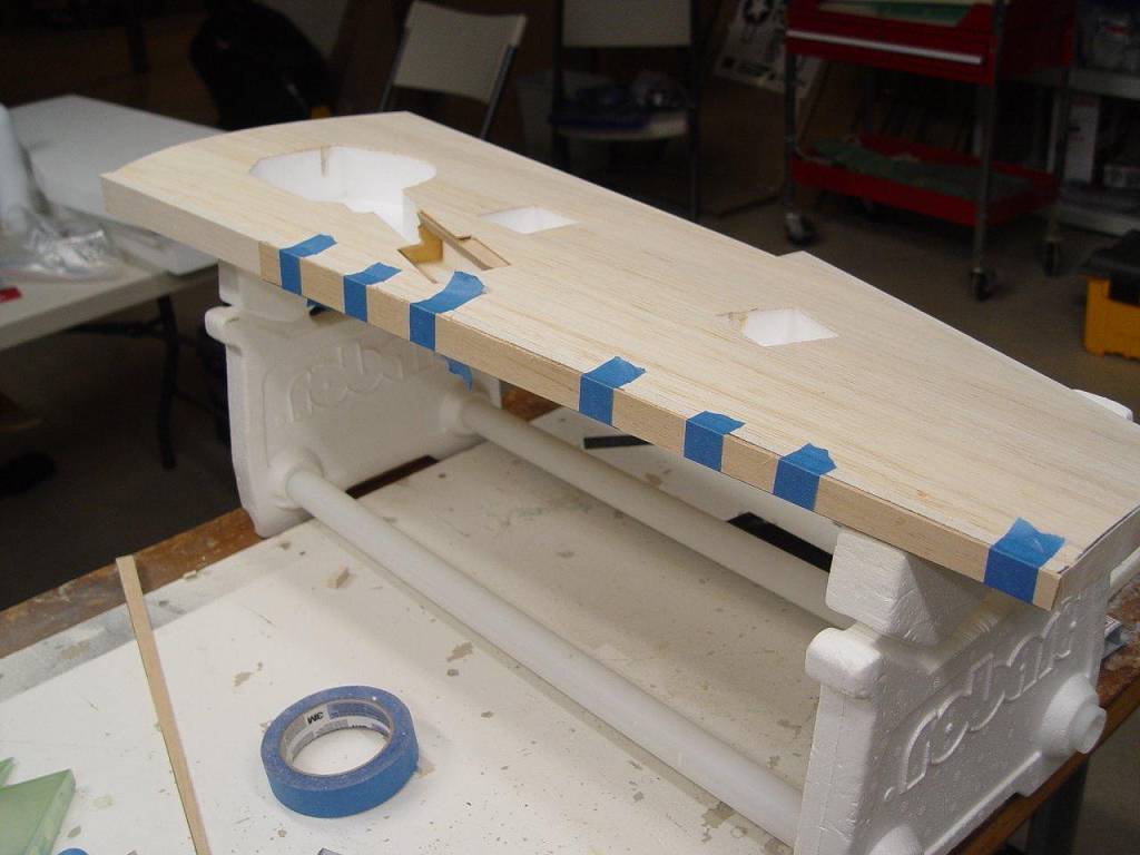

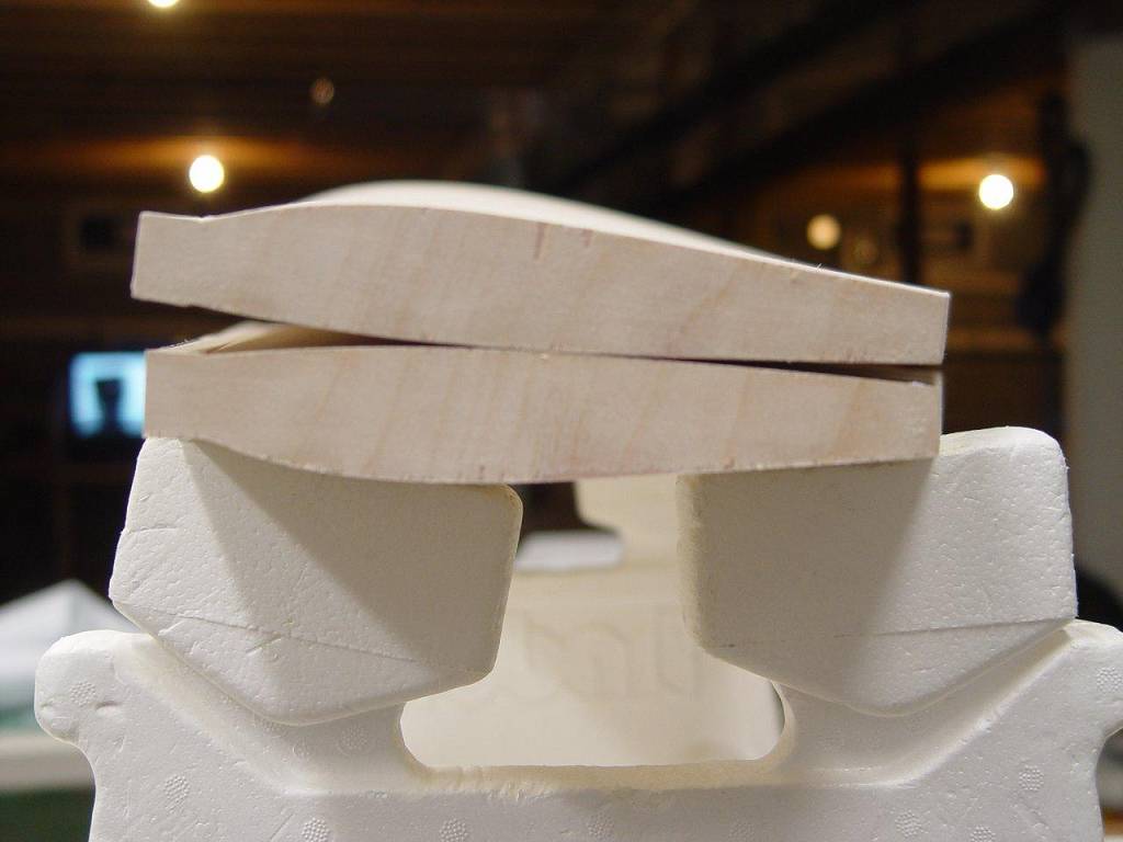

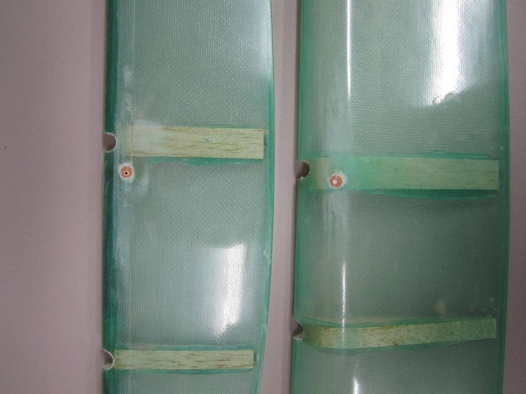

Well the fuselage is pretty much complete, so I've moved on to the wings. It is here that I hit my first snag. It seems that the foam cores for the left and right half are not the same width of chord at the tip. They are the same at the root, however, as evidenced in the first two pics. This became obvious when I was test fitting the wingtips, as the first tip was a perfect fit, and the second had about a 1/8th inch overhang on the leading edge when the trailing edge was lined up perfectly. To resolve this, I've added a 1/8th wide strip of balsa to the leading edge of that wing, for about the outer 2/3rds of the span. I'll have a fun time trying to make that one perfect taper from root to tip, im sure
Additionally I've noticed that there are some other subtle assymetrical features of the two halves, like where the various embedded spars and holes are at the root. So in short, the foam work on this kit does not live up to the quality of the glass work. Oh well, not a huge issue... i hope...

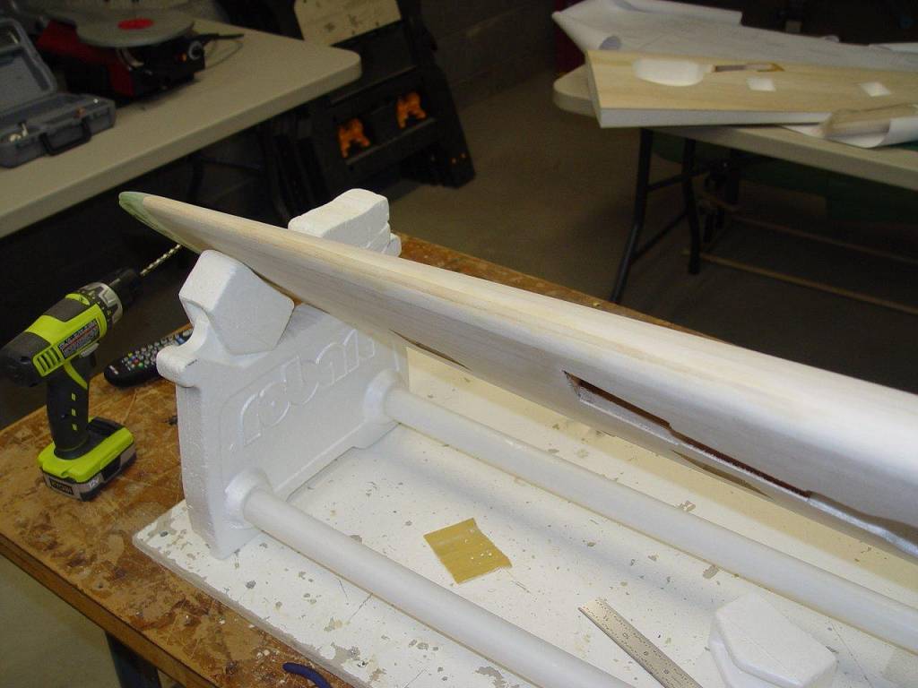

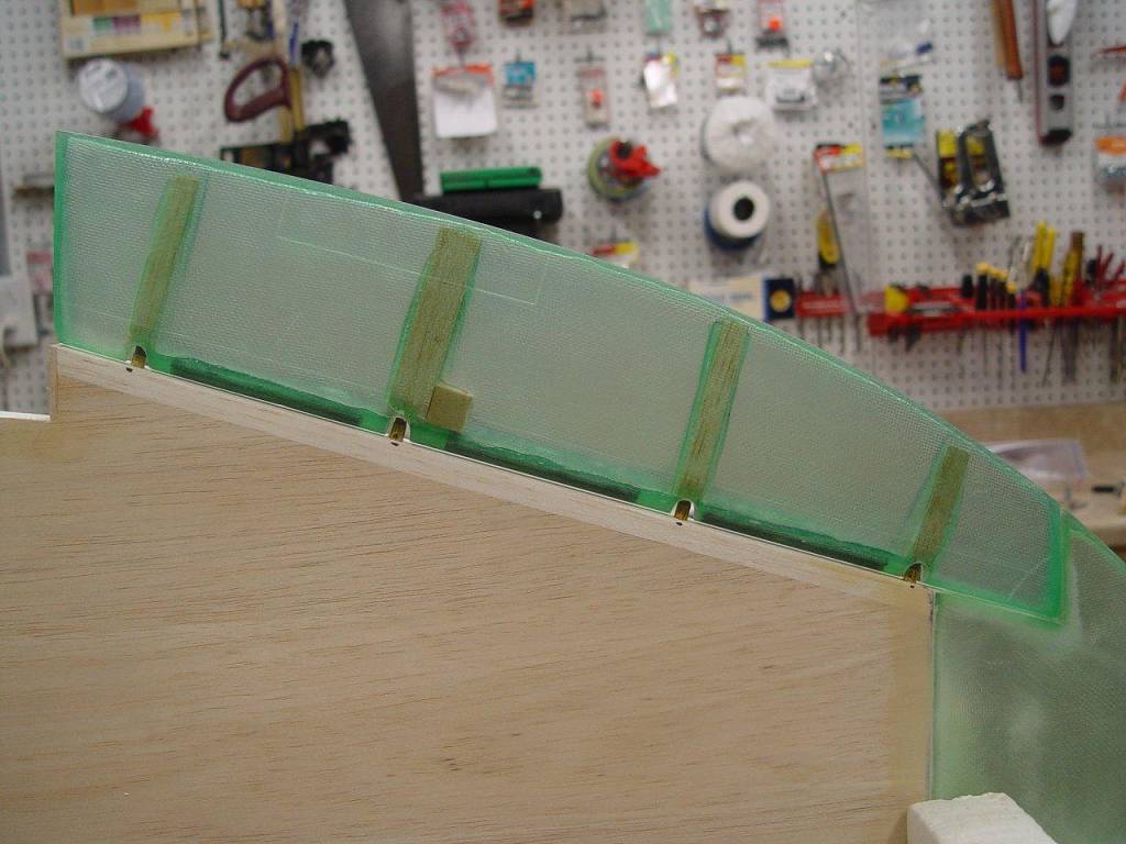

Aileron hinging has begun, and this is a rather complicated setup on the Yellow P-47. First off, due to the anti-flutter provisions built into the kit (notably the lead weights in the aileron leading edge) the instructions call for a very specific hinge pin location. The aileron should pivot at a point about 1/2 inch back from the aileron leading edge, which is quite a bit farther back than most applications require. This leads to deep wells for the hinge to swing the proper degrees of deflection, and a deep relief that needs to be cut out of the aileron leading edge. Also, there's a need to sleeve the wing side of the aileron hinge with a 2 inch piece of 7/32nds brass tube. I assume this makes the hinge strong and rigid enough to cope with this installation.
Note that the plans do not appear accurate and were probably drawn prior to the change in design to this hinge method. They don't seem to me to show nearly enough depth to the hinge pivot point.
The final two pics show the results of my wing leading edge "adjustment". I was worried about this one, but it turned out just fine.

Nice job on the wheel wells....what filler did you use along the joints?
Old 05-20-2010 | 07:28 AM
gmohr's Avatar
Joined: Jul 2008
Posts: 254
From: , NJ
Default RE: Yellow P-47 Build!!
ORIGINAL: tailskid
Tks! It's good ol' epoxy + microbaloons. I had some small gaps that I wanted to glue as well as fill. For any further filling I'll probably just use balsalite.
