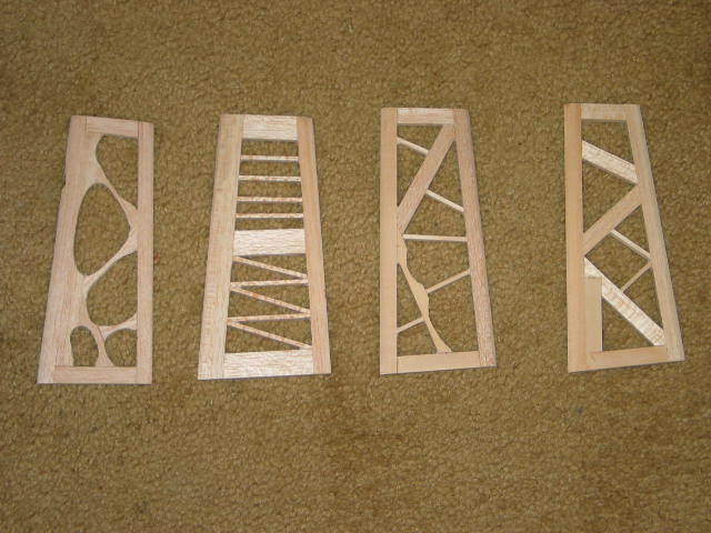

Balsa or Bass on a rudder? I am building a 4*40 and want a bigger rudder. I have a lot of 1/4 X 5/8 balsa and bass. Should I use bass? I built a balsa rudder and I don't think it would hold up for long.

Default Balsa or Bass on a rudder?
E:
Use a bass leading edge, frame up the rest with balsa, then skin it with the grain running chordwise.
If the control horn will mount on the bass that's all you need, if the horn mounts further back make the mounting area solid - stick a balsa block inside where the horn will go.

That is what I was thinking, but without the sheeting. I don't think I need to go that far with a 4*40. Perhaps another section of bass on the bottom for a little extra strength?

They probably are fine with the sheet, but I think it is cool to go with sticks! I went with a bass LE and bottom, with a bass brace. The rest is balsa. I will post a pic when done.

The left was all bass, hogged out to save weight.
Next was all balsa.
Next one is bass and balsa, but the top was too wide.
The right one is the keeper. Bass bottom, left LE and LE support that runs 1/3 of the way up the LE. The rest is balsa. Should be strong enough!
