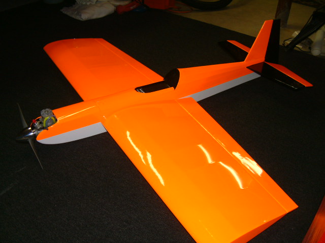

Old 08-05-2003 | 03:04 AM
  #37
Joined: Aug 2002
Posts: 260
From: Somewhere in, ME
Default Build in Progress...
Hi,
I'm in the final stages of building a SE kit. I've got a small site up and running with some pics of the progress if anyone is interested.
http://www.rcsites.net/wydah
The build was very straight forward and I can't wait to finish the trim scheme and take it out for the maiden. I've read a lot of great things about this plane.
