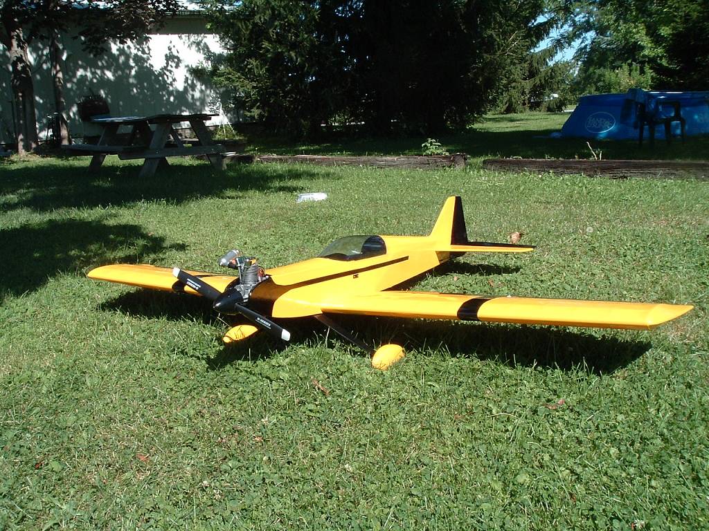

I have, as has airbusdrvr, built both the Venture and the Flyin'King.
The FK is powered by a Saito .91. It was built as a taildragger with no modifications from Bruce's design. The .91 is more than ample power for it. With flaps, on thick grass, the takeoff roll is a few feet and rarely is a power setting above half-throttle used while the plane is in the air.
Both of my ventures have been powered by Saito .82s. It is a nice match to the airframe with power above half-throttle being required for takeoff and aerobatics only. It does not have unlimited vertical with this engine. However, the engines are run on 15% nitromethane fuel and are turning wooden ProZinger propellers. A lot of people use higher-nitro fuel in their Saitos and APC propellers seem to be popular. Personally, I am a little too attached to my fingers to use a plastic or composite prop. And, I like the looks of wood. Perhaps a penalty is paid in performance.
Both planes operate from thick grass and were built as drawn. No modifications to gear position.
With the Venture, when operating from grass, propellers greater than 13" in diameter tend to be problematic due to ground clearance problems. I use a 14" on the FK with no clearance problems at all.

On the plan I measured 4-5/8" from the firewall to the back side of the spinner backplate. I don't think I can hold that dimension with the Saito engine. If Imeasured my Saito .82 correctly, the distance from the back of the prop hub to the back of the bolts on the carb is right at 4-5/8". Add 3/8" for the thickness of the Hayes motor mount in back (carb assembly will hit), and 5/16" for the Saito prop hub, and Icome up with a dimension of about 5-5/16" out from the firewall. Does that seem correct? Can I ignore the 5/16" thickness of the prop hub? That would bring it back to right at 5" from the firewall to the back of the spinner. The Saito would stick out 3/8" farther than the motor on the plan.
Joe

I do that all the time dropping 4 strokes in kits designed for 2's. Don't worry about it.
You may even have to mount a bit more forward to give room for the throttle linkage to work.
Just be sure you hit your correct CG balance.
