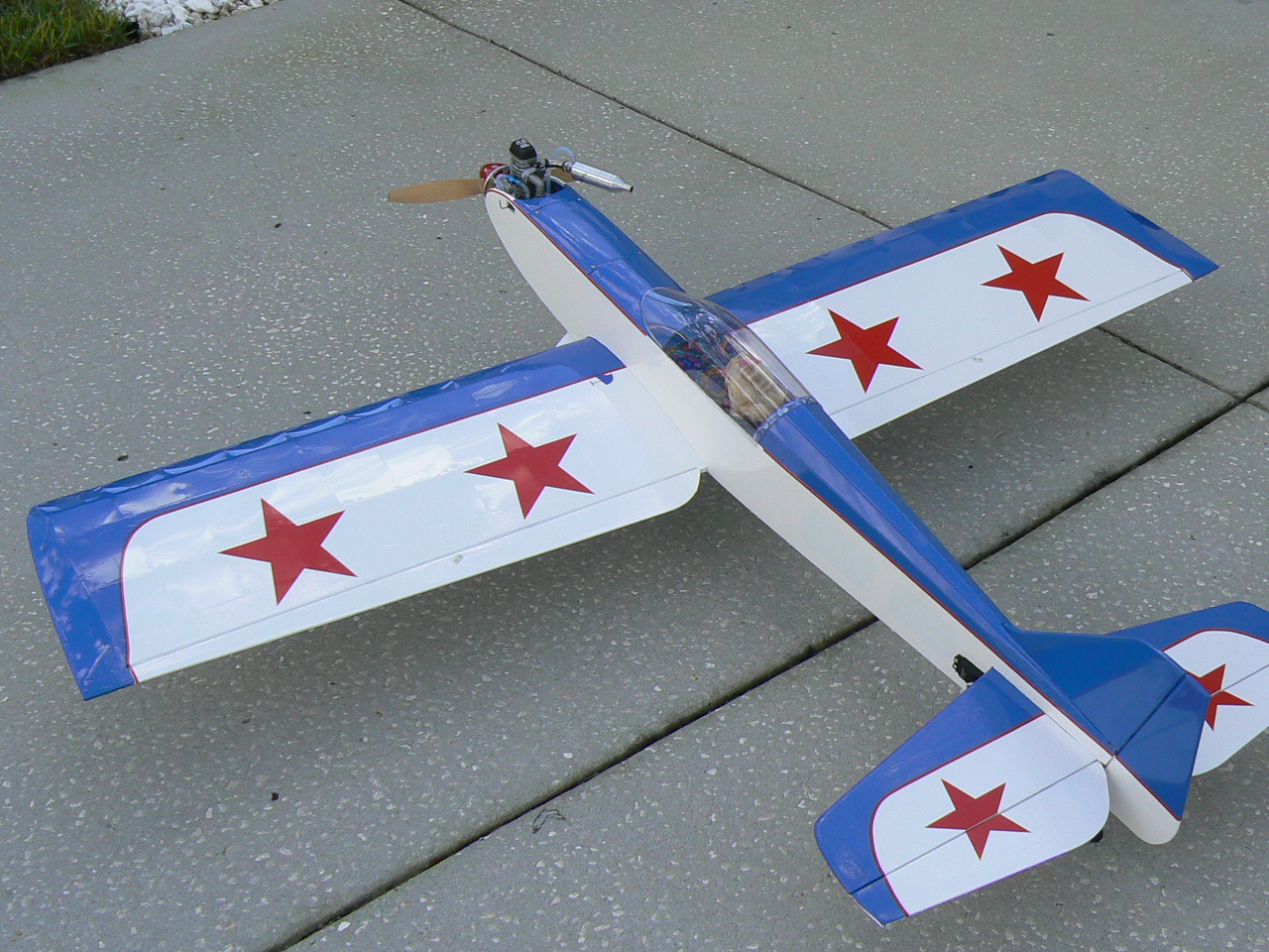

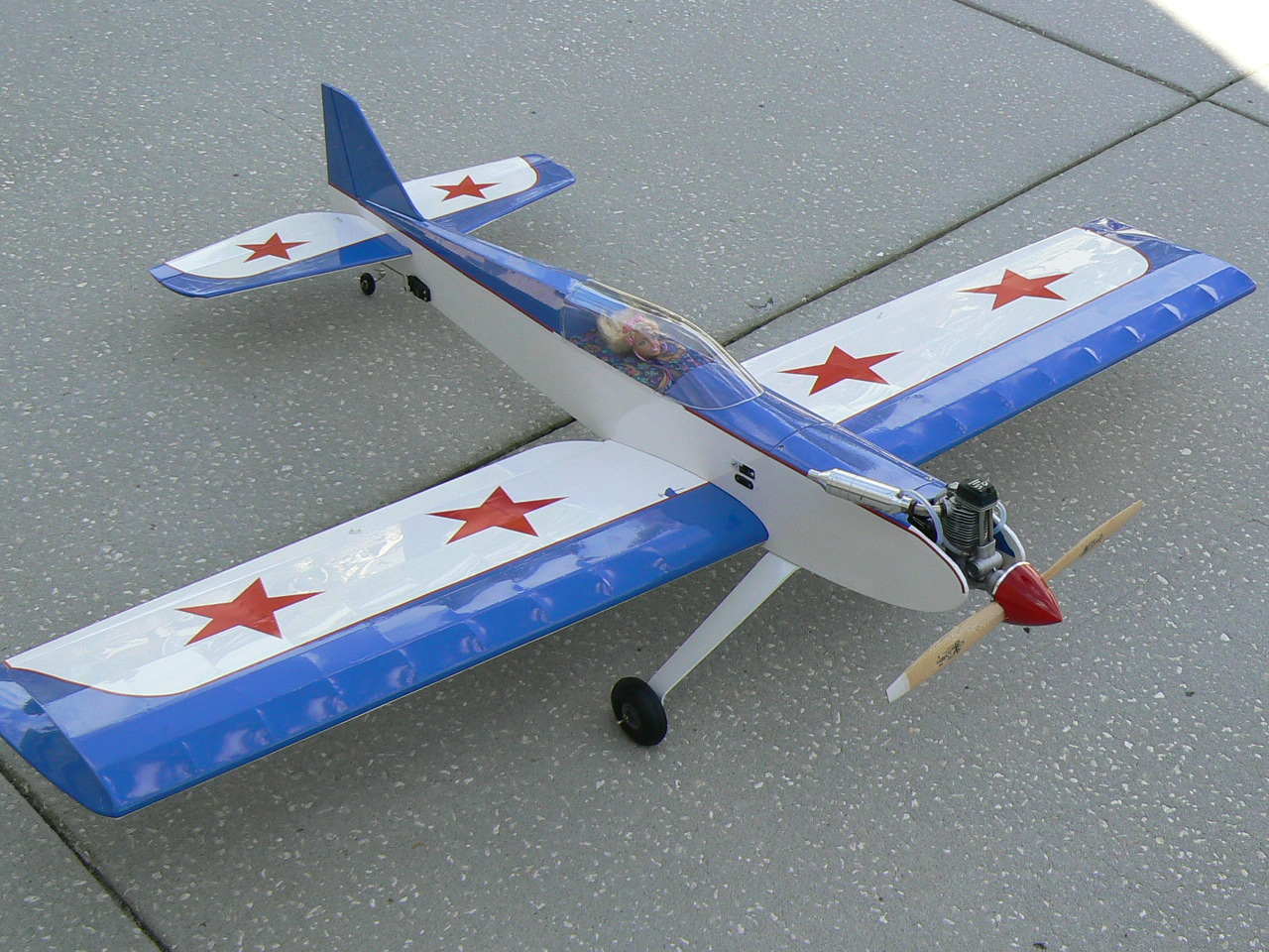

Many people have these kits and it will be the best one you have or ever will build. A four-stroke 70 to 125(a bit on the powerful side) will fly it. A 60 to 90 two-stroke will do fine. It is a "quality" kit and everything else will be substandard in quality after this build. Enjoy I have one built, one in a kit and also the very first kit(Venture 60) that Bruce sold.

That is a nice looking plane. well done.

Ok I just noticed something on airbusdrvr's plane which is beyond sweet btw, nicely done! He moved the rudder and elevator servos to the tail. My only complaint about the 4*60 I built was how tail heavy it came out. With a Saito 100 up front, I still had to add 15oz. of lead up front.
Does the Venture build more neutral as far as CG goes?

Also, about the aft-mounted servos - if anything, the V60 tends to build nose heavy, so the aft servos might actually help the balance. It depends a lot on engine weight, but I rarely hear from anybody with a tail-heavy V60. I actually have some tail weigh in mine.

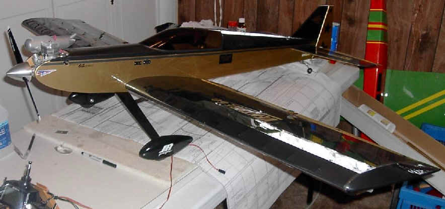

Thank you for the compliment on the color scheme. It was a long time ago, but as I recall, I used Monokote metallic gold/metallic charcoal. The stripe was top flight striping. I used dual aileron servos, pegged the firewall and landing gear block. I often woundered what it would have looked like with a Saito Golden Knight engine. I considered putting the servos in the rear. I'm glad that I didn't as it balanced perfectly with no additional weight added. It was a nice flying airplane and a dream to build and land. It was somewhat underpowered with the FX .61, but I was flying at an altitude of 5,000+ ft altitude in Wyoming. There are schemes which are easier to see in the air. Good luck with your build!

Bob, I need to ask...........what color did you use to paint your wheel pants? I'm covering in the MonoKote Metallic Charcoal like you said you did but there is not matching LusterKote paint. Did you just use black for the pants or is there another matching paint choice?

Hi Andy,
I'm sure that I used rattle can gloss black, probably from WallyWorld. * I do recall that it was so cold out in my garage when I painted the wheel panties and landing gear that the paint would not flow out. I ended up with a rough "pebbly" finish, similar to the rock resistant finish that the auto companies used to use on auto rocker panels. It actually looked pretty good.
* A better choice would probably be fuel resistant top flight rattle can paint.
