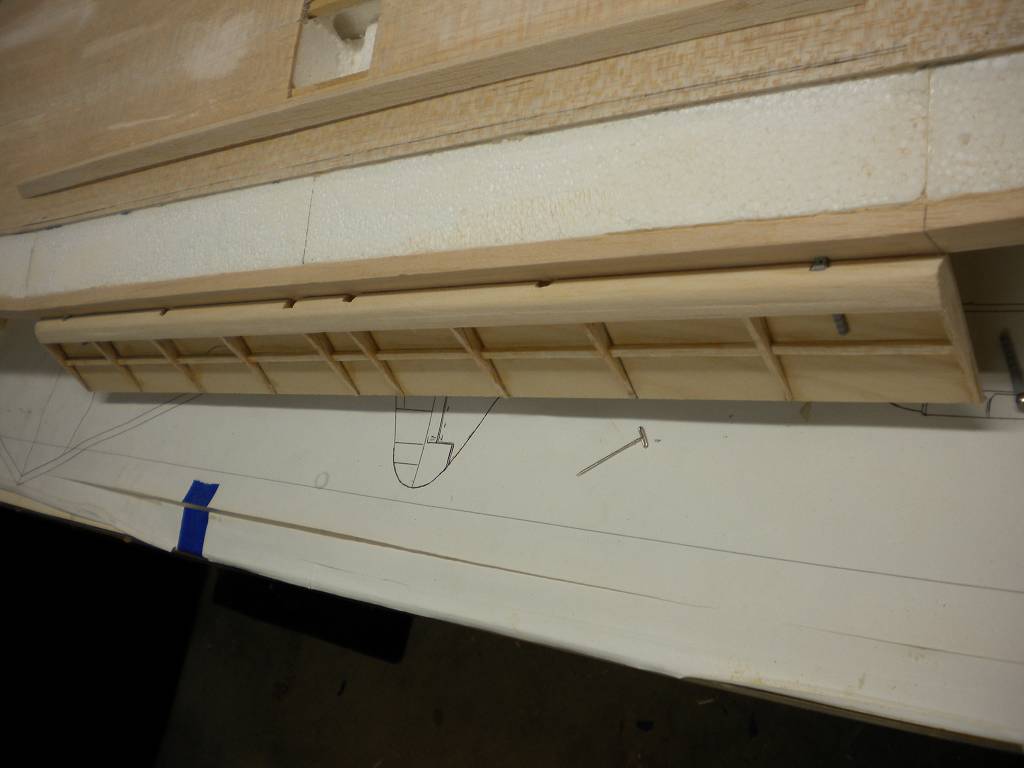

I built the ailerons and elevators over the weekend. For the elevator, you edge glue two sheets of hard balsa together and cut to shape the "core". Then add the leading edge and the ribs. Sand to shape, hinge and cover.. done.

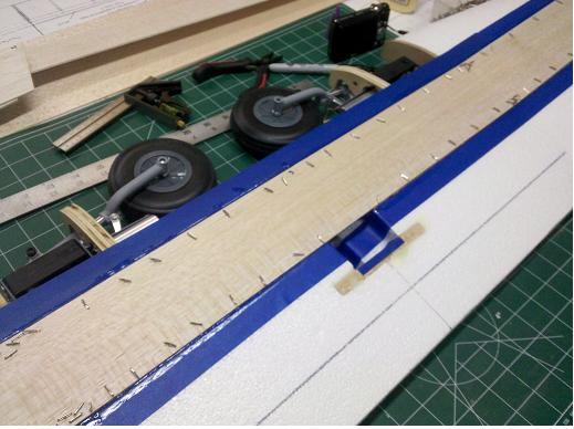

Yes Sean, You're right. I did not activate the glue with water. I just spread a layer on the foam and a very thin layer on the back side of the sheet. Then pin it down, You cannot run the pins straight in, you have to push them in at about 45 degrees. I push one in to the front and the next towards the rear. On the bottom, you need to add extra pins in the center section. On the top you need to add extra pins to the dihedral joint to keep the sheet from lifting up. Wait 4-5 hours and pull the pins out. I used needle nose pliers and gave each pin a small twist as I was pulling them out. Be sure to pull them out at the same angle you pushed them in, or you might splinter the wood around the hole. The glue does expand a little. It will foam up around open pin holes and in between sheets that don't fit exactly together. The glue-foam sands down easily and is more or less the same color as the wood.
The Fiberglass center section is just cosmetic. The sheeting is thinner on the top rear to accomodate the fg CC. Once the wing is finished but not glassed, fit up the CC and make any adjustments you need to get it to fit just right then do your normal wing alignment. Believe me when I tell you that after the sheeting is done you could ride the wing like a surfboard without breaking it. It's crazy strong.. you won't believe it.

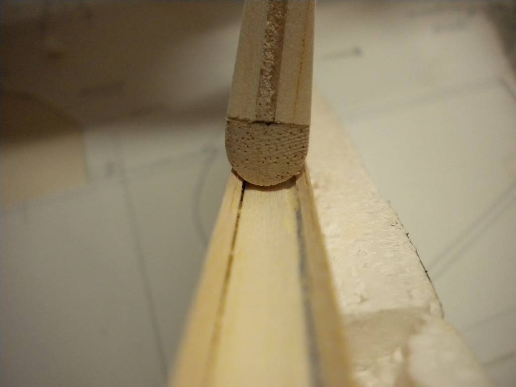

Here is a short update from the work over the weekend. This is how you build the flaps and elevators. The process is to edge glue two harder balsa sheets together and cut to the shape of the elevator. Transfer the rib marks from the plan and pencil them in to both sides of the basla sheet. Glue on the leading edge, add the ribs, drill the hinge holes, and sand to match the shape of the plans. The center flap is the only one I've built so far. I cut the 1/6" aircraft ply to match the plans and used angle aluminum to keep it straight using small clips. Then I added the leading edge and the ribs. I added the 1/8" square stick between each rib, hinged and here is the result. The outer flaps are coming soon to a built thread near you.

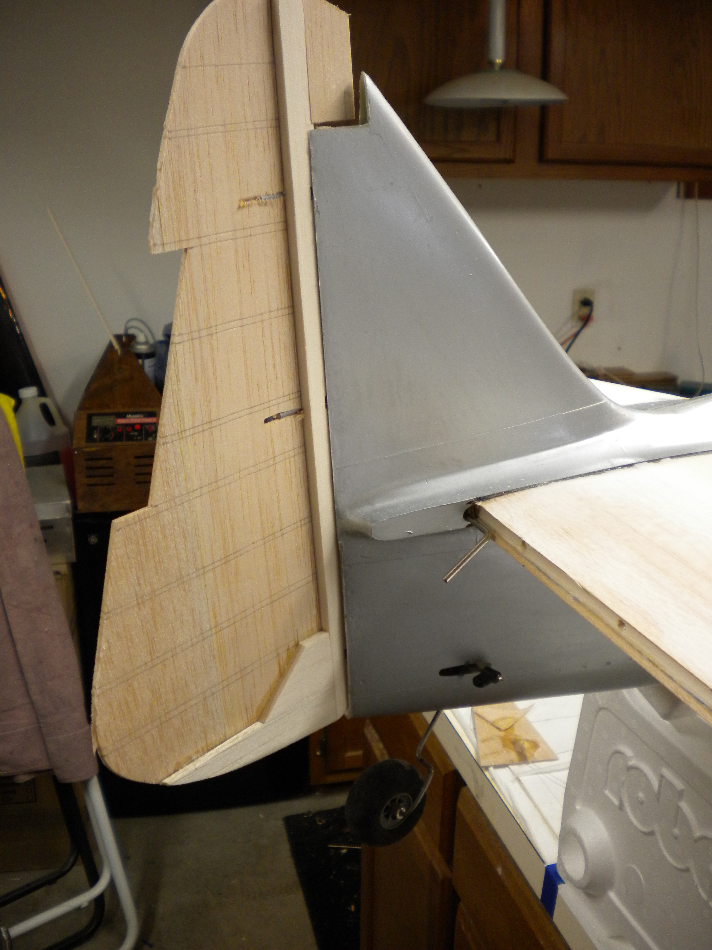

I installed the Horizonal Stab and built the rudder over the weekend. The tip of the stab needs to be sawed off. I also used a dremmel to remove some of the extra fiberglass and resin in the hole where the stab slides in. I went with an internal torque type of elevator control. That need to be installed behind the bulkhead so it is in-line with the hinge-line. I used a small dowel wraped with sandpaper to make the cut out for the torque fork. I also built and hindged the rudder and tail-wheel. The rudder is built the same way the elevators are. It's important to make sure the Robart 1/8" hinge points are set all the way down to the radius of the leading edge. I added blocks to the trailing edge on the inside, drilled and mounted it to the hinges in the rudder to make sure everything moved smoothly and that it rotates properly without bindling. I think Mr. Nano swallowed a bug in picture #3

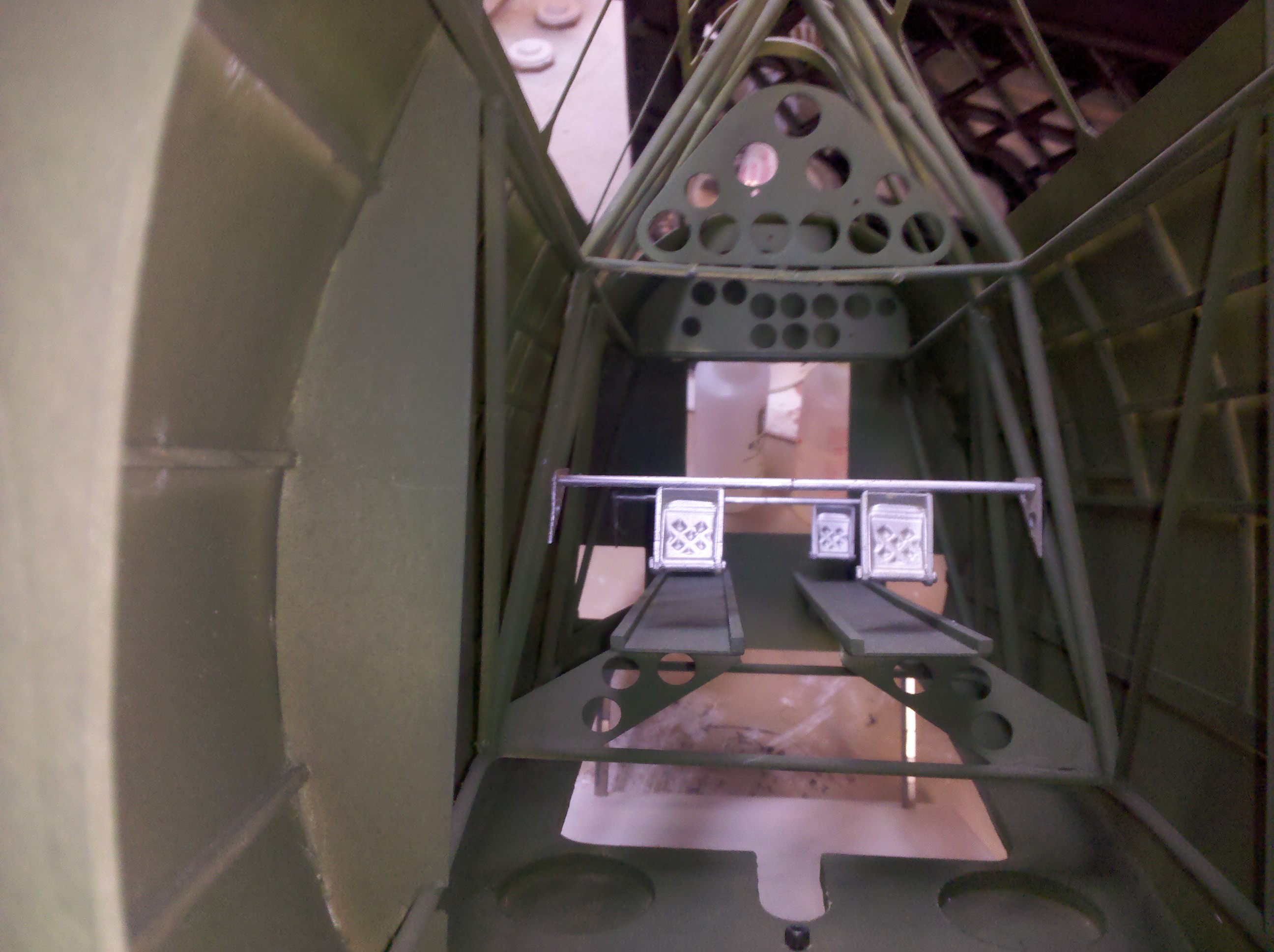

Dave did send me some pics of the cockpit kit he's working on. Do you have one now?
I'd like to see him make a version of it that only goes down to 'bust' level.

The pictures above are of Dave's Cockpit mock-up. I took them with my cell phone when I was on a visit there over Christmas. Dave has the drawings available, but I'm a long ways from that step just yet. I may have to go with a "bust" level cockpit tub too, if I want to have it ready for Joe Nall that is.... I'm still on schedule, but time is getting short. I ordered a dummy radial engine, so I can mount the cowl and motor. Then I can mount the radio tray and push rods, then I can install the formers and tie in the elevator torque rod before the Vert Stab trailing edge. I have to built it in order and everything is connected to something else. Whew! I'll keep you updated and I try to post some pictures of all three flaps working together.
