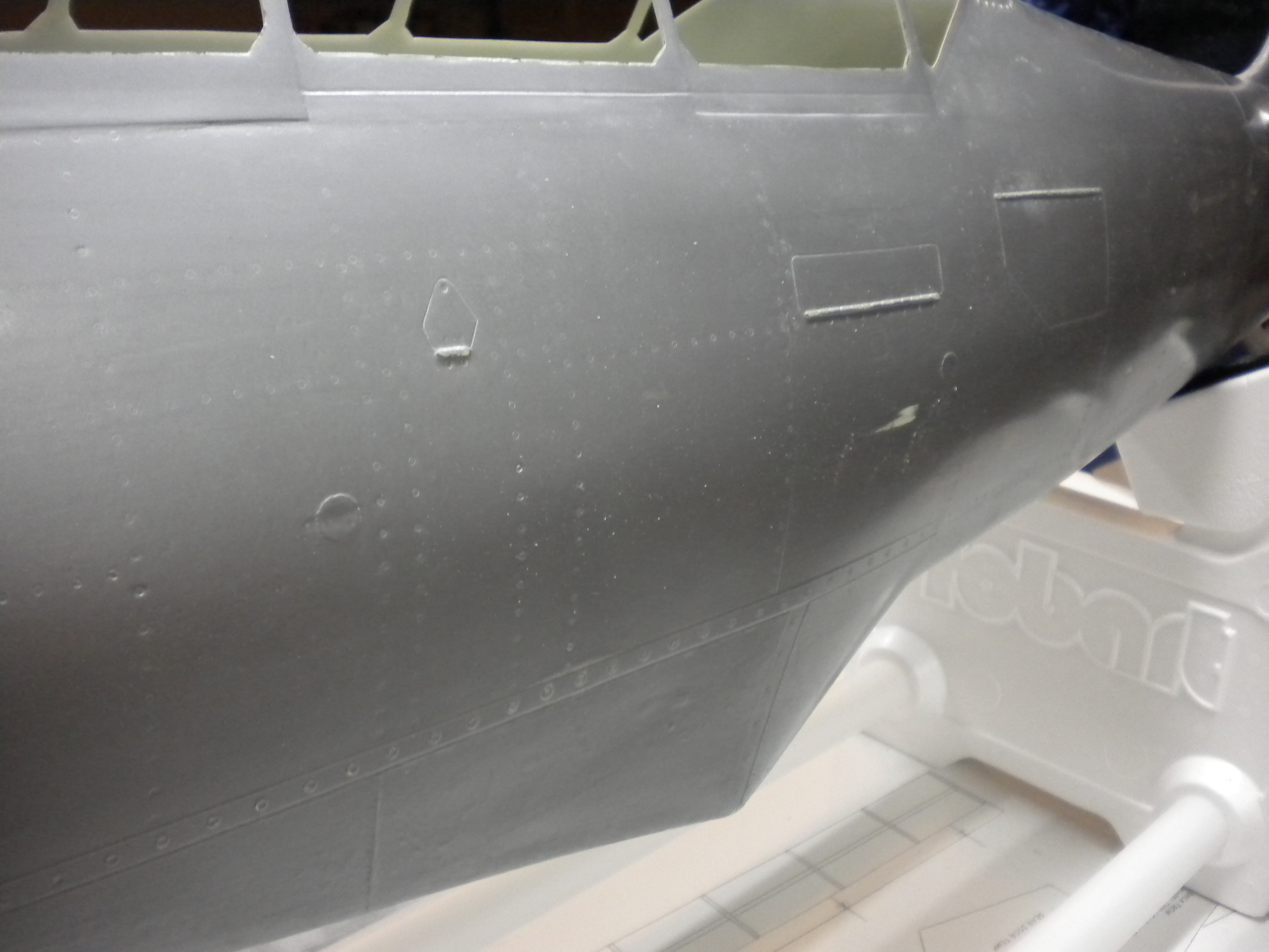

The fuse is a one piece design and weighs less than a double cheeseburger! It has tons of detail molded right in. Panel lines, rivets, dzus faseners, hatches, hinges..... The manufacturer even offers a 3 piece sliding canopy kit and a full tubular cockpit kit. I think I'll pass on the canopy kit but I definatly plan to build and install the cockpit.

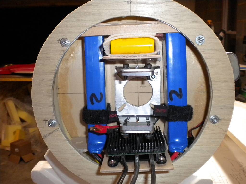

I've decided to go electric with the Texan. It's a PREFECT platform for electric conversion.
This has some potential...
Old 11-27-2010 | 12:16 PM
mschneider2005's Avatar
My Feedback: (34)
Joined: Aug 2005
Posts: 240
From: Matthews, NC
Default RE: Scale Dynamics AT-6 Texan Build Thread
This has even more potential....
Old 11-27-2010 | 12:21 PM
My Feedback: (34)
Joined: Aug 2005
Posts: 240
From: Matthews, NC
Done... The batteries lock in at the top and are held in with a velcro strap near the bottom. The are easily removed from the bottom the scale split cowl. I think there will be room to mount the ESC on the firewall too. This project beats the heck out of a 30lb box of sheets and sticks...

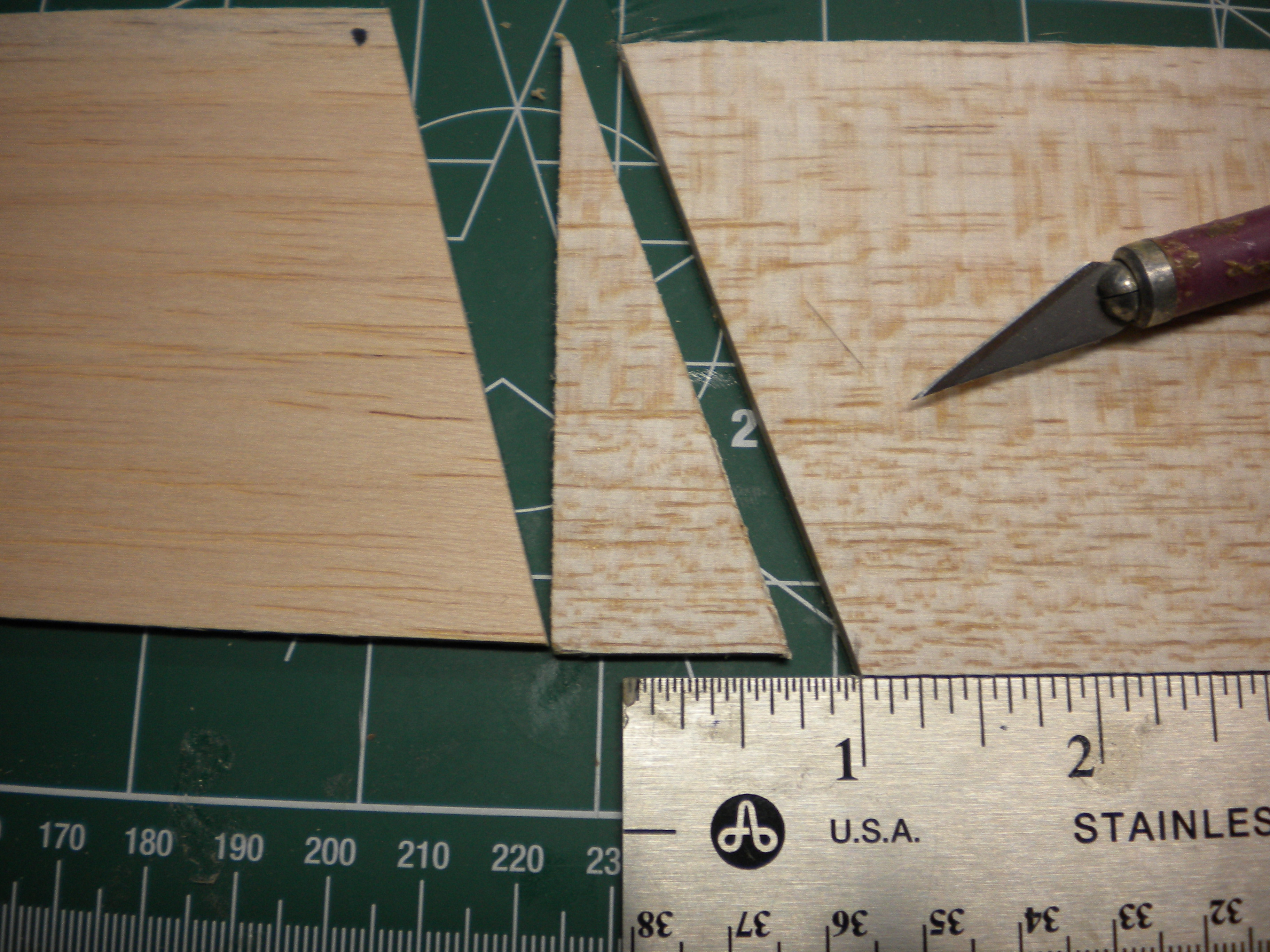

I started by sorting the sheeting into hard and soft groups. Both ends of the 48" x 3" x 3/32" sheets get an angle cut by measuring 1" from the end on the bottom up to the corner. Then the 36" x 3" x 3/32" gets cut in half to make 2 each 18" pieces. Those also get an angle cut to mate up on each end of the 48" piece. The result is one long sheet measuring 82" long by 3" wide.
I made up 4 (2 for the top and 2 for the bottom) of these sheets before proceeding to the next step.
Then I used a dozen t-pins to pin a sheet into its location 1/8" back from the front of main spar. I used masking tape to outline the sheet on the foam. It's important to have the tape flush with the edge of the sheet. If it gets under you wont be able to remove it, if it's too far away, the glue will stick to the foam where it's not supposed to.
Once the sheet is outlined with tape, you remove the sheet and pour on the Gorilla Glue. I used an old credit card to spread a generous but even layer on the foam and a thin layer on the backside of the sheet. You don't need to worry about one kicking off before you do the other, but don't take a lunch break in between. When you're ready place the sheet on the foam and be sure you have it lined up within the tape line.
Start pinning! I started in the middle and worked my way towards the tips. Pin down both edges of the sheet and both ends of the sheet evenly. 4 pins on this edge-4pins on that edge, 4 pins on one and then the other, and so on. Insert the pins at a 45 deg angle. I did one pin 45 degrees to the front and the next 45 degrees to the rear. To prevent the sheet from riding up the pin when the glue starts to expand. When the sheet has been pinned, stand the wing up on it's leading edge so not to distort the -2 deg washout or accidently build in a twist. That's it... wait 5 hours to the glue to cure and do another sheet on the other side of the wing. Once you have the 4 main sheets installed, the wing becomes incredibly strong.
