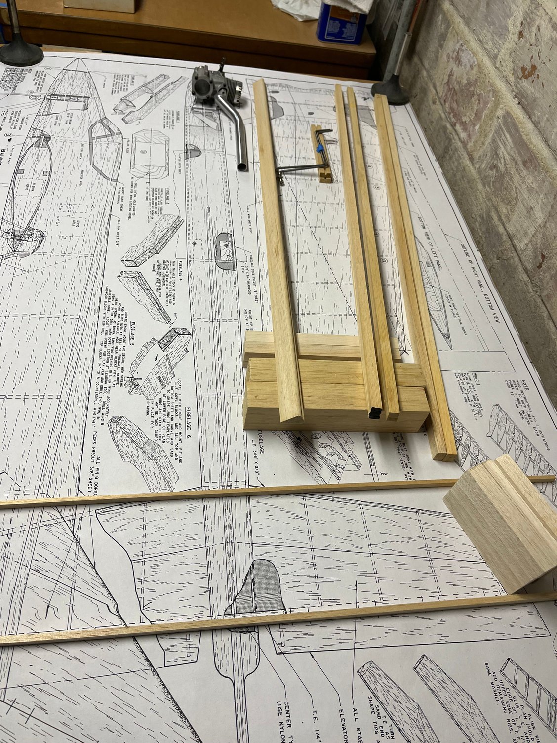

Troublemaker 60
Here is a new project on the table that will be a short kit/scratch build. I’m not a big plan builder so let’s see if this works out ok. I love the old pattern planes and stumbled upon a Eureka short kit recently.
I just picked up my print and am now picking wood and hardware that I have laying around.
This should be fun, have several fine engines and pipes to choose from………
https://cimg1.ibsrv.net/gimg/www.rcu...511380428.jpeg
https://cimg2.ibsrv.net/gimg/www.rcu...2b46f9ed7.jpeg

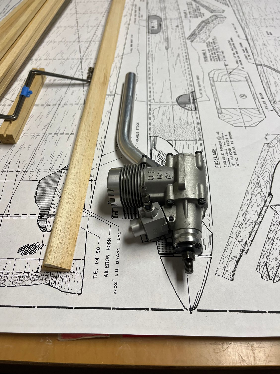

plumberdeluxe 02-07-2024 10:00 AM
Thinking VF .61 on this one……….
Still waiting on the short kit to arrive, plenty of things to get ready, wood and hardware is here, gotta round it all up……..

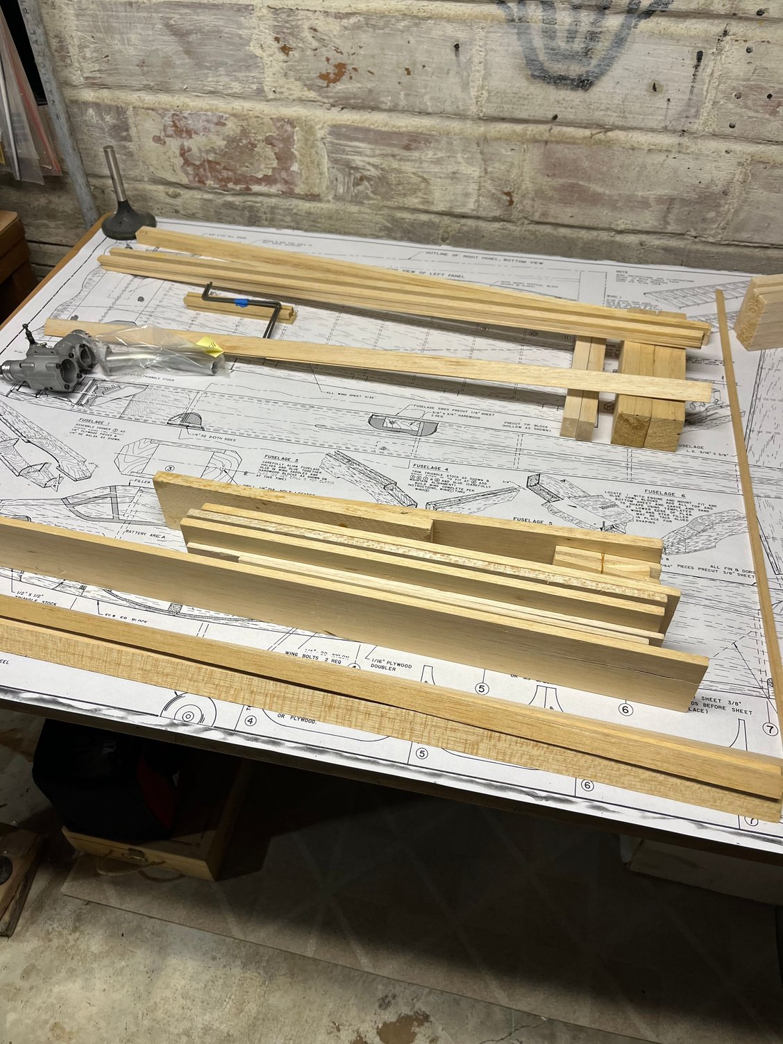

plumberdeluxe 02-07-2024 11:06 AM
Still adding to the pile and coming out ok so far, found some 3/8 sheeting and some big tri stock for fuse sides. Getting excited, this will be light, the wood is really old Sig stuff I got from a guy last year. This wood is amazing compared to what is on the hobby shop shelves…….The Sig 3/32'x 3" sheeting I have for the wing says 93 cents on it............:o I just looked and the same sheets cost $1.73 more each per sheet to buy today..............Wow!

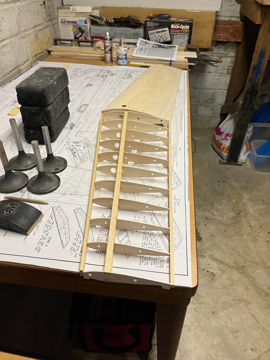

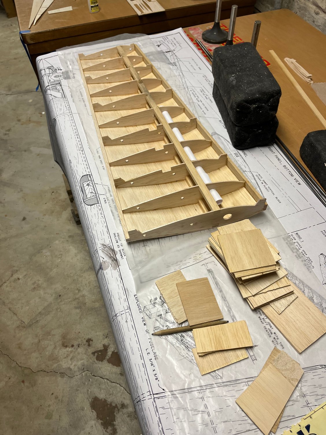

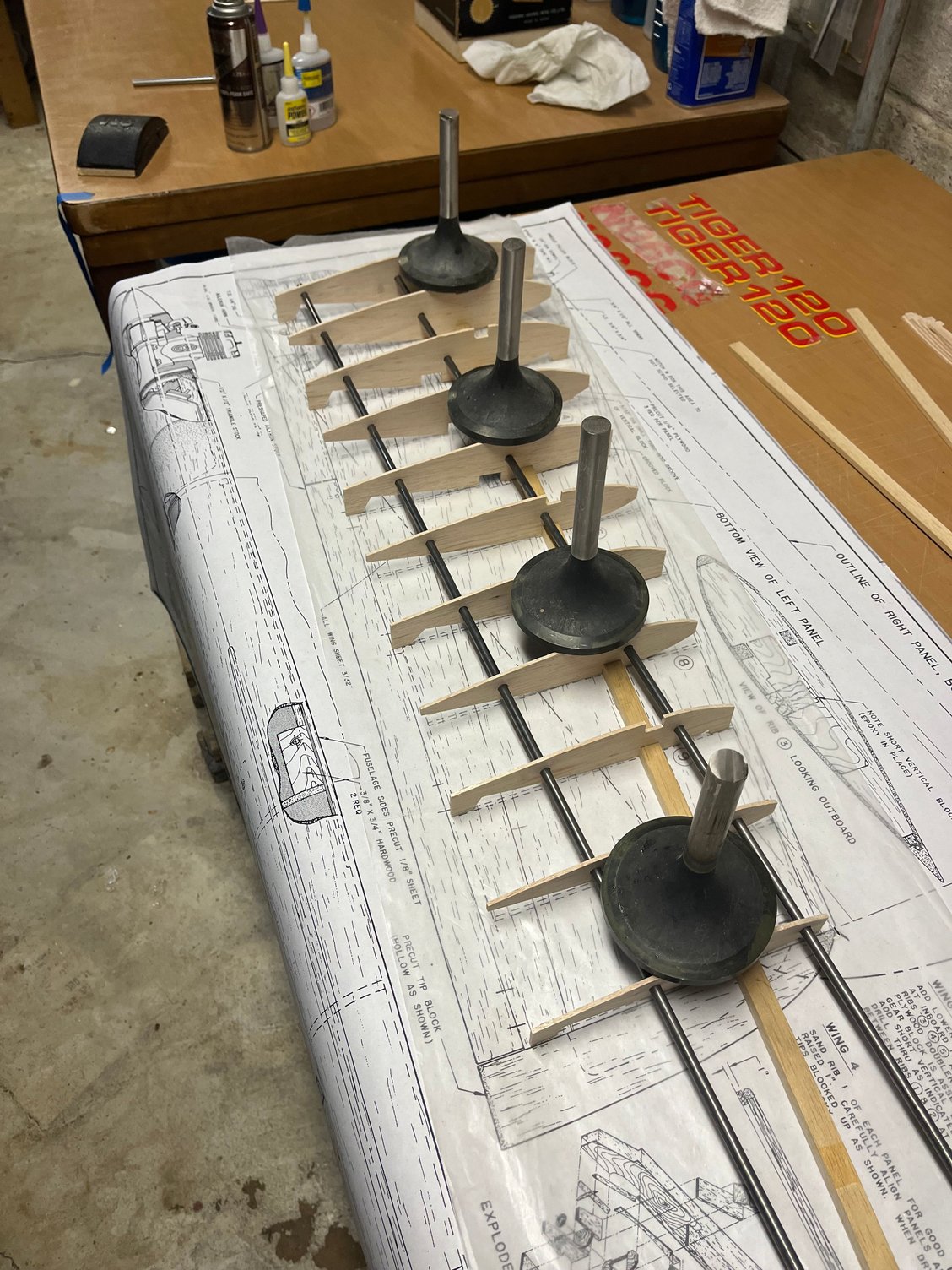

plumberdeluxe 02-07-2024 05:16 PM
Well, let’s get right into it……….
Nice wood and cutting from Eureka, Very nice!
I had some 1/4 piano wire so I may utilize the alignment holes provided, not a big fan of things like this but maybe this time it will benefit me as the ribs have tabs on every other rib…..
https://cimg0.ibsrv.net/gimg/www.rcu...48249df67.jpeg
https://cimg1.ibsrv.net/gimg/www.rcu...e0da1003b.jpeg
plumberdeluxe 02-08-2024 06:09 AM
Here is a path for servo leads………
And the first wing setting there ready to start glueing things up……..
So far so good, another tapered wing which for some reason messes with my brain………
https://cimg3.ibsrv.net/gimg/www.rcu...612b6cb14.jpeg
https://cimg9.ibsrv.net/gimg/www.rcu...4fbf217df.jpeg

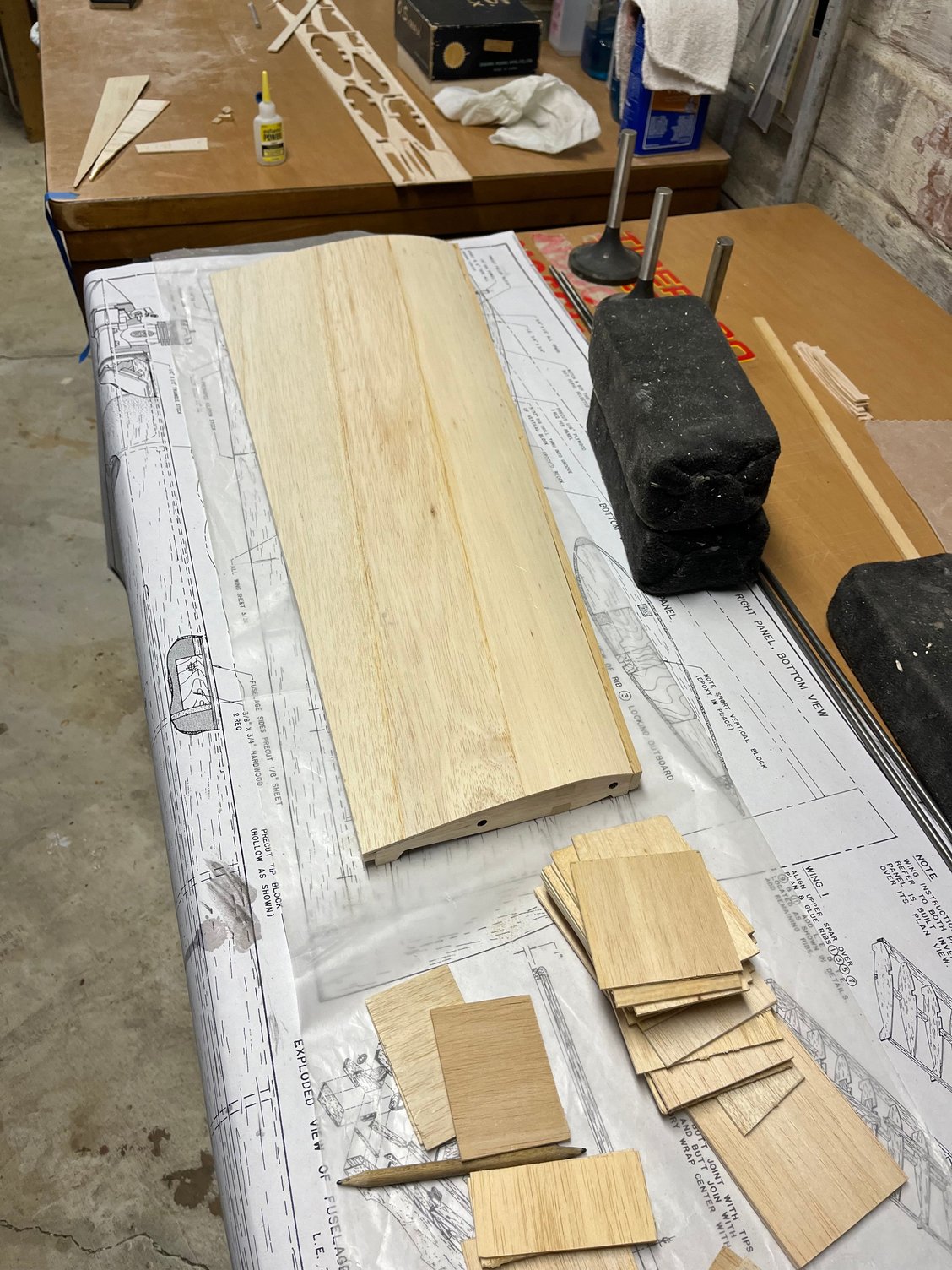

plumberdeluxe 02-08-2024 12:27 PM
Here is a wing top skinned, I’ll flip this over and cut some sheer webs from scrap, amazing how much scrap wood you can find if you’re really looking…………🥺

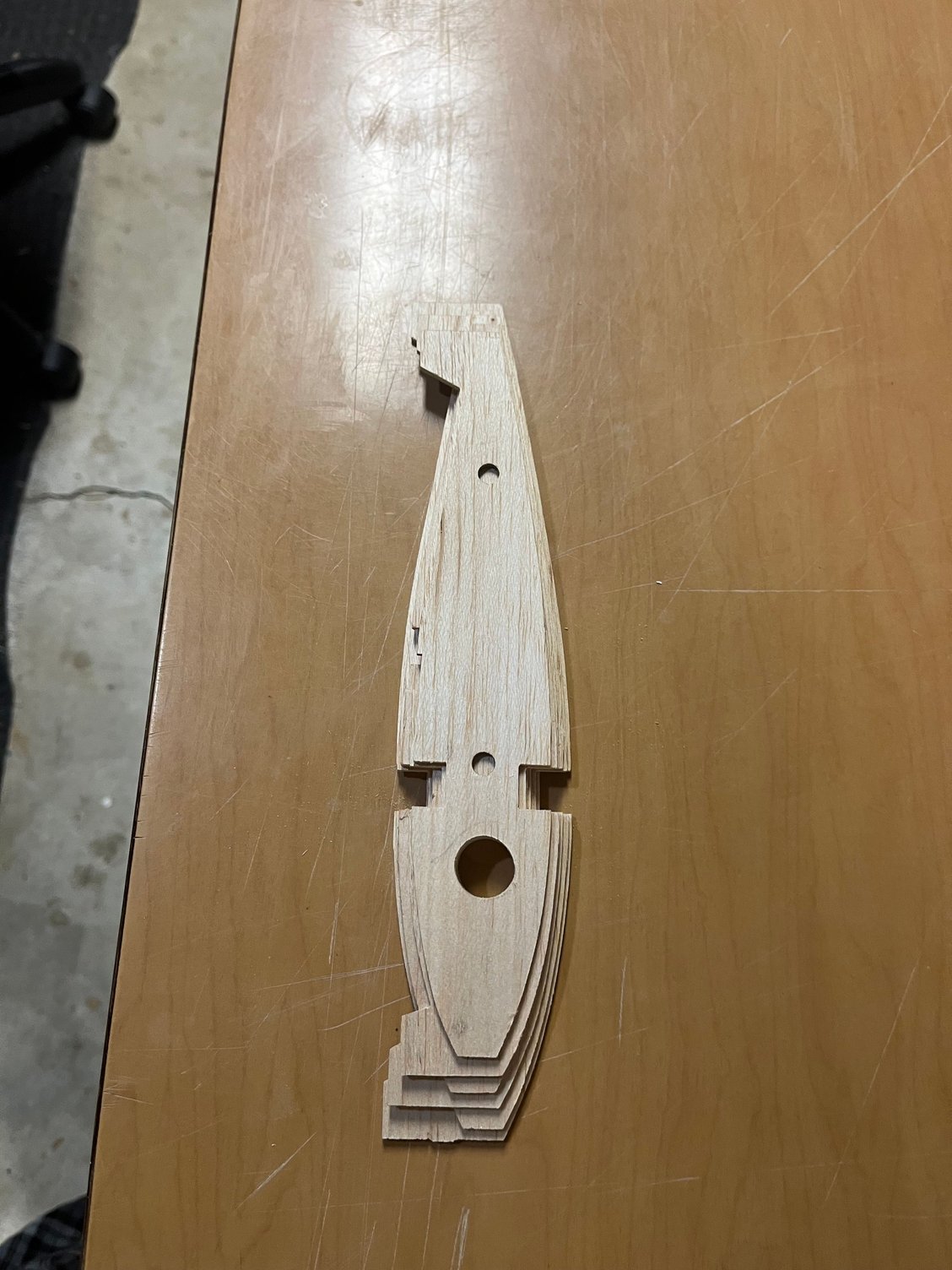

plumberdeluxe 02-09-2024 04:36 AM
Here is the bottom with gear blocks and servo rails installed. Tabs are gone so now the bottom sheeting can be prepared……..going ok so far, no sense in putting away the scraps just yet…….🤔
https://cimg0.ibsrv.net/gimg/www.rcu...f56e2b781.jpeg

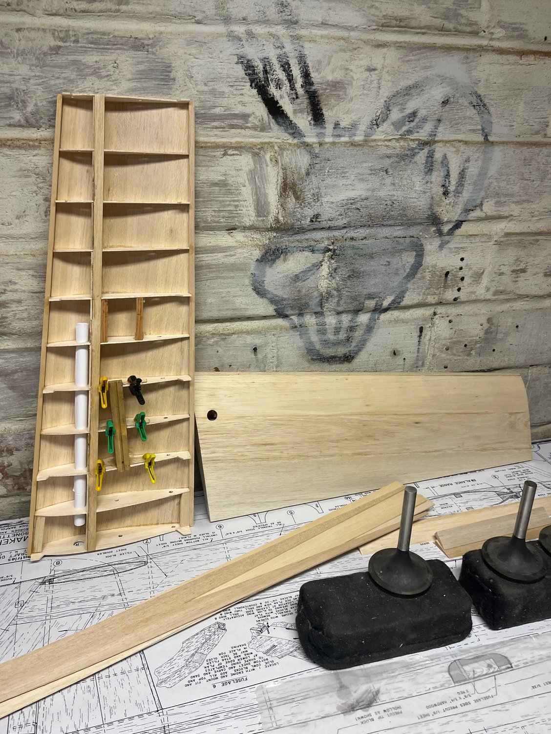

plumberdeluxe 02-09-2024 08:02 AM
Here is the wing sheeted and ready for tips and ailerons. So far so good, more time is obviously needed to search for wood and get things ready vs. a kit that is supplied with everything.
Fully sheeted wing sure makes things rigid and strong feeling………….🤓
https://cimg1.ibsrv.net/gimg/www.rcu...157551ed2.jpeg
plumberdeluxe 02-09-2024 02:05 PM
Here is the other wing starting to frame up…………😗
https://cimg8.ibsrv.net/gimg/www.rcu...d3e4f0565.jpeg
