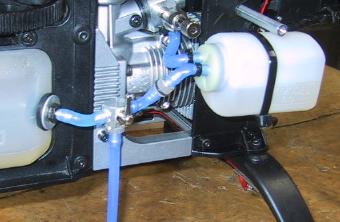

any one got one on c 30 if so u got any tips on mounting it like wheres the best place ( got any picturesof it) thank s

Heres mine.

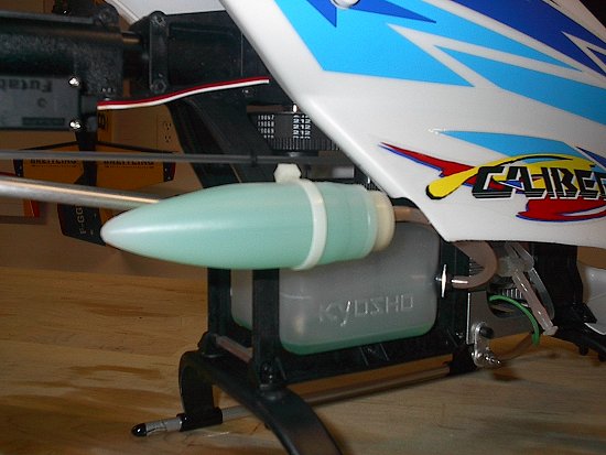

heres mine....

Hey,Hey.. So im intrieged.... This header tank thingie ?? Whats it do ? Does it make the engine run on fumes or something ?? I cant see how fuel can flow through that header tank ? Someone help uz.. I wana work out how it works so I can put one on my RC car... Looks like it draws fumes from the main supply of fuel and mixes with air in the header tank ... then again.. I aint got a clue..lol Someone help

The main tank feeds the header tank through the vent line in the header tank. This way the engine is always sucking fuel through a full tank. Unless of course, you burn the main tank all the way down.

Header tanks on helis serve the very important function of preventing FOAMING of the fuel due to all sorts of out of balance conditions!! They also provide a VISUAL reference as to how much fuel is left. When U see the header tanks fuel line decreasing...TIME TO COME DOWN.
