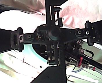

Just did the first flight on the new Corona, finally. The only problem was a vibration most noticable looking at the tail. The frequency seems to be that of the main rotor. It is pretty smooth on the ground but the second that it lifts off , it vibrates pretty bad. I have tried all combinations of dynamic balancing. Is it perhaps a bent shaft?

I had a vibration but not any more.
I found out that the rotor head it self WAS out of balance.
I took off the rotor head and put it on an extra 5/32 shafts I had (piano wire) put it on a high point or prop balancer, WITH OUT BLADES and found it was way off! I drilled a hole in each pitch grip.
One to make it liter and put a screw in the other to make it heavier. Then I made a blade balancer and balanced the blades.
Not only did it take out the vibration but crashes don't seem to bend the shaft as much as before. I think being out off balance made things worse in crashes.

I'll be rebalancing the head on a high point today. I did that the first time and put some little washers under the grip bolt and it balanced pretty good. My vibration must be from somewhere else so I am reassembling the thing.

Sometimes the source of vibrations on this little bird can be hard to locate, I have had everything balanced (including the main gear) and still got vibrations, it turned out to be the drive wire in the tail boom, one of the plastic inserts (bearings) has moved and the slight bent in the wire was making all the trouble

The problem that I had was that one of the subrotor blades was way out of balance. I didn't think that it was possible to be that much difference in something that is semmetrical. Apparently I need to put the head back on the balancer.

Unfortunateley, I cannot pinpoint exactly what smoothed things out, but...I am betting on the cf boom with ball bearings. The vibes went away right when I put that thing on and others have had the same result. I would highly recommend it. Also, after about 5 aluminum booms, it will have paid for itself.

Funny you should ask about shaft straightness. I have a theory, for the moment anyway, that a perfectly straight shaft is not the answer to complete smoothness. I think that having a smooth Corona involves cancelling different imbalances. For example, I have had a perfect shaft and yet I could rotate it 180 degrees, insert the Jesus bolt and cause more vibration. Therefore an imbalance existed somewhere other than the shaft but was somehow related. And, my smoothest operation has been with a noticeably wobbly shaft. So... a bent shaft may be able to actually cancel an imbalace somewhere else (perhaps in the design!!!) This may not make sense and I am still trying to master dignosing the vibes. Perhaps my next Corona will be the educational tool that helps me pin down the causes of all of this.
