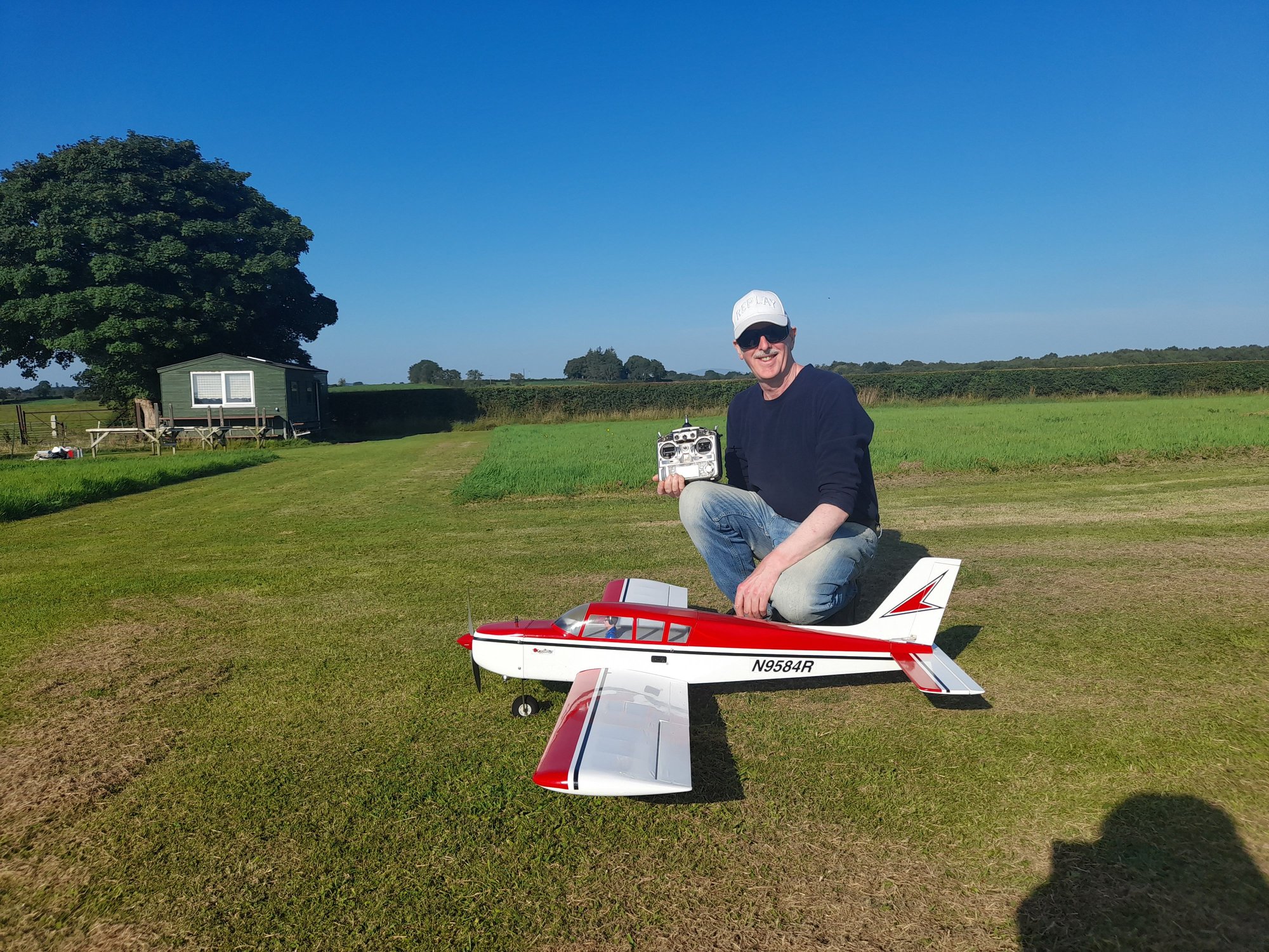

Ive been flying my Cherokee for 10 years now. Its a well built ARF and flys beautifully. I power it with an ASP 61 fourstroke engine and its one of my favourite planes.
