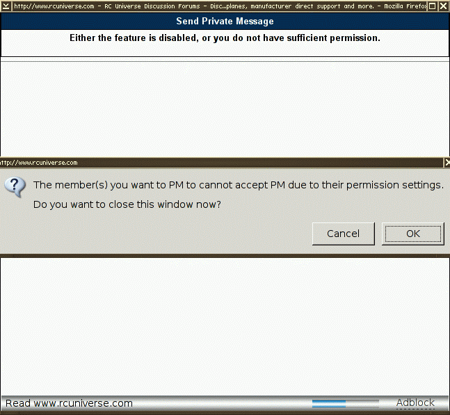

hey PuCkStAr,
I tried sending you a private mail, but doesn't work.....
Anyway, I passed on your e-mail to Gernot.
#2129
Joined: Mar 2005
Posts: 5
From: Perth, AUSTRALIA
Thanks Tve,
I'm not too sure why PM's aren't working. My account seems to be somewhat restricted with regards to options and settings.
PuCkStAr
PuCkStAr

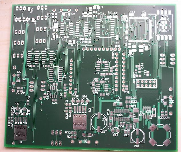

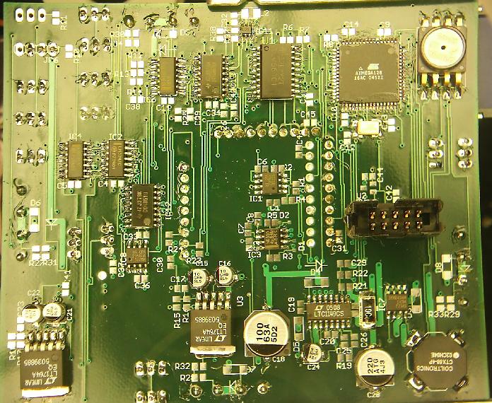

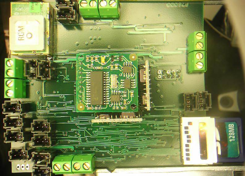

#2131
Hope you guys don't mind me posting all these images
Not quite done yet, but it is going together nicely. I'll finish it tomorrow. One stupid mistake so far.... Somehow I managed to delete the mounting holes before I sent it off. It is going to be real fun trying to mount this thing....
Note that the yaw gyro/acceleromter pair is under the magnetometer... so you can't see it.

#2135
ORIGINAL: ADI
Nice PCBs Tve. Any idea when she'll be flying ?
Cheers ADI
Cheers ADI
I haven't tested anything on the board yet ... so that might be jumping the gun
I will know more tonight after I get home...
