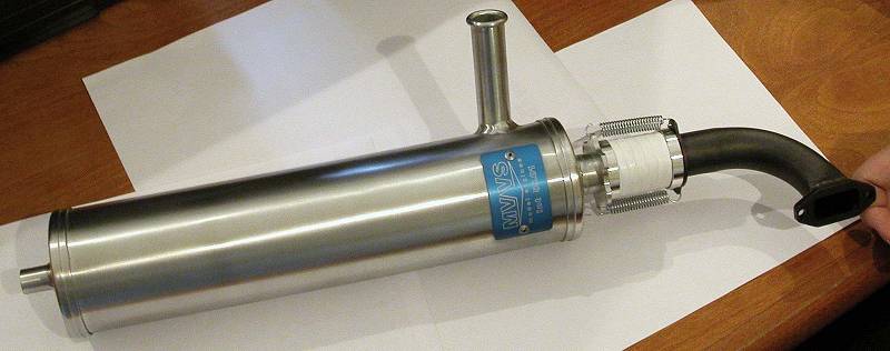

Hi
I have an mvvs 45 IRS with a jen inverted muffler : 20x10 6400 rpm, 21x10 5850 rpm, 22x8 6100 rpm.
I am planning to buy an MTW TD 75 canister. Will this canister improve my RPM, performance?
Thanks for any advice

Desmarets,
The MVVS #3204 canister silencer, with the #3202P/B header will be best for your engine's performance.
It is not as cheap and it requires room in the nose, but it will give you the best power.

Default RE: MVVS 45 IRS
The Jen muffler reduces the 43cc engine's power to a 35! The TD75 improve matters a lot and will give good power. But it will be slightly peakier in the power band if compared to the 3004 MVVS canister.
Pete,
I fully agree with PĂ©.
Not mentioning quality, the bolt-on, wrap-around mufflers vibrate badly and are prone to cracking as a result.
The dedicated MVVS exhaust system hangs on the engine, at its front end and the rear end is mounted to the airframe.
The MVVS 45 cc and all 58 cc engines perform best (by a lot), with an exhaust system that was designed for them.
Only the #3204 (with either the 3202/B, or #3202/P header) fits this description.
MVVS also makes the #3202/I header for the JMB 80, but there is no reason to prefer it over the original MVVS set.
