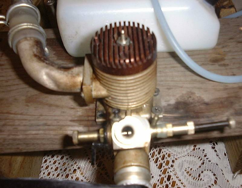

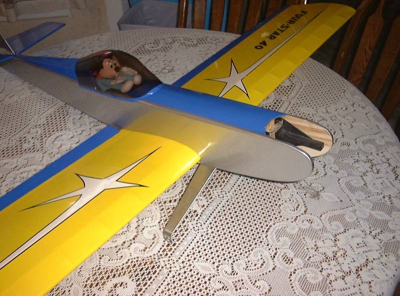

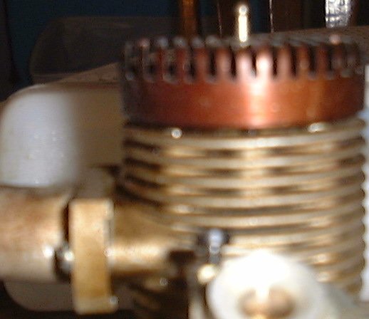

here is a few photos of my 6.5

Dennis,
This engine is at least 10 years old.
It seems that was a red head.
If it says '6.5' on the side (it is not in focus), it is a normal MVVS .40.
It has a (Macs) tuned pipe, which when adjusted properly, will give you more power boost than the tuned-silencer/mini-pipe.
That tuned-silencer will give you a better response, but with that Four-Star you don't need 3-D like response.
That old, blunt-idle-needle carburettor will hamper adjustability and response, however.
Old 07-06-2006 | 11:34 PM
horace315's Avatar
My Feedback: (15)
Joined: Sep 2003
Posts: 715
From: va beach, VA
Default RE: Prop for a MVVS 40
is there an alternative type carburetor i could use?the high end adjustment needle seems like it would vibrate loose.also is there any place i can get a parts and maitence manual?
Old 07-06-2006 | 11:48 PM
DarZeelon's Avatar
Joined: Apr 2003
Posts: 8,913
Received 6 Likes on 6 Posts
From: Rosh-HaAyin, ISRAEL
Dennis,
If you basically know how to adjust a glow engine, you need no manual!
Just use fuel with 20% oil, of which at least half is castor oil.
Always run the engine dry, by removing/choking the fuel line at full throttle, at the end of the day.
After-run oil is extra insurance.
Adjust the engine to run at peak, 100-150 RPM richer than maximum, with the plane's nose pointing straight-up.
This means about 300 RPM rich with the plane level, but check it with the nose up!
This engine needs no maintenance as such, but disassembly requires metric Allen wrenches.
That new carburettor is available from MVVS dealers.
Unless the 'clicker spring' isn't functional, that high-speed needle will stay put...
