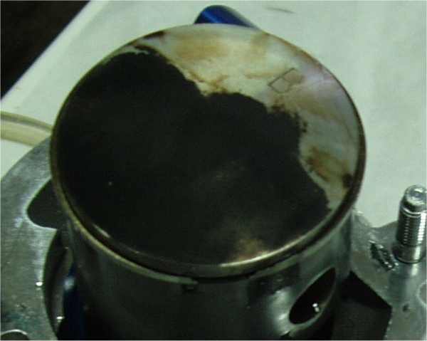

Unfortunatly, I crashed my Edge 540 yesterday. Some dirt came into the engine, so I had to disassemble it for cleanning and I found some things that I wold like to comment with you.

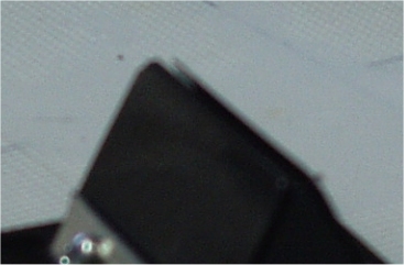

The first is that one of the carbon fiber sheet is join to the box but the other is a bit open. Is this normal? Can it affect the normal working of the engine? Should I be worried about this?
Second: The piston is semi-covered with a black wrap. I don't think this is good ... I must be doing something wrong... I'm using 98 gas + Mobil1 rancing 2T at 3%. The engine has about 10 hours running and until now it worked great. Menz 24x10 and BCM pits muffler.
Third: Probably, it'll be seated for a long time. Taken this in consideration, which actions should I take to prevent any damage during the storage? Nowadays the engine is completly reasembled and before that all parts were cleaned with normal flying mix. The upper part of the piston was also carefully cleaned with 1500 sandpaper.

don`t worry about the fiber reedvalve. It`s quite common not to get the fiberpetals to completely close to the box. It doesn`n matter, cause when the piston travels to the top in the cylinder, the reedvalve is all open and as soon as the piston starts its down stroke the fiberblades smack down tight and seal uo the crankcase
The carbon reed question is already answered. If starting is good, the reeds are OK
The black piston crown is an indication that your mixture has been a bit rich. It looks OK though and nothing to worry about, and it will not harm the engine. In fact, it isolates the piston from the combustion heat, and should only be slightly smoothed for best engine performance.
If you store the engine for a longer period, a few drops of oil here and there , especially the bearings and piston skirt would be the right thing to do. Normally this is done on assembling the engine, when all parts are accessible.
