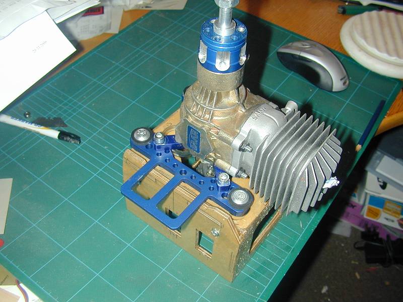

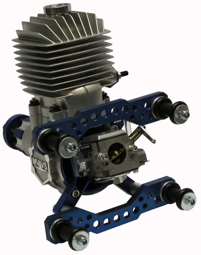

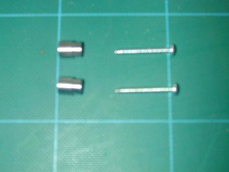

I have the isolation mount and a very good piece of kit it looks, but you have got me, what is the Assembly sleeve and wood screw for. pic below.

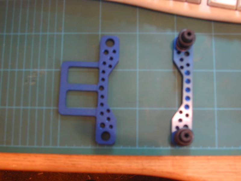

For those who do not know what it looks like I have posted a pic of an engine mounted to the standard mount, the pic on my bench is the mount with the ignition module support.

Hi Mike,
These are assembly tools that help to secure the assembly to the firewall when setting up the engine with the right thrust lines and cylinder angle. Once all drill hole positions are defined and drawn, you can put these in your tools box.

Ah the light dawns, so you just use these as a temporary fixture whilst you finalise the postition.
Thanks as always usefull information and quickly replied.

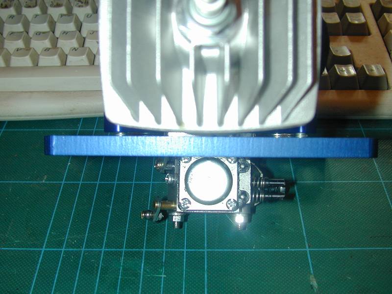

Pic shows that its not possible to bolt the engine to the iso mount without spacers as the bulge at the back of the crankcase/cyclinder liner which I assume is a transfer port sticks out too far, nothing that a couple of washers will not cure, but it does mean the bolts supplied are not long enough.

There's two ways to mount them. Alongside the bulge, or across the bulge. One of the two ways won't fit, and the bolts will be too short

Yes you are quite correct, unfortunatly if you fit the cross beams vertically in relation to the engine you end up with the members in front of the exhast which could be a problem if the bend off the stub needs to be tight to accomadate a narrow cowl, should not be a problem on most installations with standard manifolds however.

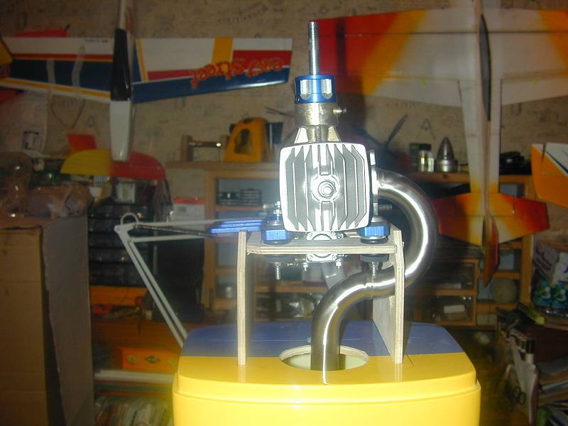

Just thought I would show the instalation of the ISO mount on my Edge, you can see the thrust washers on the right hand side and the ingnition bracket on the left.

Looks good Mike, Rear mounts are so easy to get the thrust lines ok.
I wonder how you gonna fit that Yak in there.

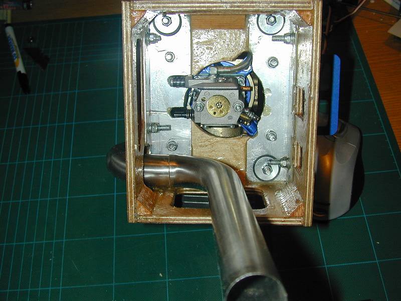

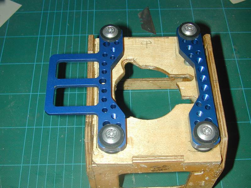

Couple of pics showing the ISO mount and new motor box constructed for installation in my new Extra, this will hopefully reduce noise even more.

Things are shaping up well. The header length is right with the canister as much as possible in forward position, and the teflon coupler fitted right after the last pipe bend.
