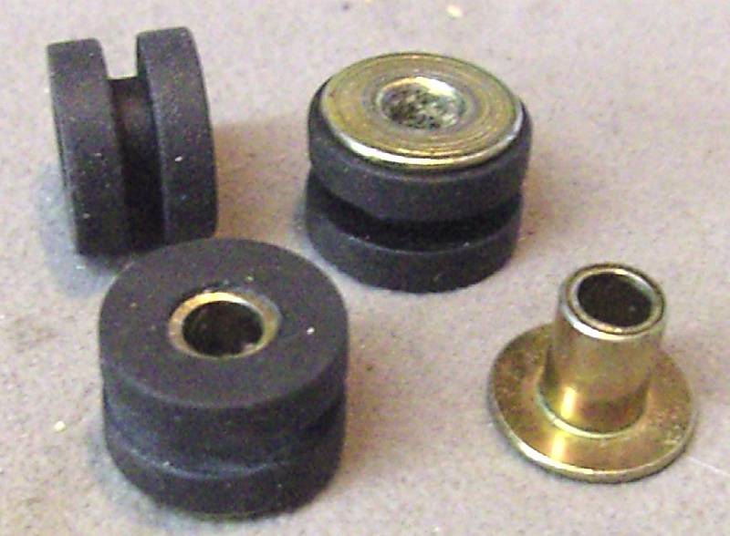

Mike, you have the engine upside down and so is the carb.
re-fit the rear cover at 180 degrees, so the carb is no longer upside down, and slants downward towards the engine. Open the needles 1.5 turn again, and start from there.
Here is a picture of the iso grommets

The ISO mounts look interesting, the only difference between yours and how I have done mine is the sleave, are those available commercially.
