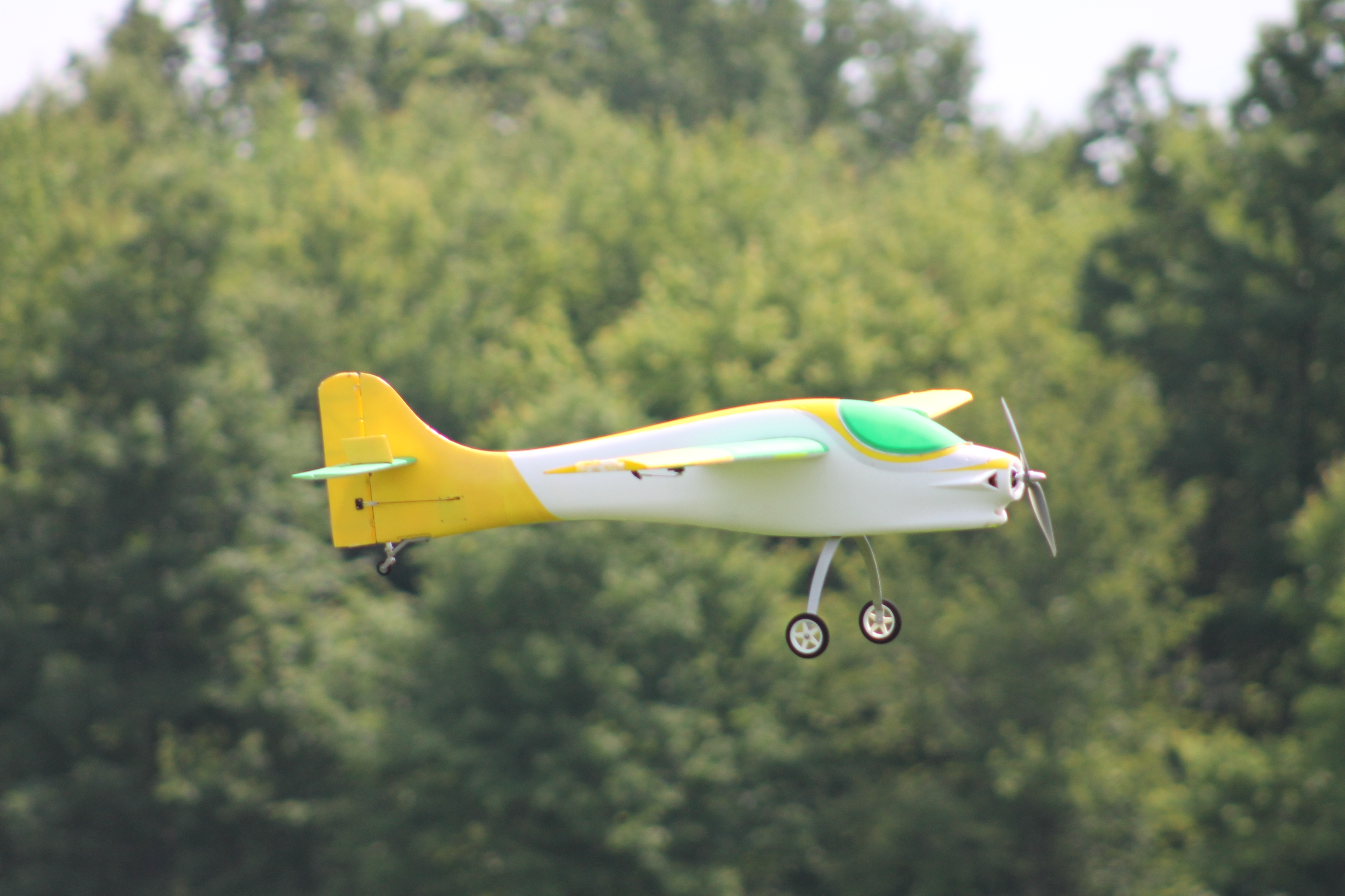

Old 09-04-2014 | 11:25 AM
Banned
My Feedback: (8)
Joined: Jul 2009
Posts: 7,269
From: Hartford, CT
Make it a taildragger, no more issues!
