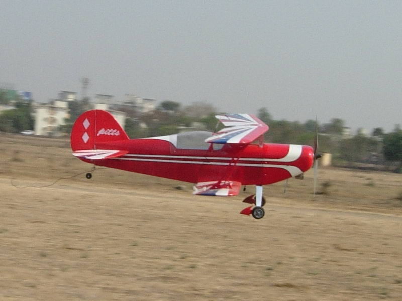

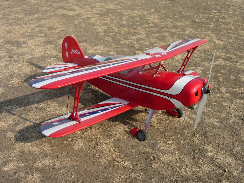

Hi there,
Here is my update for the Pitts too. I had my test flight last week and it was beautiful , very peaceful flier. I have powered it with a os70 4 stroke and it balances the plane at 3.1" from the LE of the top wing.
My Ailerons are at 50% throw so its not twitchy and flick dual rates for a sweet roll. The plane will not knife edge without a lot of aileron mixing so dint get to try that
The os70 is ideal power for it and not too powerful. The plane has ok sink rate and will land slowly and smooth. I also had a dead stick and knocked the LG out taking the support out from the fuse. I guess if it had been stronger then it would have broken it. The LG does not flex backwards so it pulled it out.
Also a major mod I had to do was to have to reduce the length of the cabane struts by about 10mm ... yes i had to cut them and drill them again as the present length if put just wouldnt fit. I am surprised as i did not hear anyone else needing to do this mod.
Other than that I would say this is a BEAUTIFUL PLANE. GET IT and enjoy
Cheers
KJ

#31
ORIGINAL: kamikazejoe88
This with a tiny bit of bending, of the carbanes, fixed the height difference.
In other words I made the struts slightly "wider" and thereby lower to account for the difference.
I haven't maidened my plane yet.
Mine is powered by a T.H. .46 2 stroker using a Bison Pitts Muffler.
With an 11x6 this engine HAULS on my Ultimate 40S, so I was considering putting on a 13x4 prop on this plane to slow it down a bit.
I also ended up NOT inserting a spacer for the wing struts.
Rather I installed them as is, then I used thin CA on the base of the strut supports to harden them in their new canted position.
This worked rather well.
#33
I am using the HS81 servos.
Cool pics, nice shots
O'my GOSH!
There's NO PILOT!!!!
I ended up with a white plastic 2 1/5" spinner on mine to match the scheme... It looks pretty good with it.
I don't see a charge receptacle or switch in the pictures. Did you add one?
Also any idea as to what the intent was with the mounting holes on the servo plate, for what looks like an inner switch?
I've been trying to figure out what is supposed to go there.
