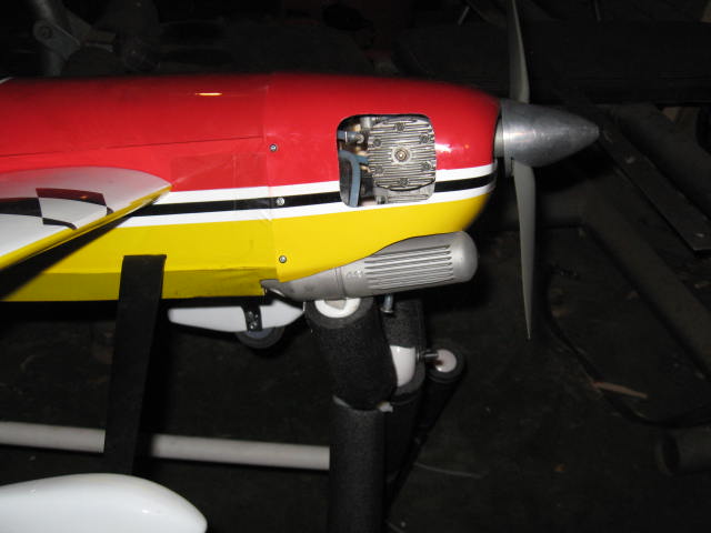

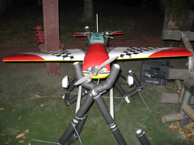

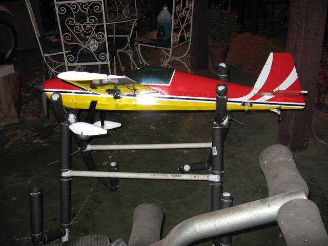

i know in the manual it says to set thew cg from the wing root leading edge, how many mm's would it be from the wing tips.... BTW its a great lil plane, its so light compared to my other similar sized planes, and built well,....... the only couple of things i didnt like were the wheel pants and some of the hardware, but thats usually the way arf's are anyhow. Im done withe the plane and cant wait to maiden it, i just need to figure out to mount the deans whip antenna ohh yeah i goofed on the engine cut out hole in the cowling before i get flamed
powered by an os 61fx
hs 255mg mighty mini on throttle
2= hs 945mg's ailerons
hs5925mg rudder and elev.
1500 nimh battery pack

I guess I am sorta old school and still flip a plane like this upside down and balance it on my finger tips near the fusalage. When I first flew the plane I ballanced it at 4.25 inches back from the leading edge. It flew fine and was balanced there for my video. Since then I rebalanced it at 4 inches (closer to the 103 mm the manual calls for (103mm/25.4=4.05 in)). I think it is a little less snappy (read as scary) this way. But it still does the nice spins and tumbles. With the tappered wing, I am not sure what the balance point out at the wing tips would be. Good luck and I look forward to your flight report.
