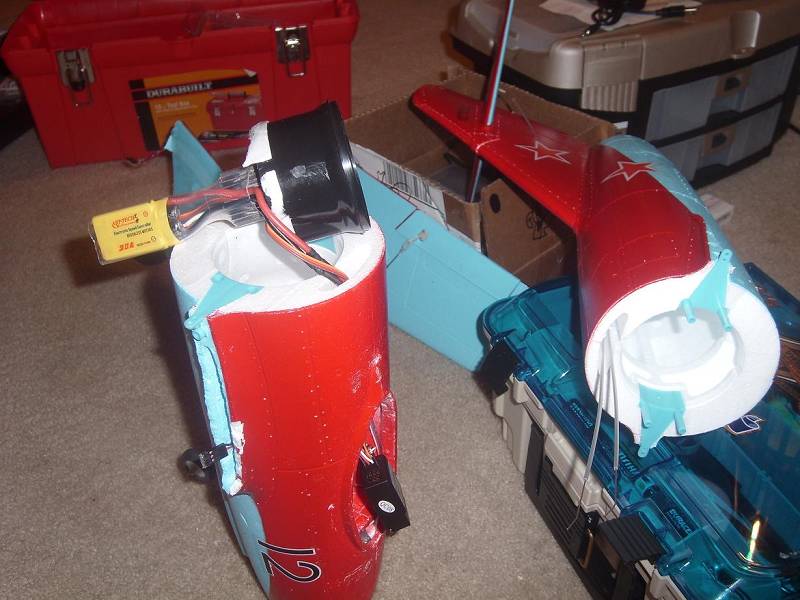

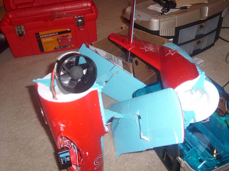

I noticed that there is a blinking light in the esc when the Tx is off, when I turn it on the light disapears.
I disassembled thr Mig15 as you suggested in out phone conversation. (Btw, Spoke with another guy at support, he left you a note to call me back)
I took 3 picture of the Mig , so you can see the Mig-15 with its guts open. All connector look good, but motoe still does not work. NOt sure how to attach it to this post. Maybe I can Email them to you.
John, I am looking forward your call, no one contacted me from NitroModel as promise in various Email.
The long weekend is almost here, and my MIg-15 I got from NitroModels is grounded! [&o]
Dvir
