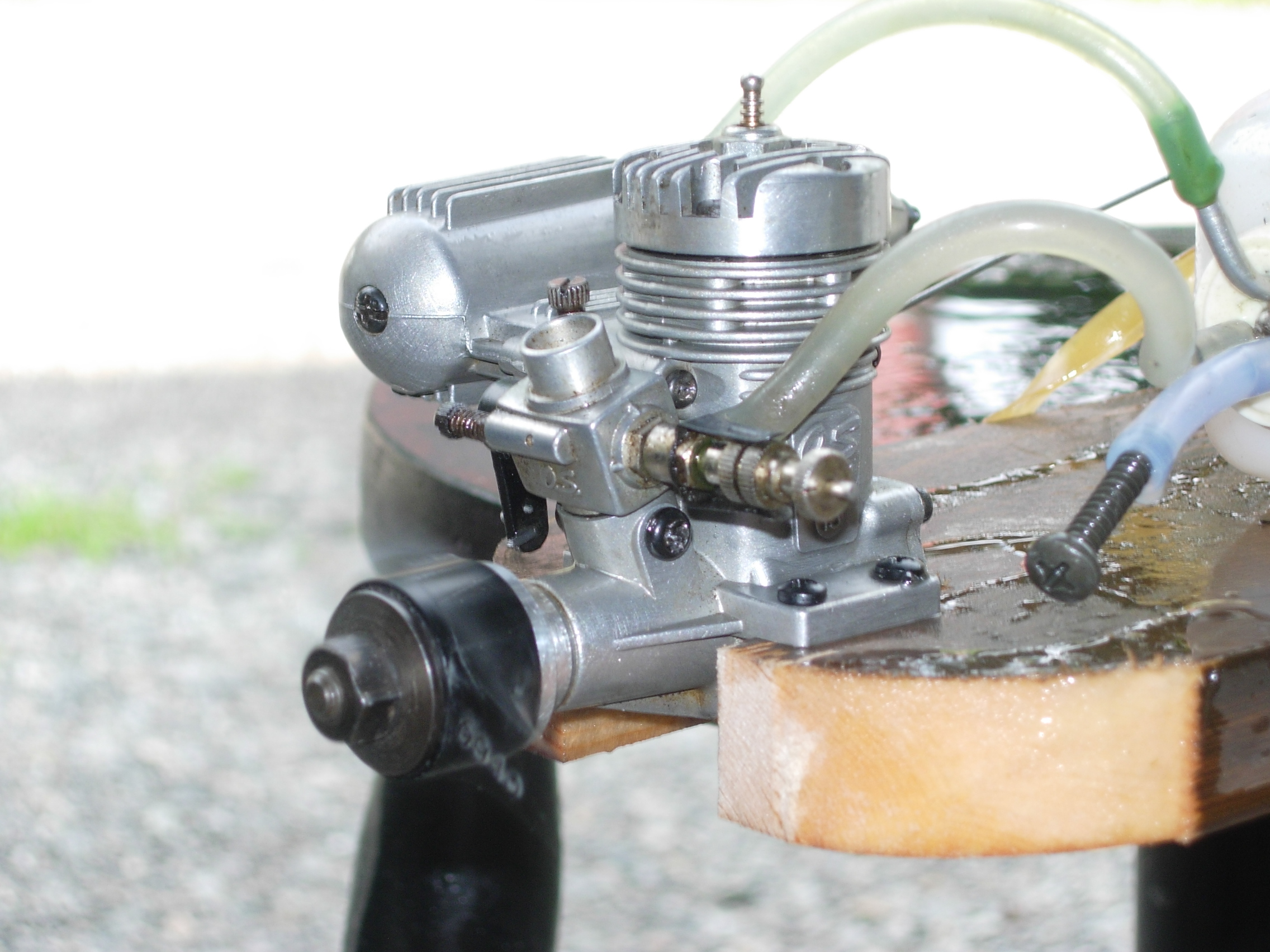

Love those old ones! 15 years or so,stuck solid.Now in my Mambo.
