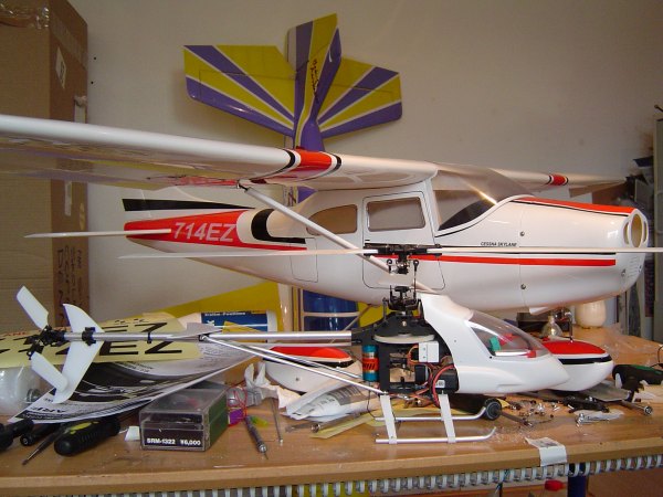

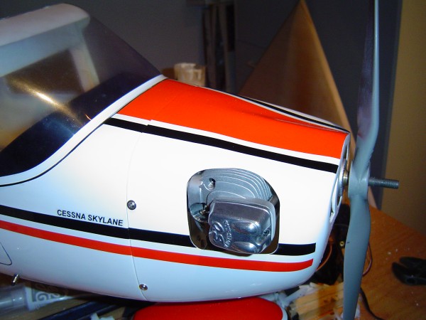

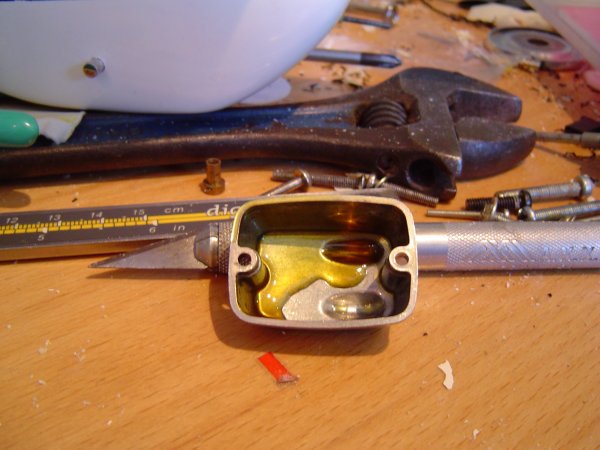

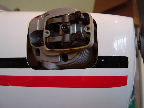

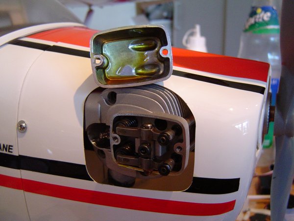

I have only run one 400cc tank through my engine at the moment, and mine seems to get plenty of lube in the cylinder head. I have set mine up as stated in the instructions.......lets see how it holds up

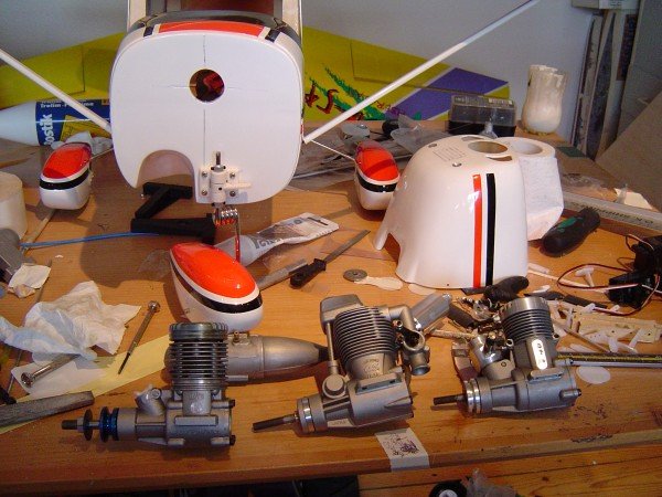

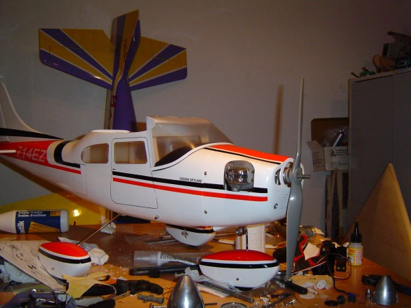

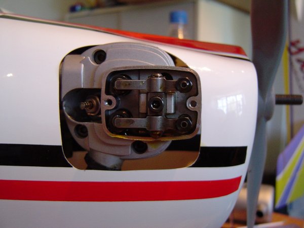

I just completed my GSP Cessna with FL-70
I hope it doesn`t wear out as quick as I have read about the others here in the forum.
