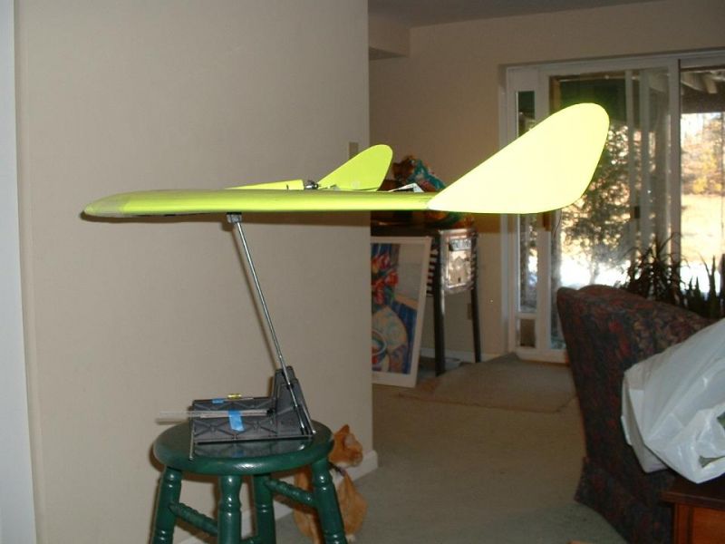

Sounds like you are tail heavy and tip stalling, over correcting then nose crashing.
I think it's important to get your COG mark correct before you hit the field. If you don't and are a new flyer or face less than ideal conditions you will crash. Great planes sell a COG machine. Sure you can build em yourself but it will be hard to duplicate the friction free pivot points.
Here is my Unicorn balanced correctly. It also flys level like this when the hands are off the radio sticks. I balance my stik, scooter, sailplane, wings, Tiger Moth, etc. with this device.
For more information and pictures:
http://www.rcgroups.com/forums/showt...ht=COG+machine
Post#10

Get a firebird. If I can fly it then anyone can. They really are easy to fly. When you are a newbie though you HAVE to make sure as with any electric plane not to fly in much wind at all because it's bound to get high and far away from you real quick. The firebird II is just a wonderful little plane. I think it's called the Firebird II ST or XL now. I actually got good enough with it to even do loops,, something it's not supposedly able to do. Took some practice and some mishaps but I did it
It has since been retired due to a simple fall out of a walnut tree when it broke it's rear tailboom assembly. It's taken a tremendous amount of abuse so it's time had come I guess. Now I'm stepping up to a predator.
