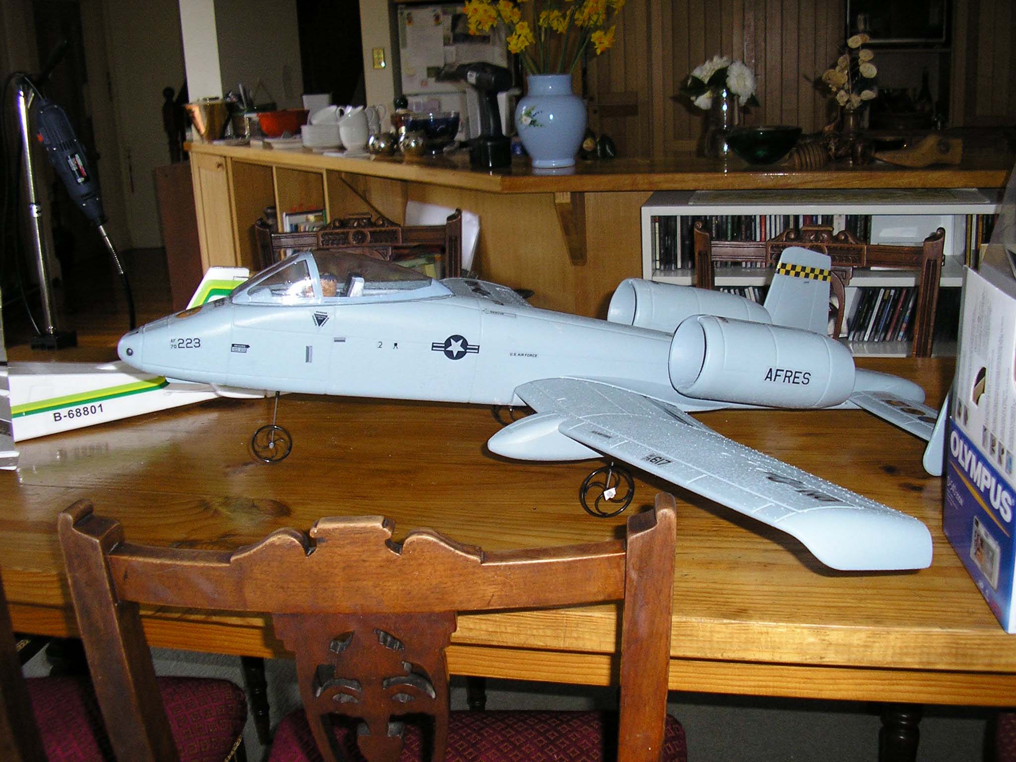

Hi everyone,
I currently have three GWS planes, bn2 islander, stick and A10. I just finished building the A10 and havnt flown it but i have had a little trouble with construction and i want to clear this up before i buy a formosa most likely and install my himax 2025 4200.
Firslty, with the A10 and the bn2 i found the ailerons very difficult to install. I cut very neatly and installed the plastic hines neatly but there was a definite lack in stability and movement. I found the foam was twisting from one end to the other so i may have had full aileron down at the control end but the other end was only down 1/4. They were quite stiff also. I used the stock glue as i heard it handled the hinges quite ok. Seriously though, are they actually worthy of being called hinges? All they are are strips of plastic paper.
Another problem occured on the ailerons as well as the elvator. The metal wires that go inseide them to move them (sorry about my lack of proper terms) appear to cut throught the foam and become loose, at the back of the plane the differnt sides of the elevator have differnet rates of movement. Should i have a pushrod going to each side?
As you can see, i'm a bit critical of foam planes, is there any way to add a shiny hard surface to the outside of one of the foam aircraft???? i don't want to admit to getting another one after what ive been saying about them recently.
Another issue, i intend to run it on a 10.8V 700maH li-on pack i have from my dragonfly heli but my speed controller does not have programmable functions. To avoid overdraining my batteries, (i may also use 2s 1500maH kokam li-po packs i have), mainly the 10.8V, how should i go about it? i have heard of people timing flights and my eclipse 7 is up to the task but i don't have the faintest clue how long i should fly for.
I have some GWS micro retracts( think they're micro, they are the blue ones) that are intended for the formosa.
Any help would be appreciated. For any newcomers, it's really not that bad even after what i said,
Josh
PS. a picture of my beautiful A10 (needs better wheels!

I have a GWS mustang and had similar issues as you did. This is what I found out:
Finish
There are many threads on "glassing" foam airplanes to add strength and a smoother finish. The down side is they add weight. If you have lots of power (brushless) and can handle higher landing speeds it's not that bad. Decide what you want - appearence or performance.
Hinges
The supplied GWS paper hinges are actually quite strong. I did unscientific destructive testing between them and Dubro nylon hinges and the GWS were stronger. The stiffness is most likely extra glue or too tight of clearence between surfaces. Try some oil or baby powder to loosen em up.
Foam control surfaces
These are parkflyers. I too was concerned about the unprecise nature of foam surfaces. Mostly, its not a big deal if the inboard side deflects more than the outboard. This prevents stripping micro servos anyway. Over time the foam will wear away and stretch where the control rod goes in (bad). Balsa is a feasible alternative for not much extra weight. I cut small spanwise slits and then insert CF strips which are then drilled to accept the control rods. So far so good.
The split elevator however is a BIG problem. In any type of load situation the elevator halves deflect different amounts which introduces a rolling moment which is VERY annoying. There are threads on how some have used dual control rods but that seems heavy. It needs to be stiffer but I have not solved that one yet.
Lipos are very sensitive to over discharge! I've toyed with the idea of timing flights on my non lipo freindly ESC's but have so far chickened out. I suppose one could use motor calc or similar and figure out the "normal" flight times for a particular setup and then decrease that by a bit to have a safe margin. Seems like a bit of an unacceptable risk to me for an expensive batt pack - but to each his own.
That 3s 700 Mah Lipo pack you mention won't sustain a very large amp draw either. I'm guessing under 6 amps continuous. That leaves a kinda marginal setup using a gearbox or prop combination to keeps the amps that low. The 2s pack may be a better bet even at the lower volts. You'll have to look it up for your setup.
http://www.parkflyermotors.com/secur...or%20Chart.xls
Hope that helps.
BTW I am not by any means an expert on this stuff.

You might try taking a small control rod (spring wire), bend it into a "U" shape with the curved part actually straight and attach one leg to one half of elevator, the middle next to the horizontal stab, the other leg onto the other half of the elevator. I just ca'd it to the park flier I built, but, you could press it into the foam elevator. Worked good for me.

I had this problem on some planes I fixed it by adding a slight strip of aluminum to the elevator. It is very easy to do and you can get it at Home depot or lows as roofing flashing. Glue on w/ a little epoxy and it eill be very tough. I also used this to correct problem with breaking rear stabs and horz stab. By bendinr small pieces at a 90degree angle and gluing down. If you have plenty of power, you'll never feel it.

yes i had a simular problem, they ended up being a little harder to move than normal, but they eventualy losened up and are fine now.
With the elevator, i find the side not attached to the servo has a little to much free movment, so that side will not move as fare as the other side, should be an easy fix.
BTW, it still flyes well.
