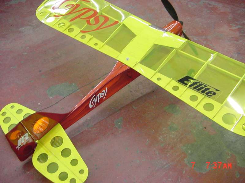

I have just recently bought the Eflite Gypsy and let me just say no more parkzone. I love how this thing fly's very responsive and plenty of power i am using a gws 350 motor with a 730aaa nimh pack. Flight times are about 10-12 min. Just a word of caution do not use the stock motor from eflite it is like putting a 4banger in a cadilac sure it will run but just. Has anyone else had a chance to get there hands on this bird if so lets hear what you have to say about it.

The Eflite Gypsy is a very well built and very stable plane. It would make a perfect second plane I would not recommend it to the beginer if you do not have any building or covering skills.
35.25 inch Wingspan
Flying Weight is 18oz.
Comes with geared 5.33 370 motor with 10x4.7 prop
I do not recommend using the stock motor it didnt last past breakthrough it locked up in the process. I use a gws350 motor with 12 tooth pinion retimed 8mm advance will give you approx 20% more power with no side affects of motor wear or overheating.
Radio used is a parkzone unit from a j-3 cub.

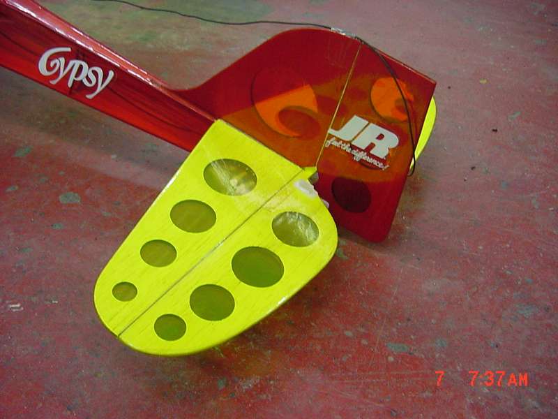

Building process was pretty straight forward when attaching the rear stabilizer cut less than what the instructions say or you will have bear balsa showing test fit everything before making any cuts in the ultracote.

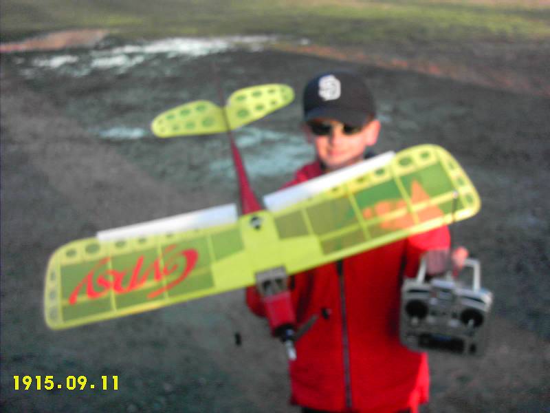

did something a little different in the "Gypsy Skunk works." I inherited the plane from a neighbor that wanted my ten year old to have the plane. after several frustrating attempts to fly it with the stock set up, I made some changes
Took out the stock engine, and went with the Park 400 (yes it is overkill). I opened up the internals and made room for a 3C 2100 lipo. I added an additional servo mounted on the top of the wing in the wooden center section near the back. This controls two control horns that operate a small set of ailerons i fashioned out of some spare thin foam. It flies extremely well and my 10 year old soloed with a smile.
I took it out one day at lunch and had a battery problem shortly after take off. I was a little slow on the switch and was counting on having the extra power to handle the big winds I was flying in. the gypsy bought the farm, and is very trashed (wing is fine) with all of the front destroyed. Thought about throwing it out but I think I will rebuild over the winter. The extra power was helpful in getting my son out of sticky situations, and the extra weight helped it in the wind. flew great with the cargo
