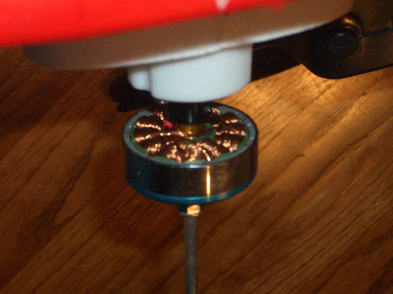

Once again, the prop is 10 X 47. Here are the pics:

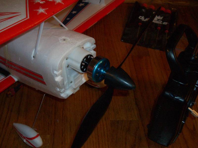

Here's another.

why is the shaft covered in rust?

I wonder if this is the same motor from China? I believe that it may have come in a few slightly different varieties in the last few years.
I hardly know anything on this motor(if it is the BP-21) except for it not being a very good performance motor for Stryker.
When on 3S it should be somewhat better than the stock 480 brushed motor of F-27B , but on 3S it'll need a smaller prop than that 10" unit (7" to 8" range diameter?).
Here is one:
https://www.unitedhobbies.com/UNITED...idProduct=4321
That motor is rated to run the 10X4.7 prop on 2 cells lipoly, see bottom of that page. Same prop as you mentioned above.
If you have a 1300mAH-2 cell lipoly battery; that is not good for a Stryker. Tell us the number of cells or battery voltage.

The shaft is not covered in rust, its just the lighting. Also, i have a 3 cell 1300Mah Lipo. But like i said, i dont need the power to do aerobatics, i just want it to fly. So, could i use the extra power from not doing 3d to get a bigger plane but then use a higher % throttle for flight???
