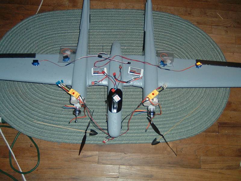

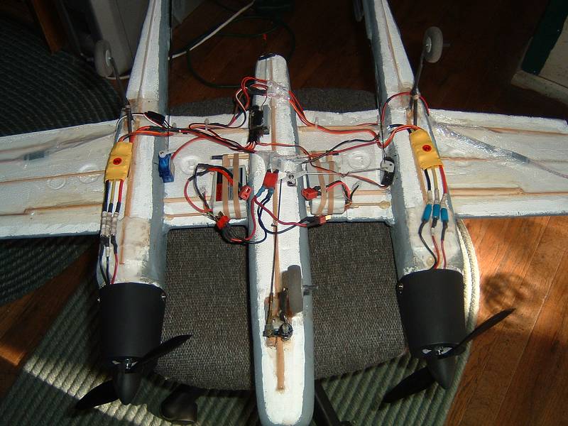

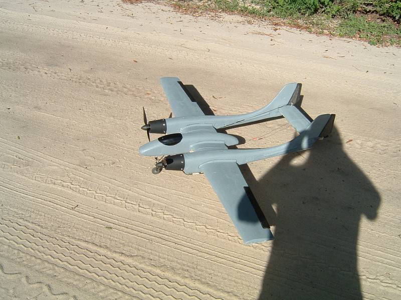

ponchoyo::Heres a simple set-up on my foam glider conversion, It's not to hard, good luck, your bub, scoooper

That's quite the hot glue job....did none of that fit inside??
I'm sure it flys great ....but....look at it...[sm=72_72.gif]

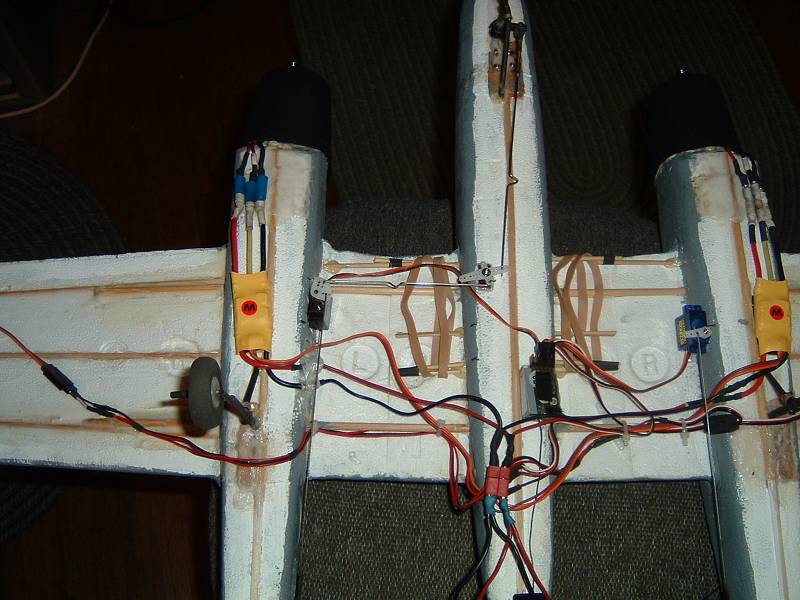

Are you using a Y harness for linking the ESCs together into the receiver? Its hard to tell with all the wires running crazy everwhere. But thanks for your response scoooper[8D]

ponchoyo::I make all my own Y-harnesses most the time Ex's too, the deans con Y is for the two 3-cell1600's, if you'll go to the GWS site an look up the P38, it shows the set-up for twins in great detail , your bub, scoooper PS RedGN:: your right , she fly's like she's on rails but I don't use hot glue, epoxy& ape glue's the hot set-up, I've built a mess of theses things,
