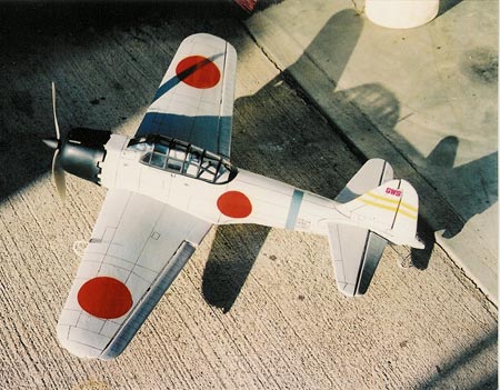

I just finished my GWS Zero today and went for a flight. The plane climbed when tossed and then rolled inverted left and crashed into the ground, I did this twice and decided to call it a day while the plane was still flyable. Any thoughts on the model. I have added some weight to the nose to get the CG behind the spare, but really not sure what the problem is. This is my second warbird, my GWS P51 has some issues = so I got the Zero since I heard is was a bit easier to fly.

Mine took alot of nose weight and the c.g. should not be behind the spar but on it or slightly in front of it if I remember correctly. Sounds like yours is tail heavy and she stalled out and rolled to the left

The Zero is an awesome plane. I went through the same problems my first flights. Wrote to GWS they said instructions for CG are wrong. Should be 45mm to 55mm from LE not 55mm-65mm.

I had a similar problem to yours with my GWS p51. Two things solved it: nose weight and epoxy in the ailerons. Check your ailerons to be sure they don't have too much slop. If so drop a small amount of epoxy down in the torque rod hole in the aileron. If the hole is the slightest too big it will make the airplane extremely unstable rollwise. Just a thought.

Hi Guys, A couple friends of mine bought them two planes, the Zero and the P51, same problem. What they did was move the battery ahead by cutting out the fire wall. I flew the Zero last weekend and it fly's great. I don't recommend adding weight to them small planes. Good luck and happy flying.

I have both a Zero and a Mustang, fantastic planes!
You need to do a couple of things to make the Zero fly well:
Set the COG as per the build manual. Mine is set at 60mm from the front of the wing.
Move the battery pack down onto the wing. I cut the battery tray out completely. This might mean having to move the aileron servo back, which I did.
Set the elevator so that the bottom of it is in line with the bottom of the tailplane. (trimmed down slightly in other words)
It will then fly very well. My Zero is the best plane I have ever had, it flies like a dream.

Thanks jham,
Stock EPS300 4.43:1 (B) gear ratio with 9x7 prop.
The motor is retimed by 10mm, which makes a BIG difference.
Batteries are 8 cell NiCads (9.6volt) 600AE.
It's a magical plane, and very realistic, my favorite of all the planes I have ever had.
