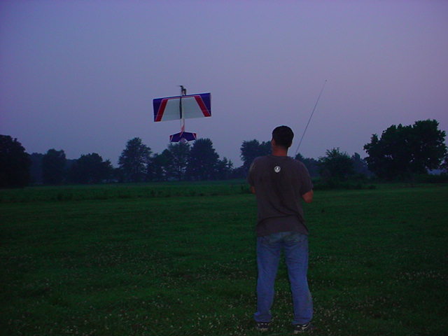

I have an ARF Knife. Although I can hover this plane, I cant seem to get it to spin on the prop. I have a TT Pro 46 w/11-4 ASP. Is the secret in the engine prop combo, or ???????

feed in a little aelerons at the start and it should start to go and you have to keep blimping the thorttle and it will help it around!!

If you want to torque roll you'll have to cheat a little with the ailerons. Of course if you use any ailerons what so ever then it's not a torque roll. It's just a stationary vertical aileron roll.
My Knife won't TR at all. It might make a quarter or half rotation and then it will stop and sit there.

try adding a little right thrust....a coup washers under the to front engine bolts should help......G

You have to find "perfect vertical". For your Knife, that's just a tad on it's back.
If you try descending a little while hovering, that will definitely help it roll. It's harder to hold the tail under the prop, but it will roll.
If there is wind, you have to be going with the wind. Can't hold it stationary if there is wind and have a torque roll. Has to be NO wind relative to the airplane.
Try an 11.5x4...
Kick in some aileron to cheat.
The real solution is more torque...That means a 4 stroke like a Saito .72 or YS .63.

Your knife should tork roll easily without cheating. you must keep it 90 degrees + or - very little. If it tilts forward or back it kills the roll.
Try backing it down in a tork roll, it will spin so fast it will water your eyes. :stupid:

That's because you've got perfect vertical when it starts rolling, but not when it stops. That is why it stops. You're either falling a little forward, a little back, or a little to the side.
As far as the prop for torque rolls, it really won't make much of a difference for the roll rate. The 11.5x4 will just give you more thrust...

That sounds possible. I'll just have to get better at holding vertical .
