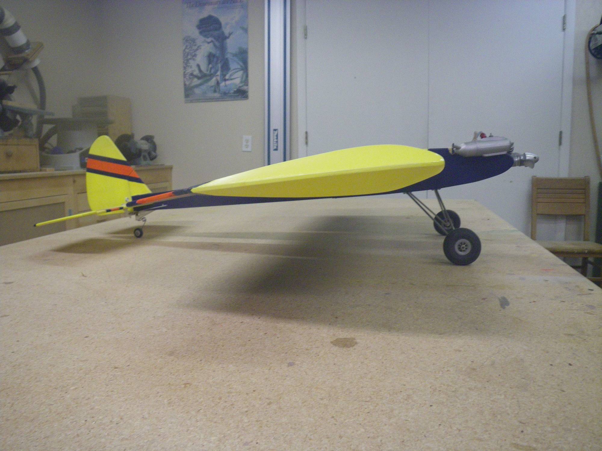

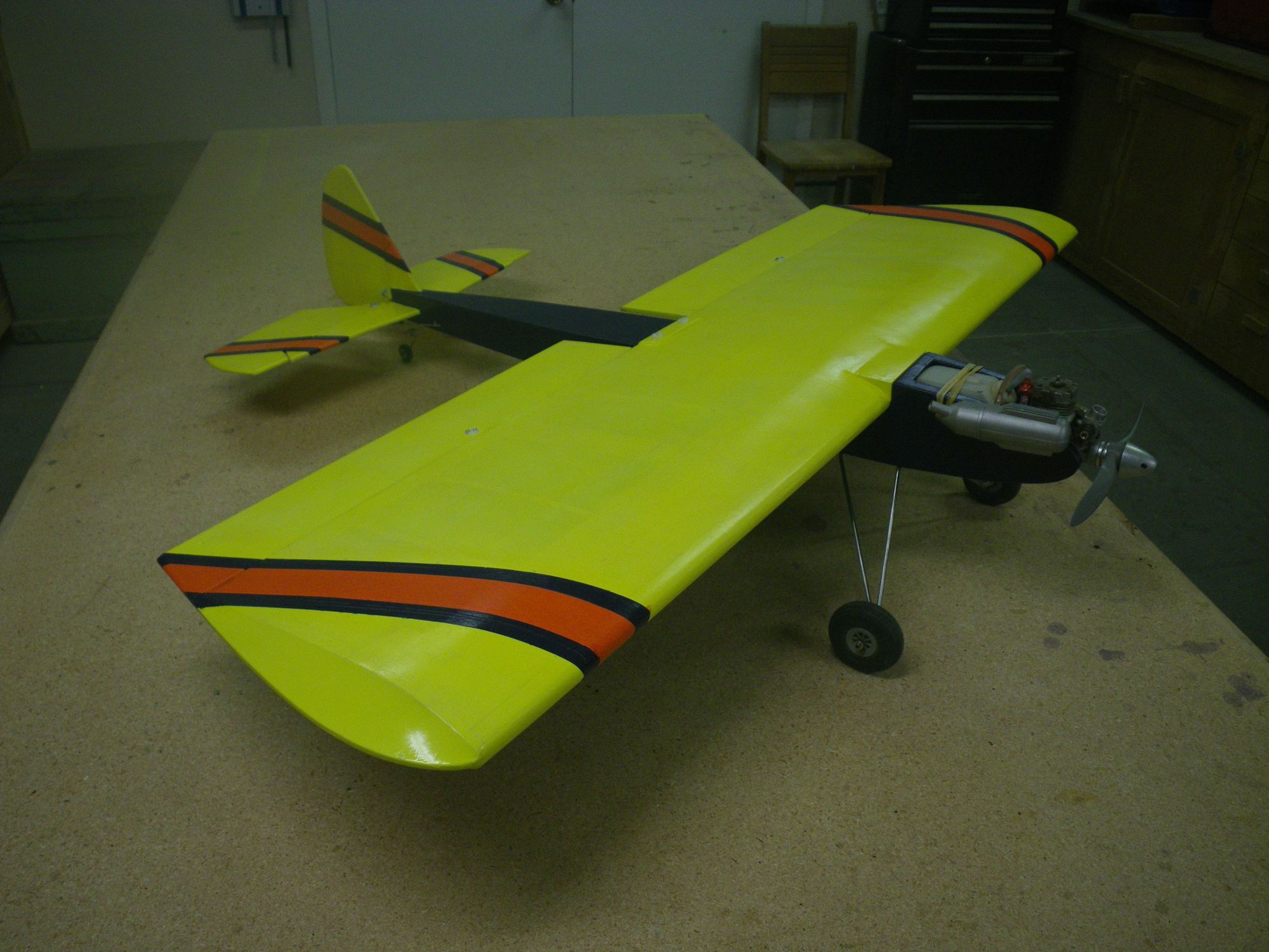

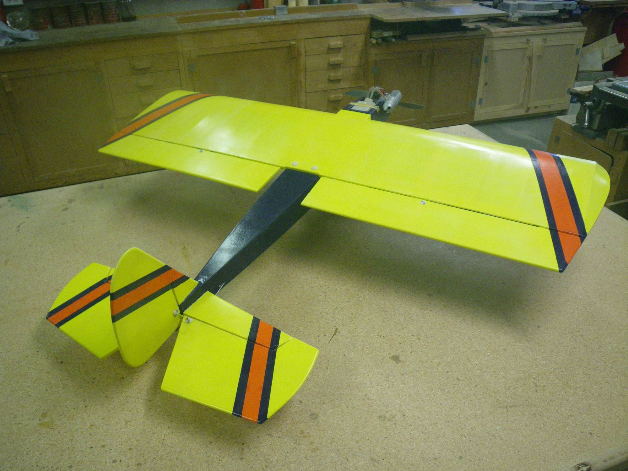

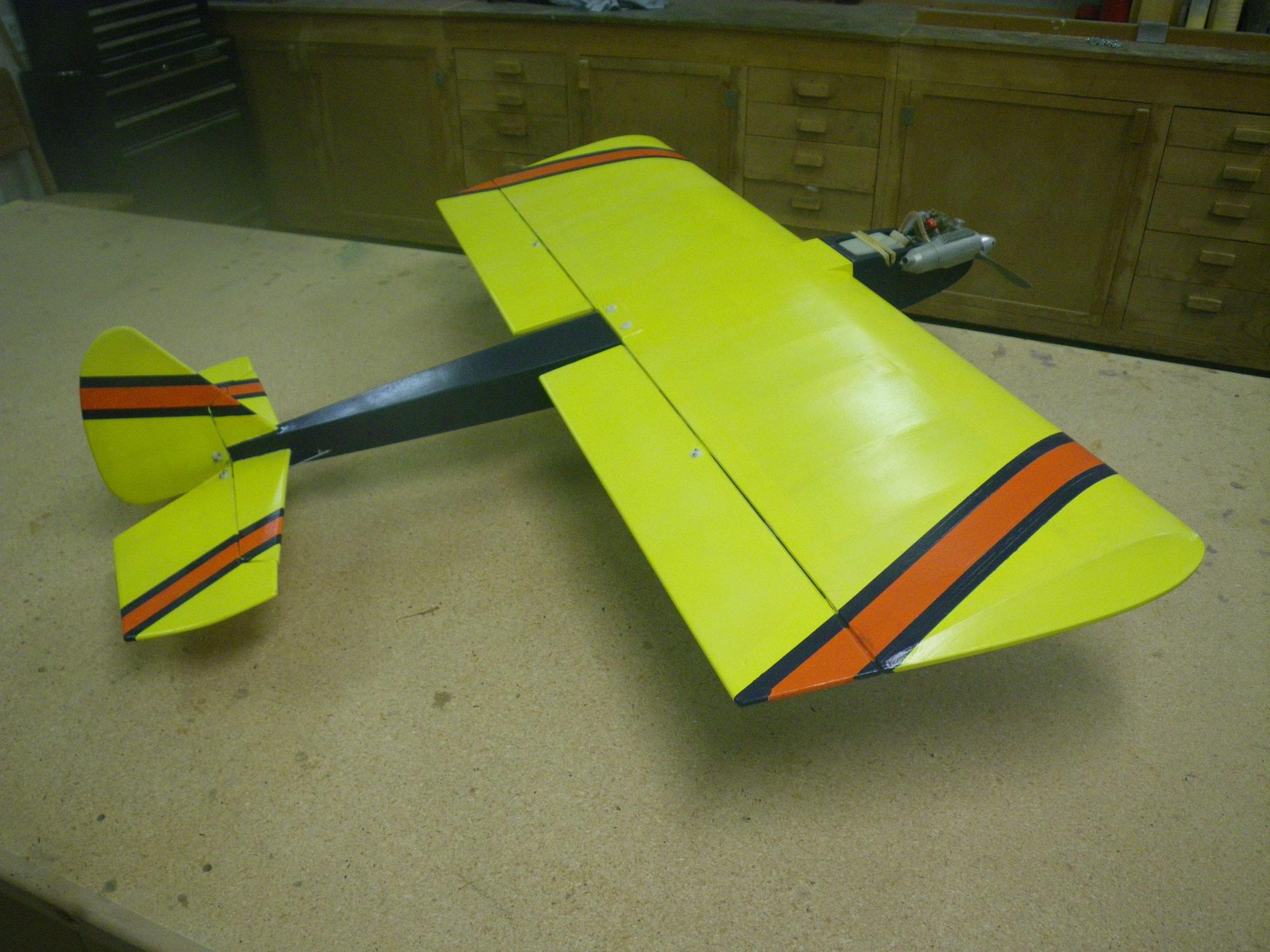

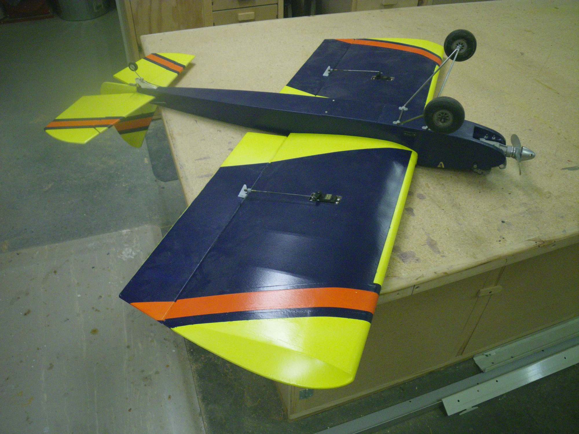

Just finished a Florio Flyers Stuntwagon. Old school Kit from 1991. It has the recommended OS .32 SX in it. Covering is doculam over open areas, silkspan over everything, paint and catalyzed clear polyurethane for fuel proofing. Maiden flight to come soon.

I was just getting in the hobby when this kit was popular.. I have been using the doculam as well.. Nice finish..

Speed is not the goal for that plane. The thick airfoil and large control surfaces are for stunts at low speeds. This also allows for slow takeoffs and landings. A 10x4 prop is an excellent start.
I wish you were local so I could assist in the test flight.
