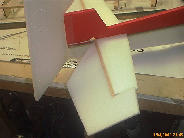

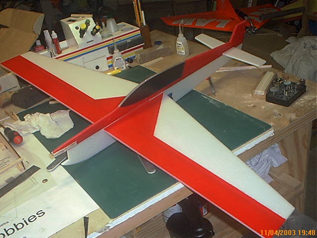

I started my flat edge last night.... 6 mil Depron... CF tubes are epoxied into the fuse and wing..
Here's what I'm going to use so far:
GWS 350c dx D Gear Motor
12-6 E prop
1 HS 55 servo
2 HS 50 servos
FMA RX
3 cell LiPo's 1200 mAh

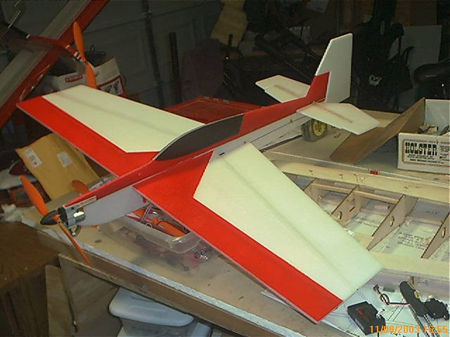

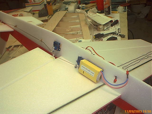

Boy this thing is a trip!!! What a blast!! Finally got her finished today and did a little flying around the neighborhood....
My flight times were somewhere around 20 minutes!!
Torque rolled her on the first flight... Did a cool rolling harrier... and harriered pretty good tool.. Might wanna dial in a little more elevator... but for now it's pretty cool..
Gotta love torque rolling in my front yard!!!
Here's my setup:
1 HS-55
2 HS-50
1 FMA-5 FX
1 GWS 350 D motor
1 GWS 1047 prop
1 Castle Creations 20P Esc
1 1200 mAh 3 cell LiPolly

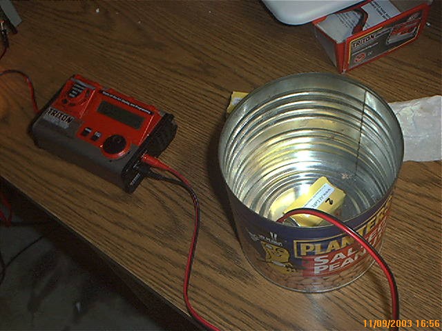

Any reason why you charge the battery in a tin can?
Old 11-09-2003 | 08:36 PM
PaulSwany's Avatar
My Feedback: (45)
Posts: 4,811
From: Bartlett, TN
Default RE: Flight Report
You gotta be real carefull with LiPolly's. Best to keep them contained incase anything bad happens.... LiPolly's are to be respected... If you inadvertently overcharge them... they will explode and spue their hot contents all over the place... Could cause a fire..
That's why I charge them in a can...
