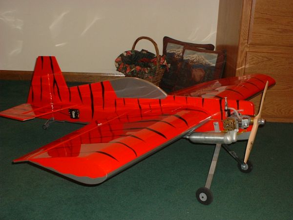

K&B screaming .48 & a Ultrathrust muffler turn mine into a real tiger...
