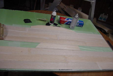

On the sheeting I used Gluit white glue. I stuck my sheeting down on wax paper using a spray glue. It releases when you are done. I cut the sheets as per instructions and I used left over wood from my scrap box for the canopy so I wouldnt have another seem there.

I also made my sheeting so that the seems would be opposite each other on each side of the fuse.

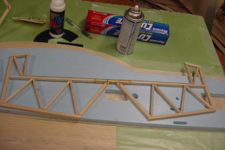

The stab and Ele. were very simple to build. I found that the wood was pretty good although some of it was hard. It worked out great though because I used the hardest wood for the LE on my moving surfaces.

You may notice that I havent glued in my corner braces yet. Im not over looking it I just havent done it yet.

I must have got one of the first kits out because I didnt have the ele joining wire. I really dont like to use wire on my ele. I like the hardwood setup myself. It just seem to be stiffer in the center than the wire. I always sheet the area over the glue joints.
Old 02-07-2004 | 08:05 AM
Posts: 1,280
From: conway, NC
Default RE: OMP Yak build
I also enlarged the ele. by 3/8 on the TE.

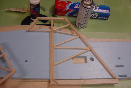

The rudder went together as easily as the rest. As you can easily see I enlarged the rudder pretty good. Dont ask......I just like a RUDDER.

The corner blocks are not glued in the rudder either. It looks strange without em.

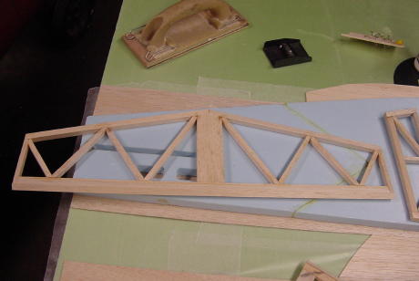

The ailerons are built as per plans.

John I am looking to see more. I am going to build the 60 Yak OMP size when I get the bird off the table I am working on . You sad you sheet jointed areas can you explane I could not tell from pic how much you sheet for support?. Thanks for your time and pics giving a report on your build. Keep up the good work. I will be looking Steve
Old 02-07-2004 | 02:35 PM
Posts: 1,280
From: conway, NC
The entire fuse is sheeted with 1/16 balsa sheets. I did as the instructions suggested because I thought that would be the best way as well.. The instructions said to cut 4, 36'' sheets into 24'' and 12'' sheets. Or in other words cut 12'' off of one end. Then you have made eight 24'' sheets and eight 12'' sheets from the four 36'' sheets. These sheets, plus the remaining four 36'' sheets are glued together to from the fuse sheeting for both sides of the fuse. If you'll look close in the sheeting picture youll see that there are three seams. The botton sheet has a seam on the right. That is a 24'' sheet and a 12'' sheet on the right of it. The center sheet is two 36'' sheets together with a seam in the middle. The top is a 12'' sheet on the left and a 24'' sheet on the right. The sheeting for the other side of the fuse is opposite of this because I didnt want to have the same seam on both sides at the same place. Just seems to be reasonable to me for strength.

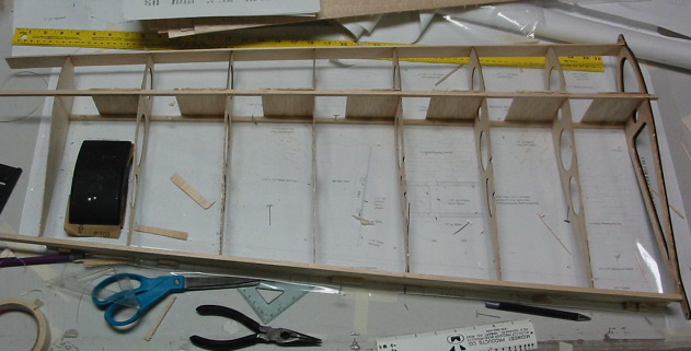

Here is what I have done on my right wing.
It went together well.
In 1 weeks time
I have the fuselage, almost done,
horizontal stab and elevator done, except for the joiner wire
Vertical stab and rudder complete,
and this much on the right wing.
I lost almost a 1/2 hour trying to fiqure something out that was in the instructions. that I new I read, but I couldn't find it again. but after I figured it out, I saw it in the instructions.
on the right wing, rib-R1, the tab that bolts to fuselage points UP. (Thats the part it took me a little while to figure out.) Then your servo rails in your wing rib are facing up.
On the left wing, when you build it, the rib-R1 the tab that bolts to the fuse points DOWN. then the servo rails in our wing rib are facing down
