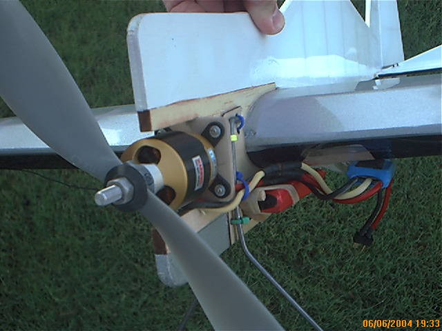

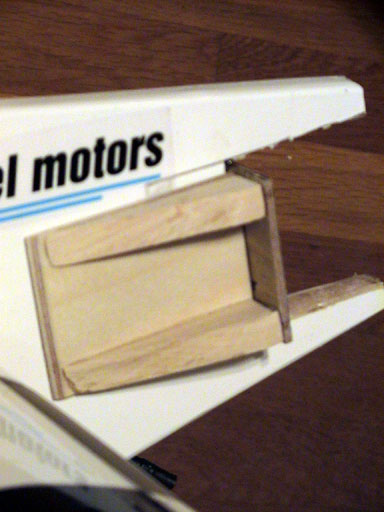

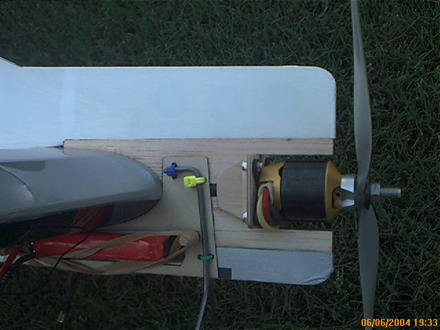

I have an interesting new hobby, it's trying to convert 5 pound glow profiles to electric. I'm on profile number two right now. I have been taking pictures so I thought I would show how I made a mount for my BL motor. It's not that hard and so far it has held up on 2 really torquey motors. This was my first attempt. The second one looks a lot nicer.
I have had to cut the "mouth" of the motor mount on both of the profiles I have converted.
Then I took some nice hardwood and made 4 pieces of triangle stock.
I have a piece of ply under the triangle stock. This might be over kill but I thought it would need it.
Then I put ply on the front. I even angled the triangle stock for some right thrust.
I had to drill a hole in the ply for the shaft to go through.
I covered everything.
I mounted my AXI.
And that's it.

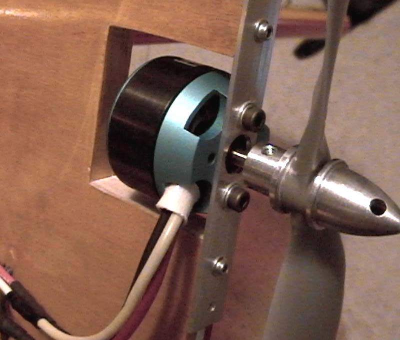

this is still in the x phase of defelopment hovers at 1/2 not pushing anything axi2808-24, 3s1p, 2100 TP lipo, C.C. 35amp, AUW 22oz
im lovin it, made it for a freind he got me a motor and esc for doing it, same as above,
here is a different way of mounting. i could take a close pic if anybody needs it for the motor mount, its just a 1/2" x 1/16" aluminum strap drilled for the motor bolts and screwed into plywood blocks in the nose.

thanks guys here is a close pic for the visual learners, there is another hole for another screw in the bottom end of it but it isnt needed, its allot stiffer than it looks or than i though it would be. and i like that the aluminum acts like alittle more heat sink, right thrust is done by sanding it into the nose before covering. I was going to do like Billy did but was to cheap to get the mounting hardware, the advantage i see to billy's is that in a crash you will maybe only bent the hardware and hopefully not the motor shaft
oh, and the plane is close to taco size 36" ws and 38"length. and that is a 10x3.8apc which sounds small but i wanted to get a full season out of the lipo.

Here's how we did the E Taco.
