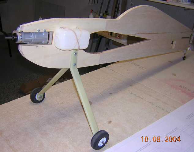

OK, time for some serious airplane noises! Nothing like getting an airplane on it's gear for the first time. My kit has the "teatherite" gear which needs to be drilled to accomodate the 6-32 mounting bolts and 5/32" axles. The gear looks good - plenty of ground clearance for swinging those big props, huh?
I will be using my tried and true .46 FX. This is the third airframe for this engine and it runs great. Mounting hardware is 6-32 cap screws at 1 1/4" long.
The wheels are from my UcanDo3D .46 kit, and I have installed a Sullivan tailwheel bracket and 1" Sullivan tail wheel. I invested in quality tailwheel hardware because I intend to drag the tail in on every landing
Say...where did you guys find an 8-oz tank that will fit between the wing and the fuse cut-out? The only one that I could find that fit was the 6-oz Sullivan shown in the photo.

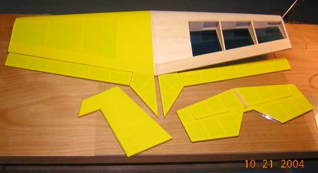

I am at the point in the project where an evening of work doesn't really show up in pictures. I drilled the control horn mounting holes, elevator and rudder servos were fitted and pilot holes drilled, and all control surface hinge slots were cut. I will be using CA type hinges.
Here are some shots of the hinged surfaces:
JC
JC

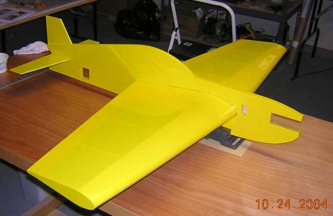

Things are starting to take shape on the KatanaP. I epoxied the wing and stab in place last night. This part of the assembly was an area of concern since starting the project. It turned out to be quite easy. During covering I left a 1/2" center strip on the wing and stab un-covered by film. This would ensure a strong joint.
The fuse was place in a flat vise and level such that it was exactly perpendicular with the building board. I then fit the wing in and moved it around until it was centered and perpendicular to the fuse. I then used a level to ensure that the wing was parallel to the building board. The top of the wing is flat so it gives a good surface to level.
When everything looked good, I made some alignment marks with a pen, applied epoxy, and slipped the wing in. I used the alignment marks to get the wing in position. Excess epoxy was wiped away with pre-prepared cloth wipes dampened with denatured alcohol. Wing alignment was triple checked and allowed to cure. Same process with the stab, using an triangle to ensure that trailing edge was square to fuse. Hey, flat fuselages have their advantages when it comes time to square things up
I took a lot of time to make sure that this airplane is as true as I can get it. I learned from my experience with my UcanDo that alignment and surface deflection are critical to 3D airplanes.
Here is how it looks now. The distinctive Katana wing fillets are to be added next.

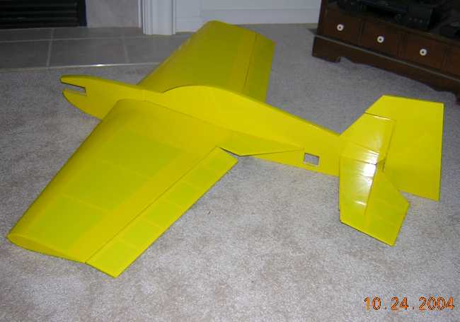

This is going to be it for a few days. I will be occupied with work for a while[:@].
The fillets have been added to wing/fuse with epoxy. I cut away the film at the glue joint locations for a wood to wood bond.
Hinge slots have been re-opened and the surfaces trial fitted. Next step is hinging.
