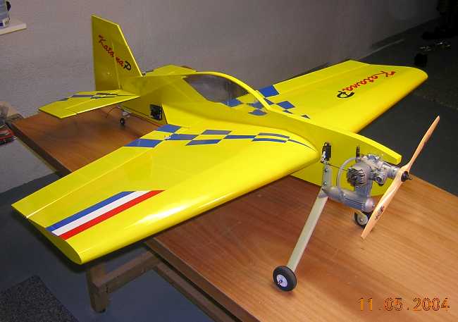

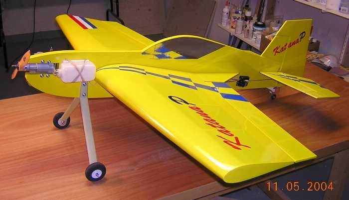

Hello all,
Here are a few pics of the completed trim scheme. Next step is radio and engine installation. Should be a snap since I took the time to drill all the holes before covering.
All trim cut from Monokote or Ultracote. I made good use of the scrap box for this scheme. Instead of the three Italian colors, I chose the good 'ole red, white, and blue. This is a kit made in the USA after all!
JC
JC

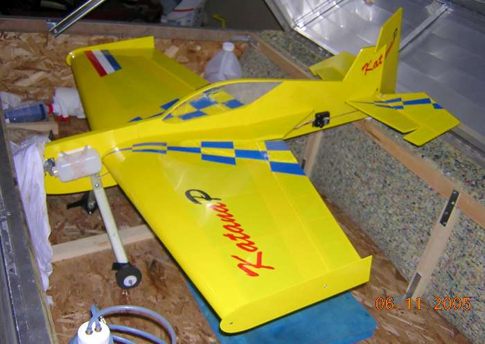

Wahoooooo!
The "Kat" is done! Just a little over a month of part-time and pleasant work. The all up weight is 4 lbs. 5 ounces.
Summary:
1. Well designed, engineered, and cut kit.
2. Fun build
3. Only one area of construction confused me - the bottom spars. Bend them, don't cut them!
4. All-up-weight is almost exactly what was claimed on website.
5. Wood selection in kit is excellent, however I came up short on some 1/16" sheeting (no big deal).
6. Well supported by OMP here on this forum.
7. Electronic manual on CD-ROM can be blown up and printed in color if you wish. Instructions were very good.
8. I found that I only needed the bottom hatch in the left wing (opposite the cylinder) where I put the RX and battery. Your choice, but it will save some time to only build one hatch.
