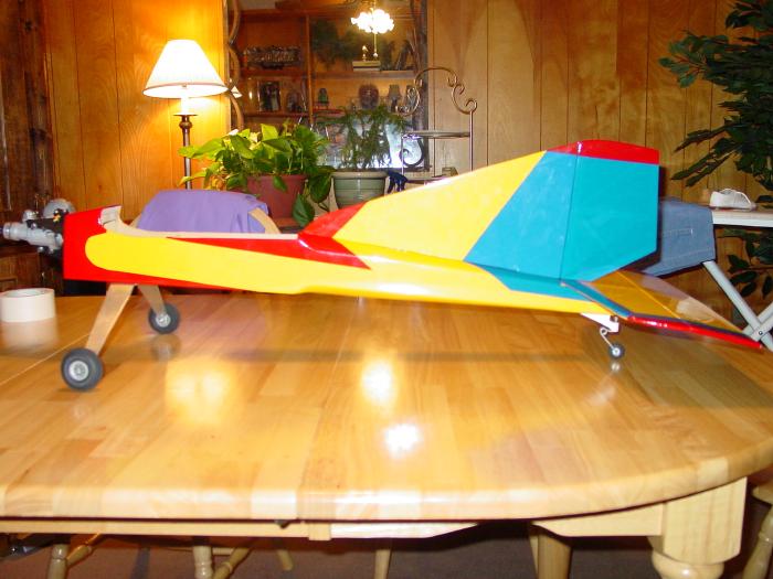

Modified Magic, What will this do????
Posts: 251
From: Cleveland,
MS
This is magic #3...
I had way to much fun with the first two. Did some things I should not have done. Now I am putting together #3 and decided to try something a little different.
Hope to finish it for this weekend. What do ya'll think I should expect?

I am building my first one, pretty much as originally designed.
noticed you added a tail wheel. is that stearable or a castor?
How about the front gear? did you try this gear on either of the the first two? I'm not so sure about the gear they give you. Why so high?
what are you using for power?

shmo46
The tail whell is stearable. I fly off grass and I am hopeing to make this easier.
The front gear went on the first one after the second stock gear broke. The stock gear never made it on the second one. I have know idea why it is so high.
46fx for power.

shmo46
On the landing gear they supply with the Magic.
Wrap the joint next to the wheels with non-waxed dental floss and then coat with epoxy. This will help the stock gear survive a little longer. The landing gear on this airplane is its weak spot.

My closest guess is to allow you to swing a bigger prop. If your motor can handle it, you can put some large diameter props with the ground clearance you get from the landing gear.

the high UC lowers the landing and take off speed......
comming in you have a high AoA and no speed, it touches wheels first, if the UC was short you would touch the tail first. ( ugly landing )
taking off the high AoA gets lift quicker. ever notice how a Magic is always the first plane to take off from your flight box and blow over when a gust comes.
the rudder has less effective % of area compaired to the last... expect it to track straight and you might loose the flat spins, the hang should be better.

I think there are several reasons for the long gear. You get no ground effect on the wing to hold it down to the ground. That allows faster liftoffs, and smoother touchdowns. You also increase your AoA as philly said, youre already rotated before the tail comes up. The tall gear lets you turn a mammoth prop (someones gonna get a wild hair up thier *ss and put a saito 100 on one and turn a 16 inch prop, its just a matter of time
). It also gives that prop some protection in the event of a hard landing (ie: falling out of a hover/tr at 4 ft off the deck and ploppin it straight ahead on the gear----ask me how I know about that one). The gear mushed itself outward, and absorbed all the energy of the impact. All I had to do was pick it up, wipe the clay off the prop, and restart. We had one idea at the field that it also counterbalanced some weight outbound to negate pitching toward the canopy in a hover, but we stole that guys pocket protector,gave him a wedgie, snapped his suspenders, and sent him home. LOL JK
The last advantage the large stork gear has, is that it trains you for when you have a giant scale plane. After landing your magic, you can go out on the runway, grab it by the tail skid, and drag it backwards, just like the giant scale guys do.
that never fails to get a laff on the flightline.
). It also gives that prop some protection in the event of a hard landing (ie: falling out of a hover/tr at 4 ft off the deck and ploppin it straight ahead on the gear----ask me how I know about that one). The gear mushed itself outward, and absorbed all the energy of the impact. All I had to do was pick it up, wipe the clay off the prop, and restart. We had one idea at the field that it also counterbalanced some weight outbound to negate pitching toward the canopy in a hover, but we stole that guys pocket protector,gave him a wedgie, snapped his suspenders, and sent him home. LOL JKThe last advantage the large stork gear has, is that it trains you for when you have a giant scale plane. After landing your magic, you can go out on the runway, grab it by the tail skid, and drag it backwards, just like the giant scale guys do.
It appears you have greatly enlarged the vertical fin area.
While there is no down side for enlarging the horizontal tail area, the vertical area should be kept between certain limits. Too small and you get into yaw instability. Too large and the plane gets into spiral instability. The normal size of the total vertical area is from 1/3 to 1/2 the horizontal area. ( Horz area normally 20%-25% of wing area)
What happens in spiral instability is the plane tends to tighten up a turn or spiral. When you roll into a bank and pull back, the angle of bank will tend to increase as you go around the turn. In a diving spiral, the spiral will tighten up and you probably not be able to pull the nose up until you roll out of the bank.
You probably recall flying a friend's trainer that tries to roll out of the bank during the turn and you have to "touch up" the aileron as you go around. Same thing here except you touch some top aileron to roll out a little during the turn.
It's nothing violent and I have encountered it before in a couple of my designs. It's just not a comfortable way to fly. It would be nice to know if you do encounter spiral instability.

So far so good!
I lost the inverted flat spin the other two did so well. Upright its fine. Did not notice any other negative changes in flying characteristics. No spiral instability I can see. It did slow the roll rate just a little. Knife edge may be possible now, but it will need major coupling with ailerons and elevator to straighten it out. Gotta practice that one. Hovers much better. The rudder actually works!!!!
I think its a keeper! Don't know for how long though, dumped it once hanging on the prop from just a few feet. Just a little dent in the fuse. Latch66 insist that I repair it, but I think it adds character to an already interesting looking bird.

Nothing I have noticed yet, I was just playing around today. Doing all the stuff I could do with the other two. It flew just like the other two other than the loss of the inverted flat spin and the more stable hover with a more responsive rudder.
Next weekend I hope to practice a little more knife edging and flat circle kinda stuff. I'll post how that turns out.
