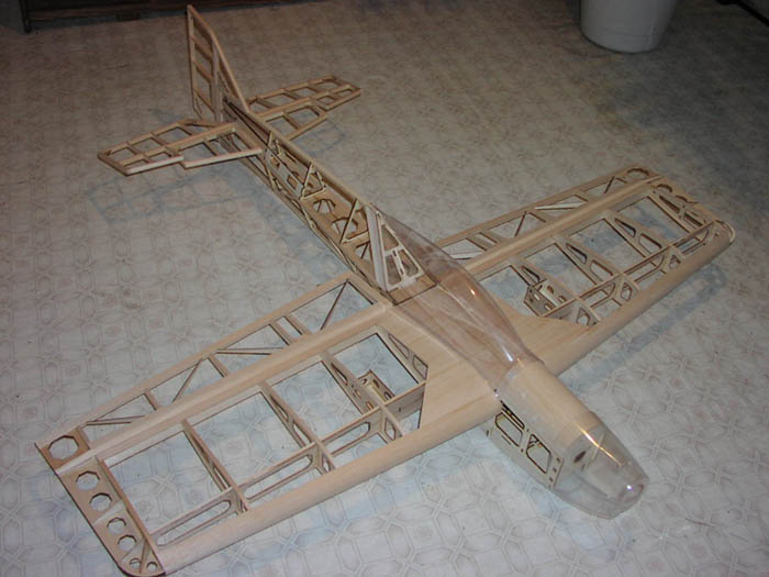

I am putting together a Seduction Wild-Style and thought you guys might like to see some pics and what I think of it.
It is all framed up, and building it has been extremely fun! All of the laser cutting is excellent, but I would almost want a little more wood holding the pieces in the frame, because the pieces were literately falling out when I picked up the laser cut stock.
Assembly was very unique, and sort of like putting one of those 3d puzzles together at times. Everything interlocks with everything else. The larger pieces on the frame of the tail were even pre-cut. Assembly was very quick, and very enjoyable.
It is so pretty, I am going to have to cover this in a clear covering, which makes me resort to monokote, I like ultracote better, but their clear isn't as clear as monokotes.
Weight as seen in the pic is 1lb 5oz.
Engine will be os 50-sx. Servos: JR 3121's in the airlerons, and DS811's for the tail.
I will post more pics when I am further along.

Old 08-19-2002 | 01:29 AM

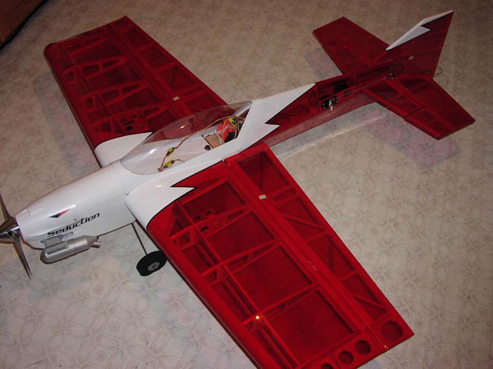

Old 09-05-2002 | 02:10 AM
KevinS's Avatar
Posts: 94
From: Bellingham, MA
Default Seduction WildStyle
Here is the pic of the final plane. It's nose heavy right now, working on how to correct it without adding weight if I can. I did end up covering it in ultracote clear red, and it is very clear. Very nice stuff. Weight comes to 3lbs 14oz. Hope to be flying it very soon. Powered by an OS 50SX. JR DS811's on the tail and JR 3121's on the airlerons. Hitec 225BB on the throttle.
Kevin S.
Old 09-05-2002 | 02:27 AM

I've only tried the Yellow... But I'm about to try some of the red... I need to rebuild a wing for my Pizazz and it uses red ultracote... I'll let you know how it goes.
Old 09-05-2002 | 01:41 PM
Posts: 458
From: Pensacola, FL
Default Ultracoat Transparents
I used red ultracote on my Seduction FS, looks great and it is very clear. The only complaint I have is that it was difficult to cut. Even with new blades. I use one of those Harry Higely trim tools and it would not cut it consistently like regular ultracoat (strange). Did anyone else have the same problem?

Old 09-05-2002 | 02:12 PM
PaulSwany's Avatar
My Feedback: (45)
Posts: 4,811
From: Bartlett, TN
Default Re: Ultracoat Transparents
Jon
I've always had a hard time cutting ultracote... But I've found that if you let it cool it cuts easier... I also use straight razor blades instead of #11's. They are just a little sharper.

Chuck
