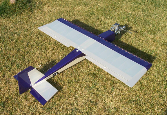

Well, after a long time flying electric airplanes, I decided to get another glow powered airplane. I found some plans on the internet for the original Das Ugly Stick (.60 size). I resized them to a 48" wing span and changed the tail feathers slightly. I'm using a Saito FA-40A four stroke (great engine by the way!). Here's the specs:
Wing Span: 48"
Wing area: 498 sq. in.
Weight: 3.8 lbs.
Motor: Saito FA-40A
Servos: HS-81 MG (5)
Battery: 4.8V 1400 NiMH
Receiver: Hitec Supreme 8
Today was the maiden flight. This thing goes straight up! I made an oversized rudder and elevator, so it should be pretty 3D capable, now I just need to learn 3d
On a 10 oz. tank I'm getting 20 minute flights with fuel left over. I really like the Saito engine, this is my first 4-stroke. It is much nicer sounding than 2-stroke engines and is extremely fuel efficient.
Here are a few pictures. It is covered in Monokote metallic plum and pearl white, looks better in person

Wayne, I think you can download .dxf viewers for free. I use Adobe Illustrator to resize and print the plans.
I've flown it more today. This plane does snap rolls extremely well. I had to couple ailerons to the rudder so that it doesn't roll when rudder is used, I'll try to see if it can knife edge tomorrow (don't think it will K.E. good though since the fuse is so small). I have dual aileron servos, so I dialed in some flaps for landing and slow flying. It can now fly and land at about walking pace with 50% flaps in the down position. I'm really starting to like this plane
