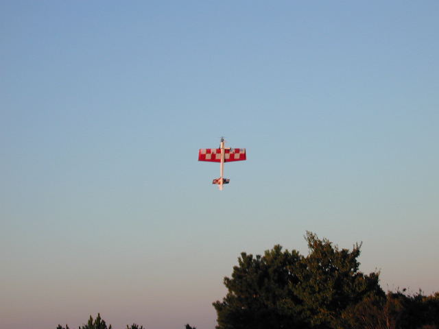

My Feedback: (12)
Posts: 475
From: Patchogue, NY
Default U can
Os 91 fs with 15*6 apc!

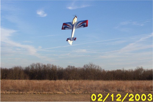

Old 02-28-2003 | 03:24 AM
My Feedback: (19)
Posts: 1,877
Received 15 Likes on 15 Posts
From: Eldon, MO
Default GP U Can Do 3D
ST 90, APC 15x4w.
Old Futaba S-131S on ailerons and rudder, S-131SH on elevators. 5 cell pack for more power and speed.
