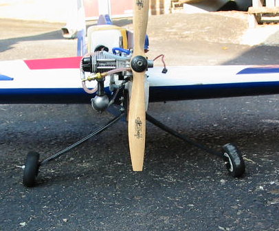

Old 09-05-2002 | 01:47 AM
bgi
My Feedback: (7)
Posts: 907
From: Duluth, GA
Default Lift-off with no flaps?
Paul,
This is the ARF. If I replace this with another Knife, I'll probably get the kit. It would be much easier to get the servos installed with a kit. Now that I've built the ARF once, I "get it", but installing the servo rails to be removable while lining the servos up with the covers was a major PITA! A Kit will give me a chance to use a more visible scheme, as well. The ARF isn't bad, but if the sun is in your face, it can be tough to tell up from down.
Gator,
You said it! I'm building a couple scale planes, a 4-star 60, and a big Edge. But I'm a profile fun-fly maniac now!
David,
About the Knife lift-off problems:
I was using low rates per the manual.
Engine: TT .46 Pro with standard muffler
Prop: APC 12.25x3.75 fun fly
Fuel: 10/18 synthetic with 2% castor added (really 10/20)
95 degrees (hot)
The engine has about 2 tanks through it and so wasn't quite leaned out.
This engine/prop combo will climb out of a hover.
I did a 10 or 20 foot roll before trying to lift up. I gave it FULL UP with 30% flap mix and it barely lifted off. It was pretty anemic about it. With that prop, it accelerates very quickly!
After that flight, one of our best pilots explained to me that it wouldn't lift off without flap mix unless I bent the landing gear in to raise the nose. He ran one down a 300 foot asphault runway (no flap mix) and it would NOT take off! Other folks in our club who fly Su-do-khois have the LG pressed in so that the wheels are barely separated. Perhaps they didn't mix flaps in, either?
Obviously your experience is different. What's the trick? Is your tail wheel holding your plane's tail up as high as mine is? When mine sits on the LG, it has a shallow AOA. Tell me about your take-offs. What's the AOA with it sitting on the ground?

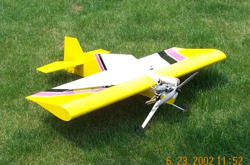

Old 09-05-2002 | 04:29 PM
m.gramling's Avatar
My Feedback: (8)
Posts: 1,788
From: Atoka, TN
Default Praise the Knife!
Just for referance, My krazy legs (the heavy duty) give me a lot of ground clearance..
this a 14" prop on my top cap arf. I am flying it with a YS 63

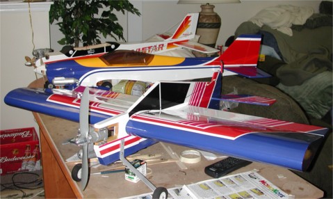

Old 09-05-2002 | 04:33 PM
m.gramling's Avatar
My Feedback: (8)
Posts: 1,788
From: Atoka, TN
Here is is w/ a brand new set of Dubro blacks.
Needsless to say. the dubro blacks stayed on te airplane 1 flight.
As for the Krazy legs, I have beat them todeath and they keep coming back for more.

Old 09-12-2002 | 12:35 AM
bgi
My Feedback: (7)
Posts: 907
From: Duluth, GA
Default How to fix fuel draw on the Knife?
Now that I've showered my new toy with praises, I'm trying to solve a fuel draw problem. If you scroll back a little, you will see a photo I posted of the Knife sitting in front of my Aresti and Avistar. Note that the TT .46 Pro is all the way forward on the rails. Also note that there is no fuel tank visible (it's in the wing!) Because of this, the engine has a long way to draw fuel.
Since taking that photo, I've attached a Macs muffler (the small semi-tuned pipe). I've become better at hovering, but the engine doesn't like the pipe and the long fuel draw. It has a problem leaning out during a hover. To solve this, I put a 4oz header tank between the engine and the wing. While I'm not convinced this is the real answer because I believe that the fuel is still ultimately coming from the wing tank, folks tell me this will solve the problem.
This introduced a new problem - the header tank foams badly even though it has a nice layer of foam surrounding it.
So, what's the expert concensus:
1) Use more foam on the header tank?
2) Ditch the wing tank and use an 8-10 oz external tank (with enough foam, of course!)?
Inquiring minds want to know! Gotta solve my fuel draw problem!
-brad
